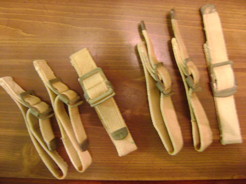

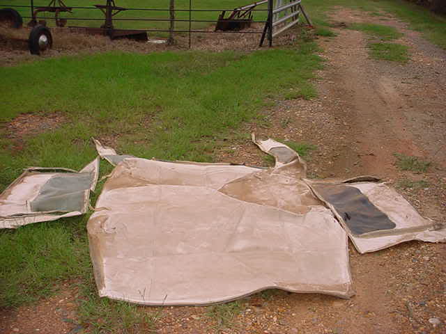

Thinking these are OEM? From a 5 window Vinyl top.....
(JohnnyC - the top I sent you a pic of)
Were they strapped like the three on the left or the three on the right.....?.....or does it matter......I have to think there is a "correct" way......
I'm getting buckles and web tips like these.....I like the strap material too....still looking for the most perfect substitute for the webbing material....

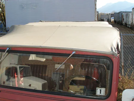

1st pic is my truck for a clear pic of the webbing....looped back in

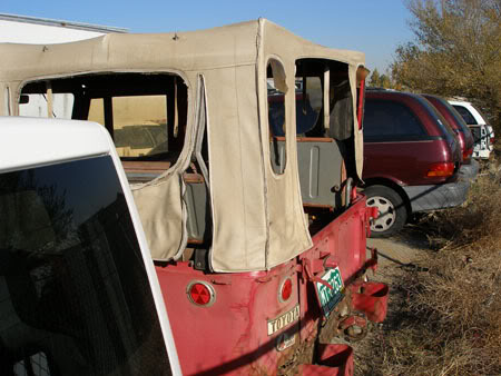

2nd pic is FJnotCJ's truck oem canvas....looped back in
3rd pic is the copy of that top...made by badger coach works....mike fox's truck....not looped back in
most every oem top i have seen ...they are all 2 seamers...this i think is also oem it's the only one....maybe another, i'll have to check that i have on record as being a one seam top...i am 99% sure its an oem top...as everything else points to it being oem.
when toyota went vinyl they were no longer "in house" to making tops...thats why there is quite a diverse style the later you go in years....and in region
land cruisers were shipped with fst's tops broken down and assembled at port.

the straps on quite a few oem vinyl tops were located under the vinyl....not on the exterior of the vinyl.
but....i do not see any straps dangling under :hhmm: your making me question this one now...it could be one of those early kayline made replacement tops you would be able to buy thru toyota.

They are cinch locking tooth buckles ... Most common were the double tooth
Can get them from ahh.biz or national webbing
Most places carry the nickle plated steel ones... You can get SS for more money... It's hard to find in black ... But believe ODcloth or beach wood had/has them
