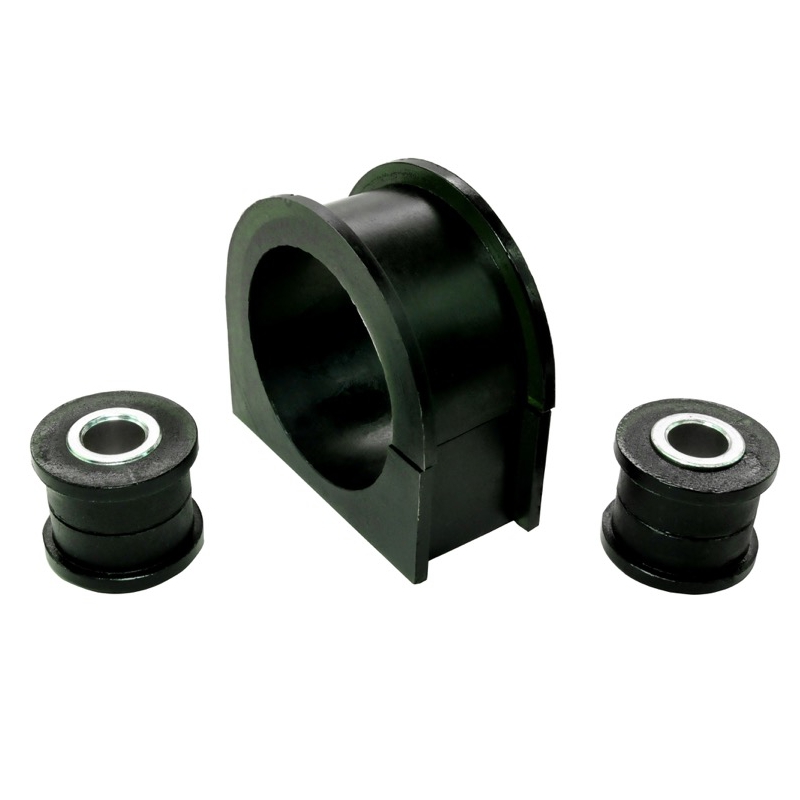

At 214K miles, it's not a surprise the Rack looks loose due to soft bushing.
I was planning on just picking up rubber OEM's bushings from Dealer, but they only carry the "D" bushing.
I like the idea of going with rubber as design by Mr. T., thinking it helps reduce shock/vibration to the steering Rack. But is stiffer a better approach to keeping the rack in good health?
Either way I need to pick up some bushing, and would like opinion on which one's are best (type & brand)?
I ended up going over to Slee Off Road, where Christo helped me out. They have a prepackaged set of bushing not yet displayed on there web page, for $49. I didn't bother to ask what brand, other than it's poly. If Slee offers them, that's good enough for me.
I'm cautiously hopeful the stiffer poly will not hasten the need to replace steering rack. Anyone have opinion on this????????

No opinion, I only have experience with beat factory bushings and white lines replacement. I'd find it hard to believe poly would cause the r&p to age faster.

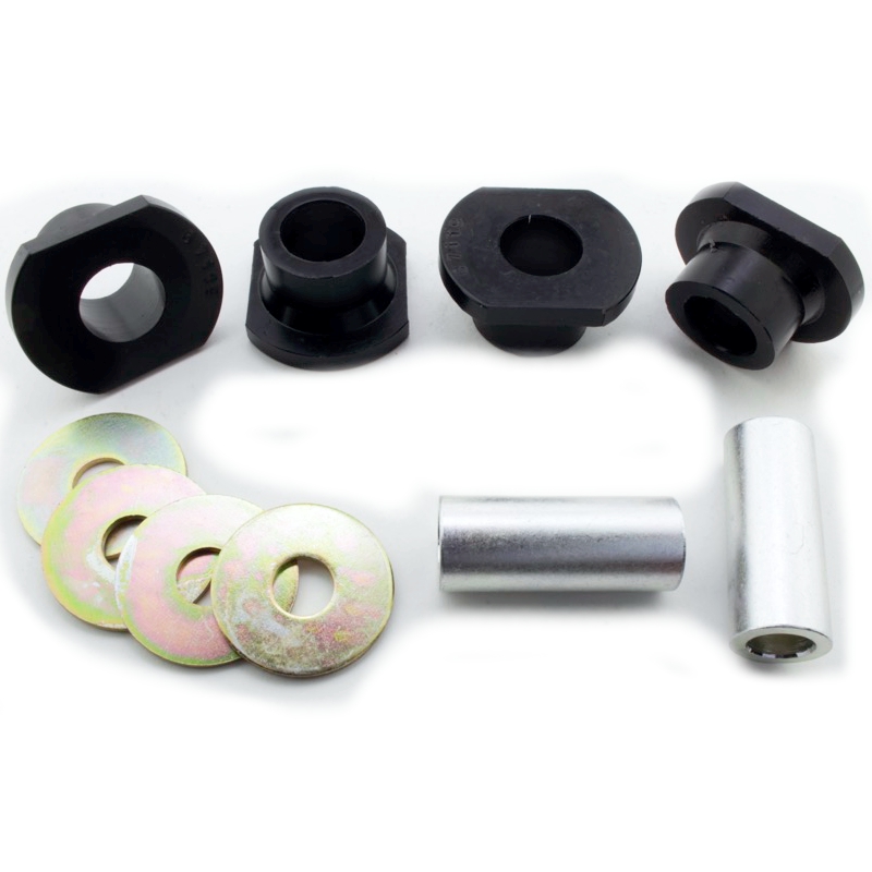

Yes. Dealer only sell the larger D or horse shoe shaped bushing in rubber. The four small bushing half's are pressed in, and only offered with Steering rack.

I'm unclear of where included package of lube is applied?
I also questioned the grease application. Whiteline didn't include it in their instruction, but has the following on their website:
"Supplied grease should only be applied to the bores and outer flanges of all bushes and components - do not grease the outside surfaces of bushes and components."
I can't say I did a good job of keeping it off the outside surfaces.
I'll give Slee a call just before I install. I get the bore that steel bushing goes through. Assume not not the "D".

They say poly last forever. But they are noticeably stiffer, do not allow for rack side to side movement as rubbers OEs do, and some report the squeak.
Rubber is what factory uses and reduce shock to system.
One report in mud, stated the OE rubbers failed. But were they good quality, installed properly and keep dry of oil leaks soaking them constantly.
