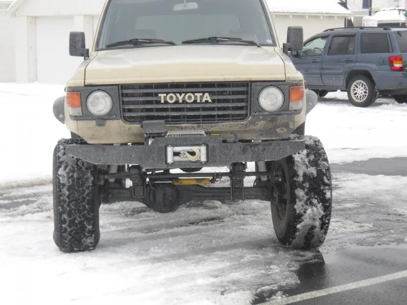

Is it ok if I reply more than a year after the fact? (Doh!) Yes, that pic was a stock Cruiser front with 1.5" spacers and 10" rims supporting my 35" tires. Since that time, I built a custon front housing (plus 6") with Bobby Long custom shafts and 30-spline Longfields. I do not use spacers with that. Below is a pic of it's maiden voyage (in the wretched snow).

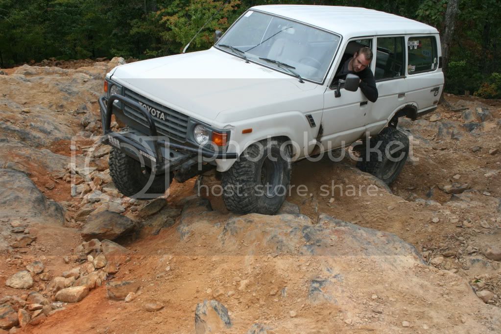

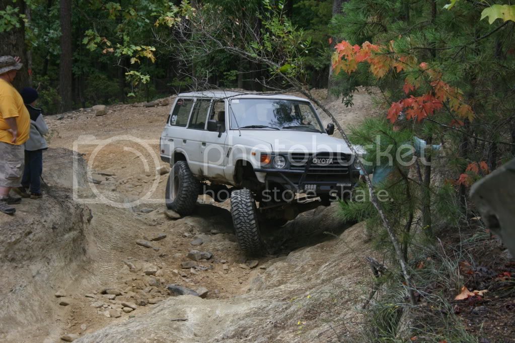

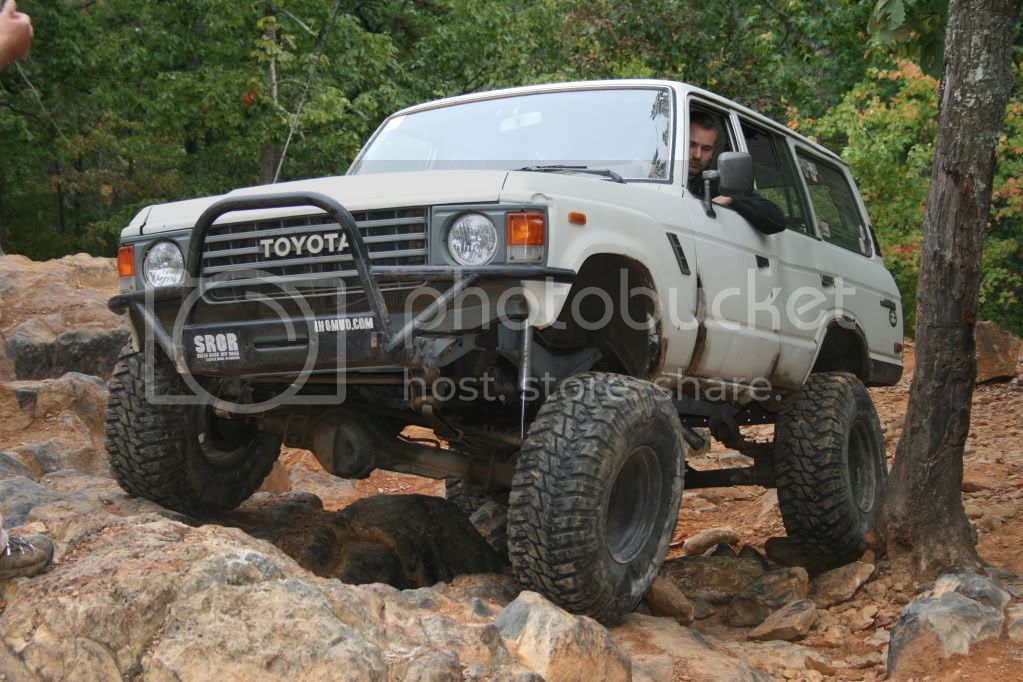

Pics as promised. Stock 60 leafs up front, ironman springs out back. Rear springs need a few more leaves removed to flex as well as they should, but the front works pretty well as is.
nice flex .. but yes it looks like you are flexing more in front than rear ..
Definitely. I'm planning on taking more leaves out of the packs to get it to both sit lower and flex more. It is way too stiff right now.
GLTHFJ60 nice flex! the rig is looking good!
