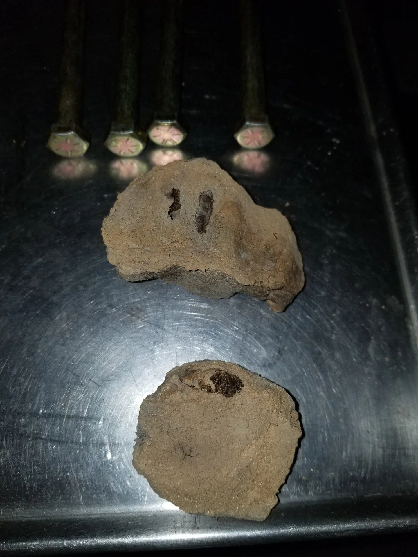

Pic test ... my Cruiser is full of wasp nests. This is like the 5th one I've found.
Pics are still small ... :poop:
