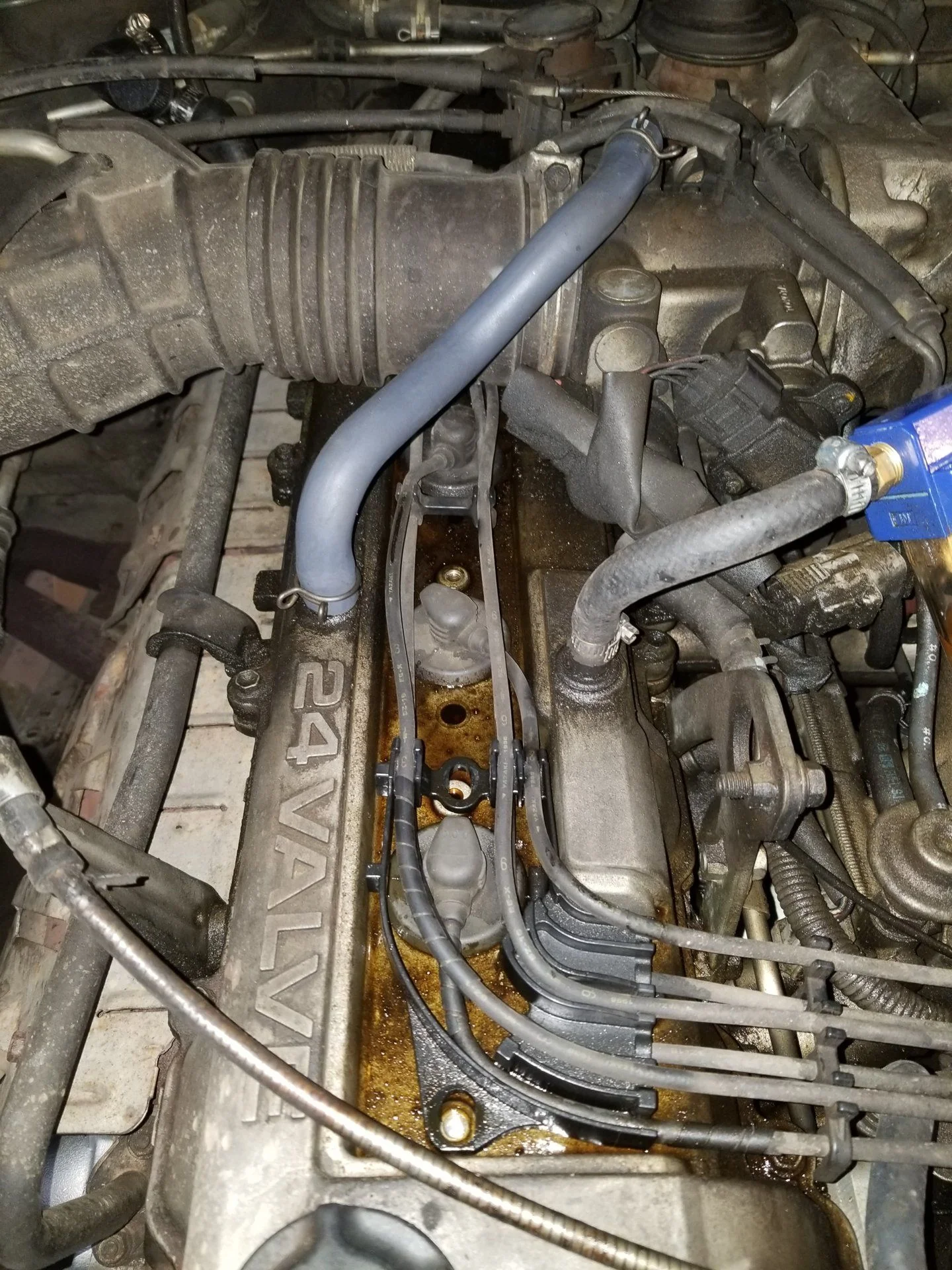

Think I found yet another pressing project ...
Was seeing some seep from the spark plug valley. Pulled the cover and found a little river. Maybe lost a plug seal?

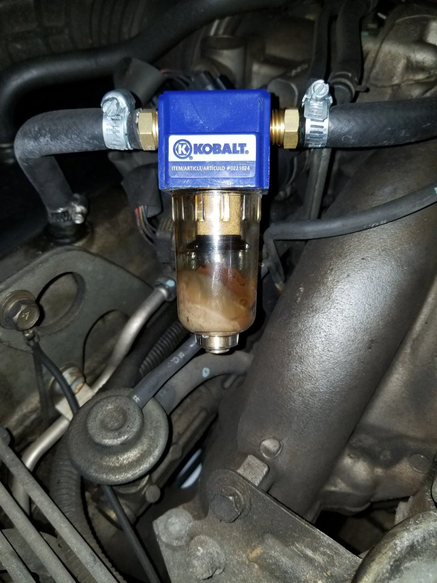

catch can ...
If that filter somehow impedes flow of pressure it could easily allow the oil to push out of the gaskets. I’ve seen it happen before, and that’s why I rarely advise use of catch cans. Also could be a rolled gasket as I’ve made that mistake before as well.
