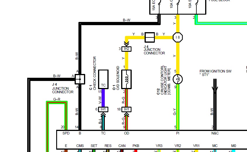

Below is a clip from the FSM.
Jon, the O/D solenoid is on the driver side of the tranny, towards the transfer case. It's a 3-prong plug on a pigtail. The CC ECU controls OD (pin 9) by grounding the solenoid at the ECU.
Check out the Cruise Control section in the FSM, Body Electrical pg. 67-70

Not really possible, here is the wiring. Are you sure your cruise ecu is disconnected? Why would you disconnect it, and where did you disconnect it, as in where is the ECU located?
Maybe that's where I'm not very clear...I have gotten rid of the main ECU and the associated wiring in the looms that were not being used. I also at one point had the Cruise Control module out of the truck. If there is another ECU for the CC that's separate from the EFI stuff, then no, I didn't fiddle with that or even find it. Maybe I'll just look through my FSM later after work to make sure I'm using the right terms to avoid further confusion.

The cruise control is located no where near the ECU for the motor. It is mounted near the steering column.
Thanks...forget everything I said then...I didn't tamper with the CC ECU. :doh:
