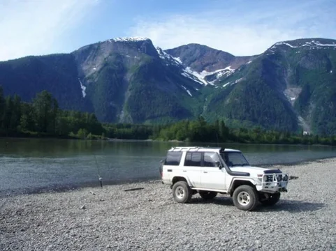

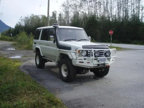

I live in very rainy Prince Rupert and I was having issues with the original ram head sucking up a ton of bugs and rain water. I did tilt it to the side but It still would suck stuff into it all the time. I would accumulate rain water in the catch can lots.... I thought this was mainly from the water crossing to a fishing spot but I found it that rain was also the culprit after better sealing my airbox with plumbers wax. Pre Pre-cleaner.
Since having the pre-cleaner I have caught a variety of dirt, leaves and snow so far.
its going to be an interesting winter driving snow storms to and from the ski hill and even the spring when all the bugs and dust come.
To be completely honest I prefer the pre-cleaner to the ram head.
