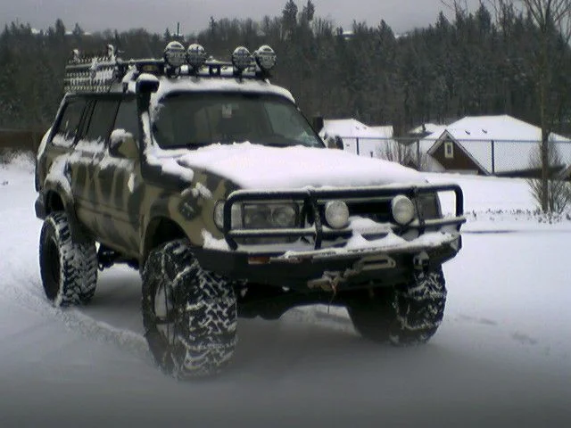

All 4 are safer. Also depends on your Provincial or State Laws. Don't know about other Provinces but in BC it is against the law to run chains on the front only. You can run them on the rear only but if you run them on the front you must run them on the rear too.
Little info from a Newbie.
