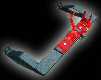

In my other vehicle, I have an extinguisher mounted in front of the passenger seat (pictured). It is out of the way and allows the seat to go all the way forward if needed. I haven't looked at the cruiser to see if such a bracket could be made though.

Hoser, a similar but even simpler bracket would work in the 80, since reading this thread I have been thinking about movign my puny fire extinguisher up to the foot well from in the back (loose resting in the 3rd row seat bars) and possibly getting a larger one, the one I have is 1lb :whoops:
