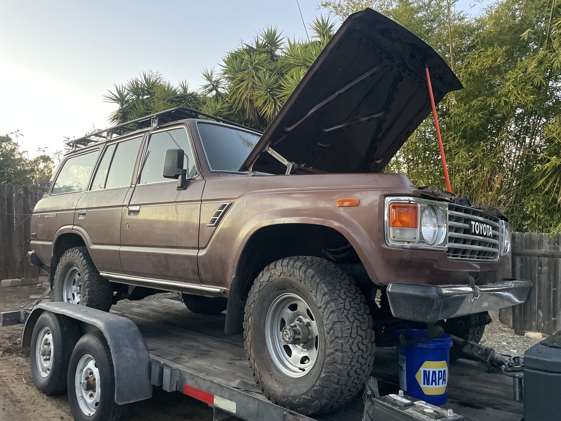

Hook up smog equipment on an 83 cruiser with a 2F motor. It’s got the 4 speed transmission. I have a box of smog components that may work but not sure where everything goes. Any input helpful. Smogged in California
-Anthony

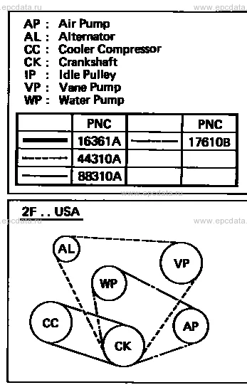

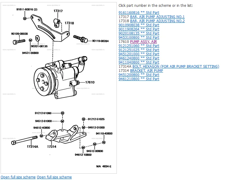

Can anyone supply a photo of the smog sir pump bracket hooked up to the 2F motor. The belt size and belt route. Also a photo of belt size for the power steering pump and belt route.
Here are some diagrams. Hope this helps.
Toyota part numbers:
Air Pump V-belt (smog pump): 99343-11120
Vane Pump V-belt (Power steering): 99343-11570
1. Emissions manual for 2F motor, section 3-19:
2. FJ60 Micro-fiche, section 1-H6 (page 139):
I have a publicly-accessible "manuals" folder on my Google Drive, feel free to download any from there. "2F Emissions Manual" and "FJ60 Part Locations", respectively in there.
