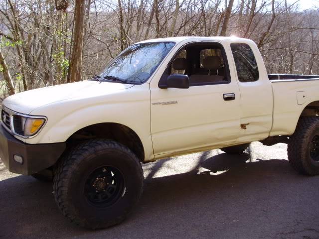

Looks like we found the problem. In screwing around with it today....had same issue.... got to looking at the passenger side Birfield Axle and compared it to the old axles we removed (stock vs. longfields)... discovered that the passenger side inside axle was some 2.5 inches shorter than it should have been. I'm told that we got an inner axle designed for a pickup rather than the 60 that I ordered. TMP fix was to re-install old axle until new replacement shows up. What a deal (I guess we should have caught that previously but we assumed the parts were right). 4wheel drive works now. I'll run the auburn LSDs as long as they work...maybe later will go with ARB lockers if I have the $$. Boy did we waste a lot of time screwing around with this issue. Guess I've not had any real luck on the swap....had some engine issues initallys, then PCM programming issues, rear heater core problem and then the front differential.
Long said they would send out a replacement axle to make it right... For now I'll run the OEM stock axle. Some times your @$$ gets chapped for trying to improve your truck..
