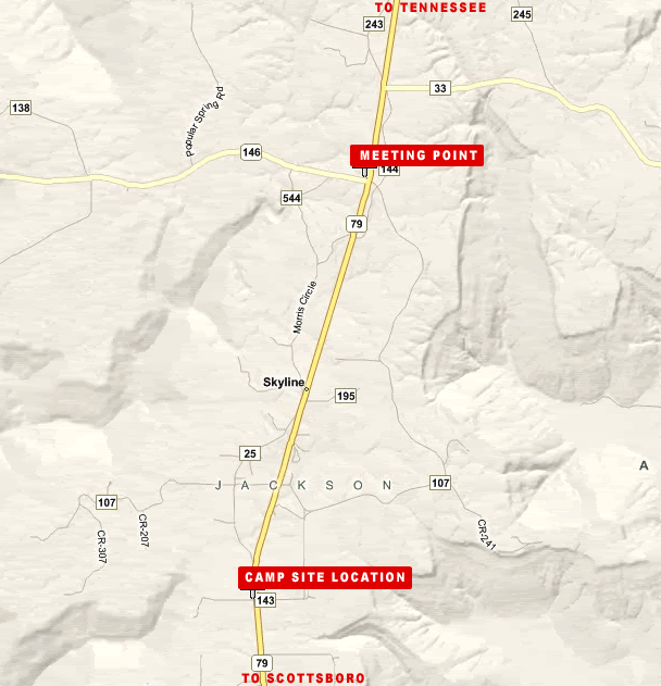

On directions to the camp site:
Google maps can't even find my parents house when you put in the address and I just checked map quest and it tells you to turn west on County Road 143 when should be going east. So I did a screen capture of the google satellite image and made my on map for you guys.
Hope this helps:
