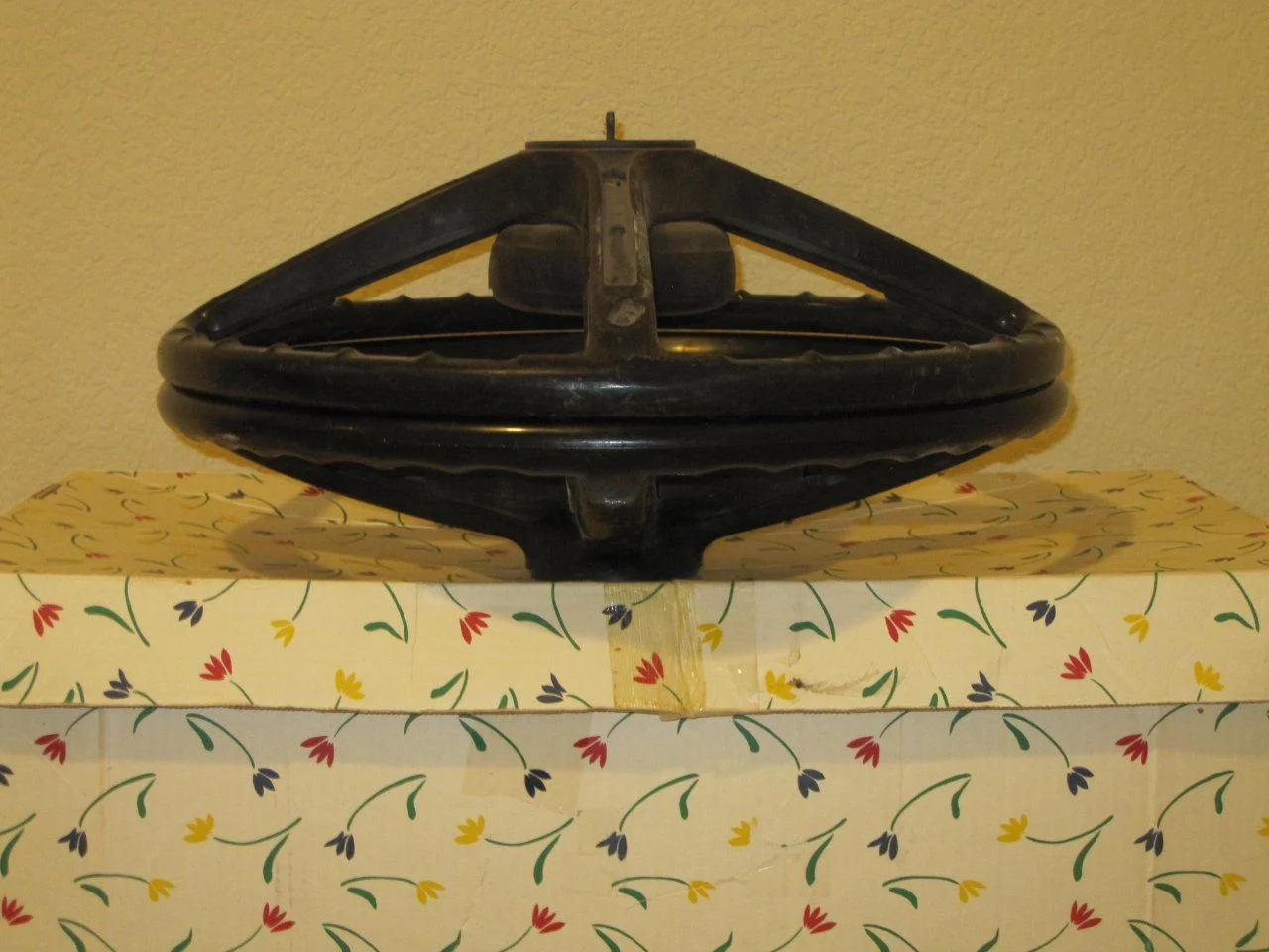

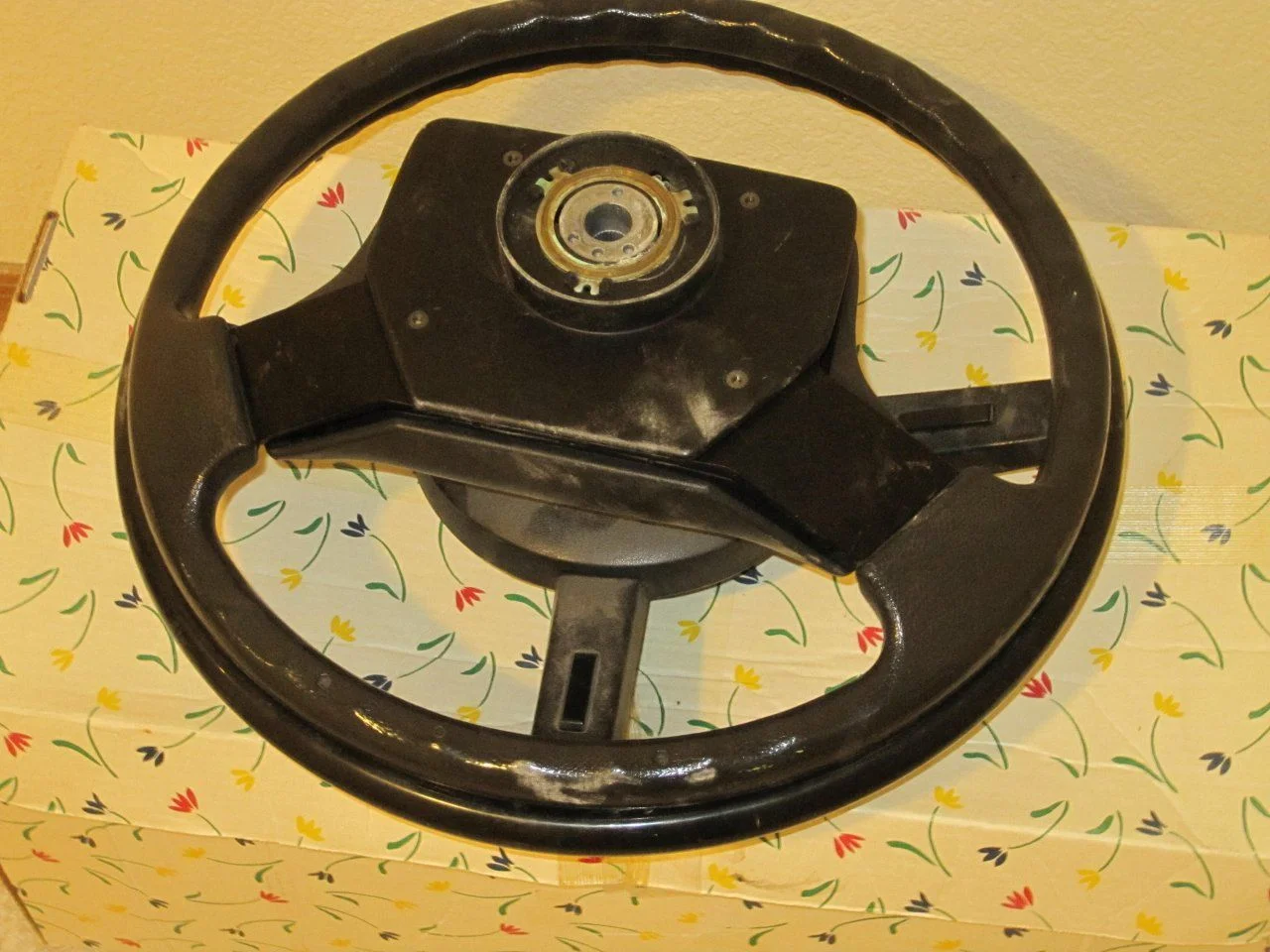

Here is the 73-80 steering wheel compare to the 81+ steering wheel

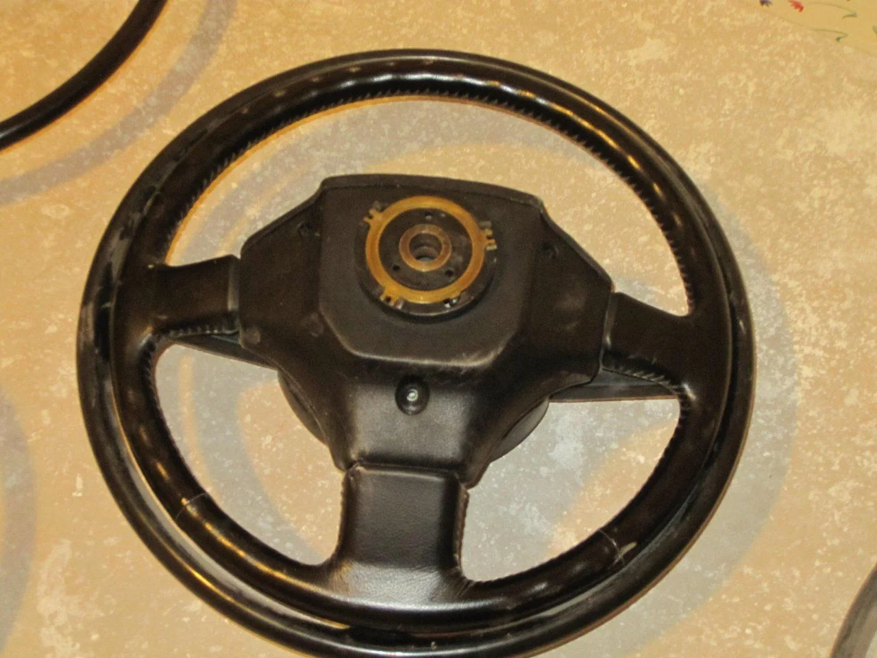

Late model 40 series compared to a 60 series

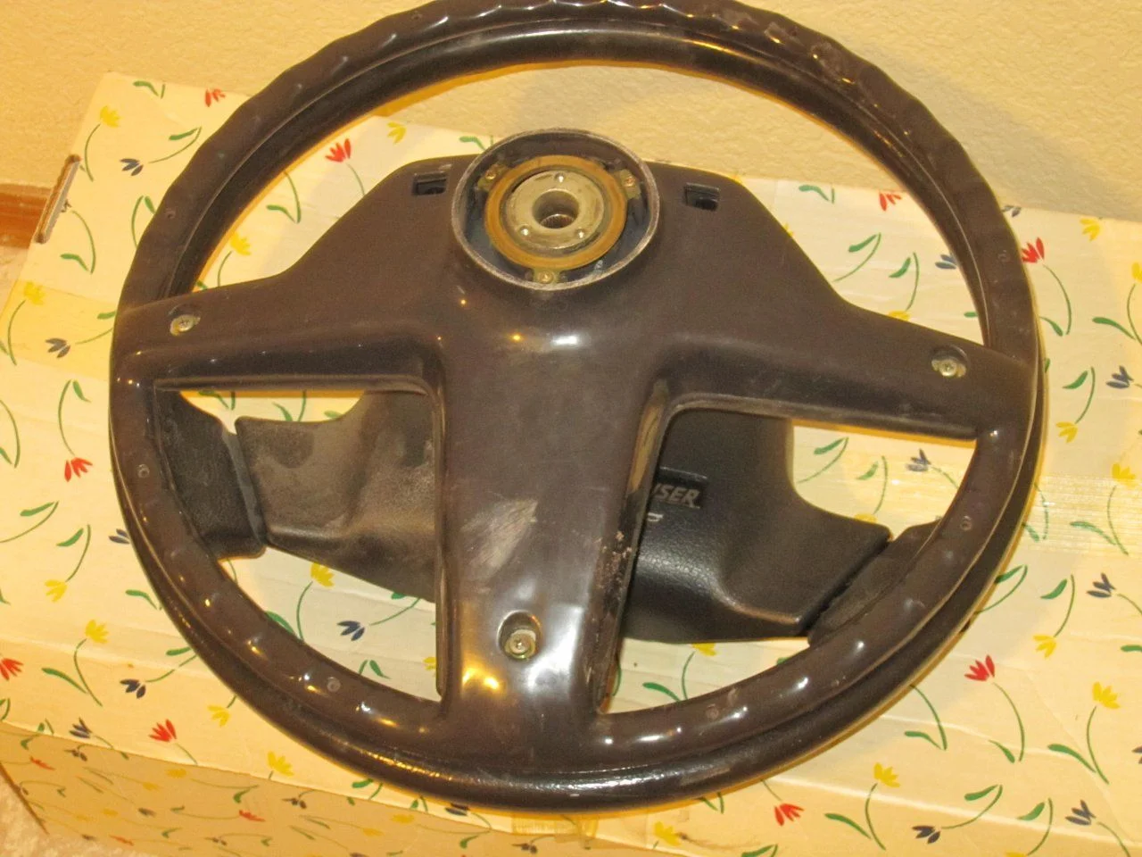

Late model 40 series compared to FJ62

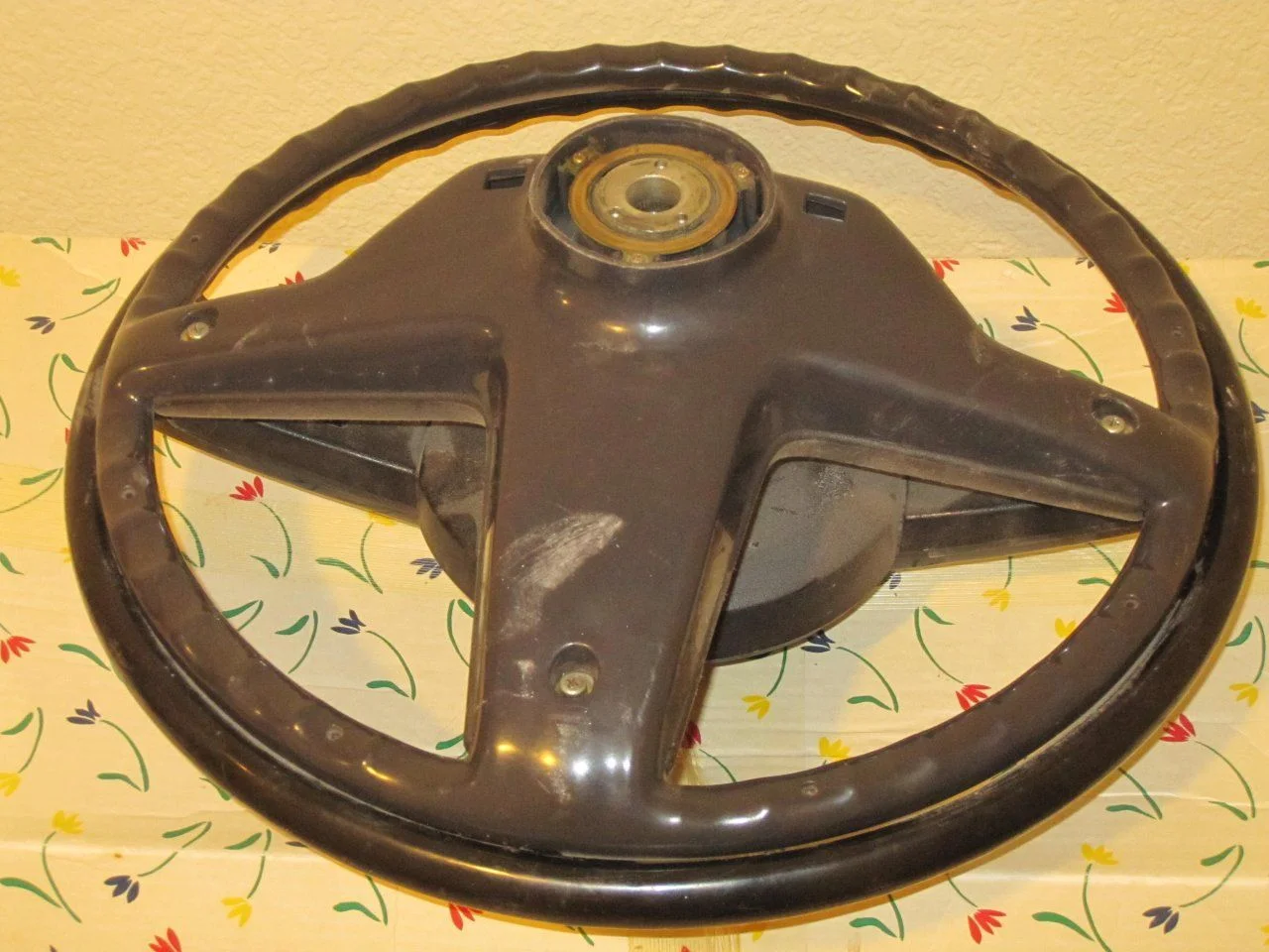

This shows the 62 series steering wheels is slightly larger than the 60 series.

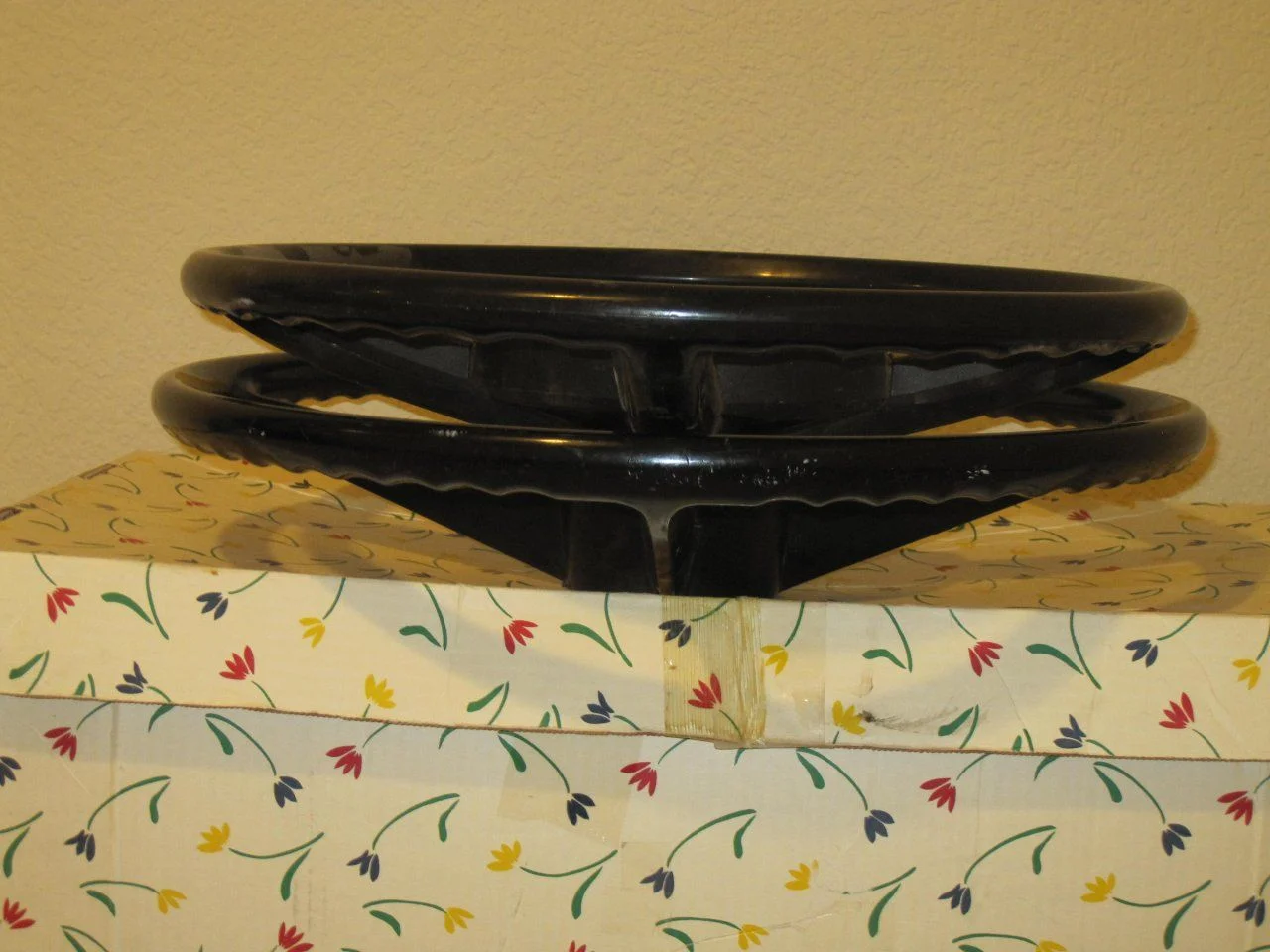

As far as I know while the design changed over the years of the 4X series there are only two diameters. The changed happened between the 72 and 73 models. the earlier being larger.

I think your "Late model 40 series compared to FJ62" photo is the 81+ wheel? Looking at the 1st photo I think that 81+ wheel is slightly smaller then my 78 wheel or are they actually the same? If the are actually the same size your current photo is good. If the 78 wheels is larger....it's unlikely the swap to a FJ62 wheel would be worth it.
