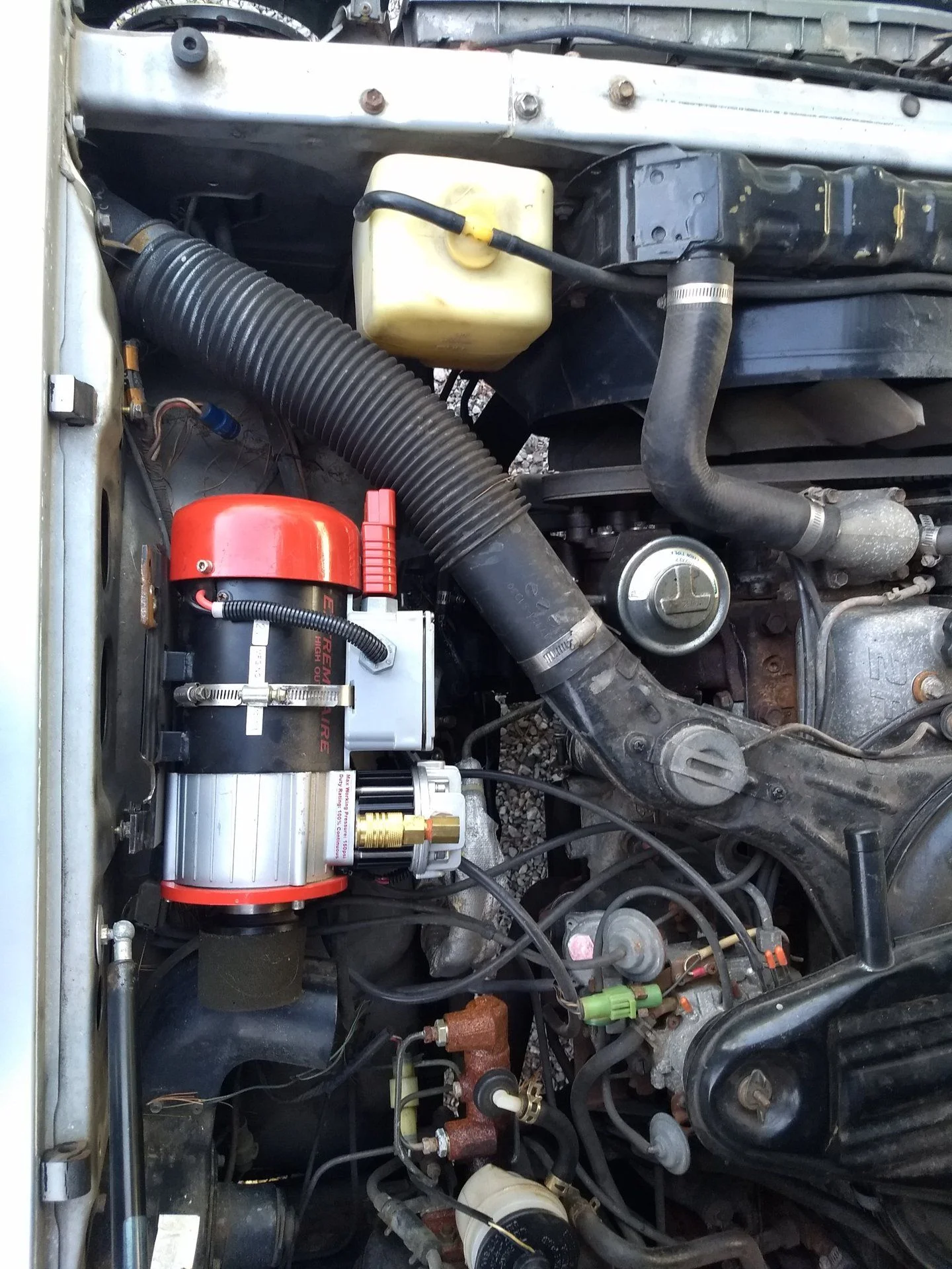

Small footprint 2nd battery?

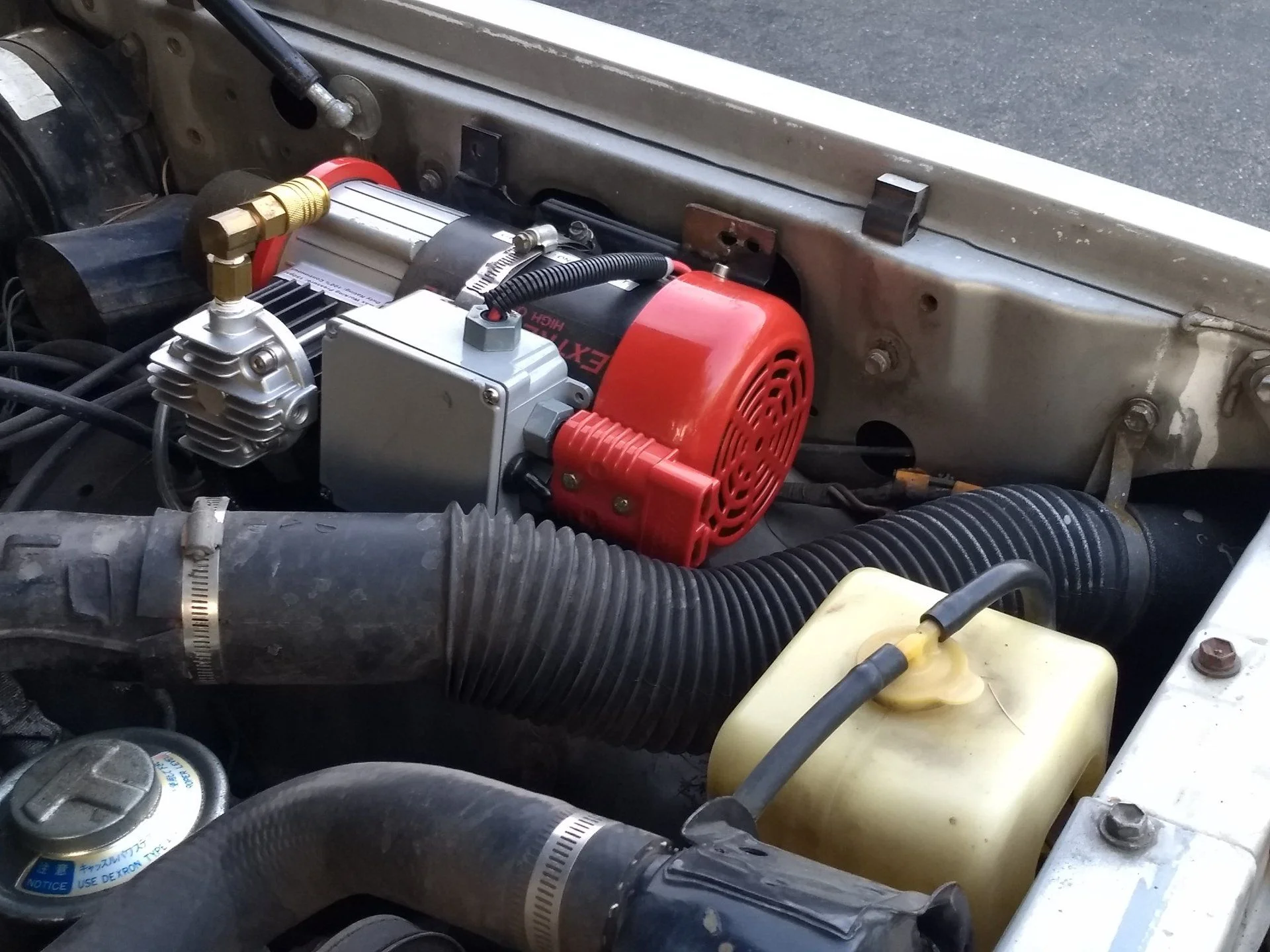

This one seems to have made it work... Got this from a Google search.
Your going to have to move the coolant overflow bottle for sure. If you do that and do not want to reroute the intake hose one of those smaller batteries should fit. What is the Amp draw of an Extreme Air compressor. Should not be to bad and I would think a smaller battery would work.
The intake hose may be tight to the tray or battery, but not a big deal.
The compressor is larger so it will fill the spot where the headlight washer tank was.
I have no problem extending/routing the intake hose to suit. Relocating the overflow is also not an issue, even if I have to switch to an aluminum tank because of proximity to the exhaust - hell, a narrow long tank could work as a bit of a heat shield for the compressor and 2nd battery!
If you mean mounting the battery, of course not. If you mean flipping the truck, well, that's not in the plan ;-)
I keep forgetting that the 60 guys always have some work to do with routing the intake. 62 makes it a bit easier.
Should fit....
