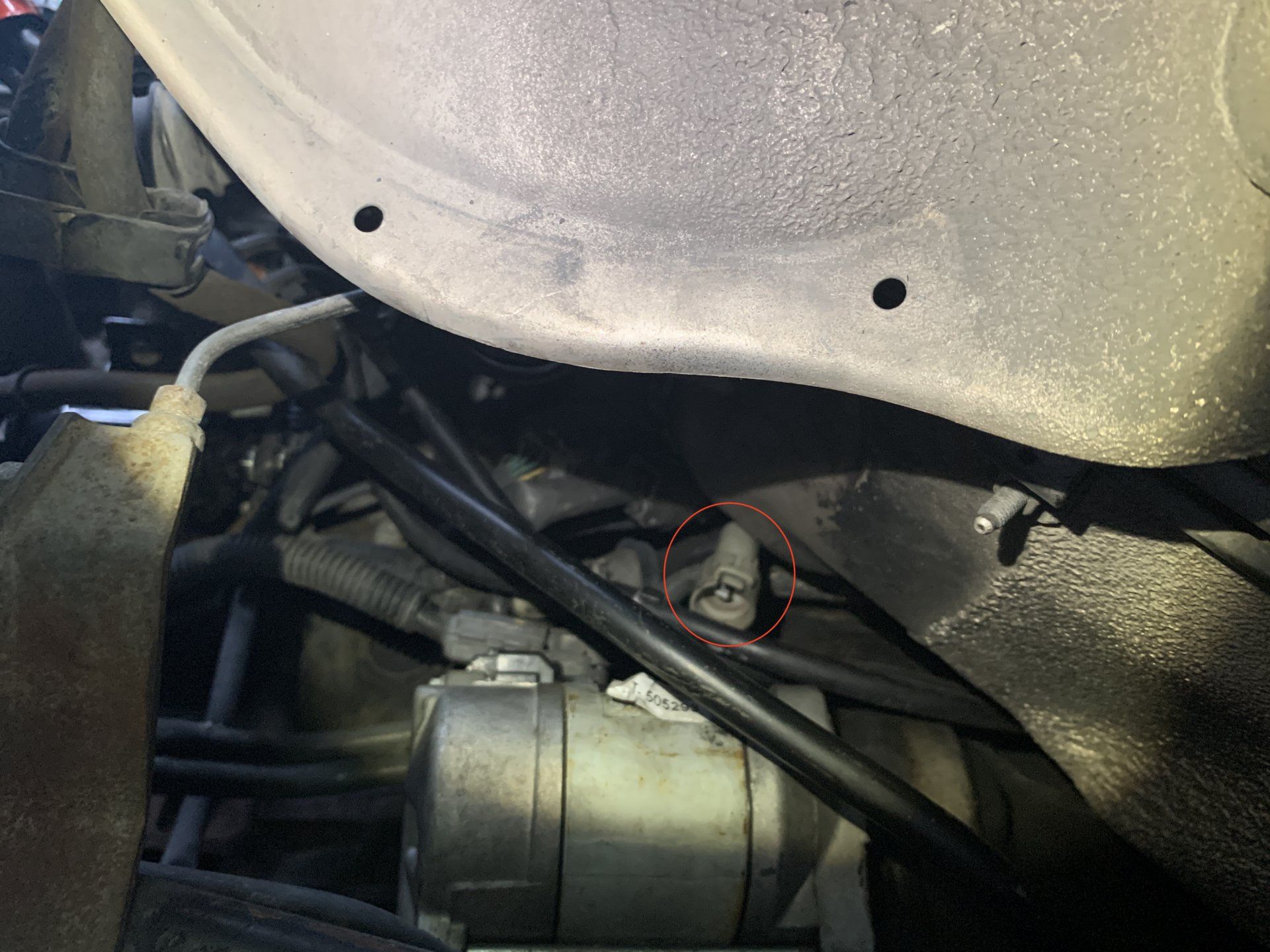

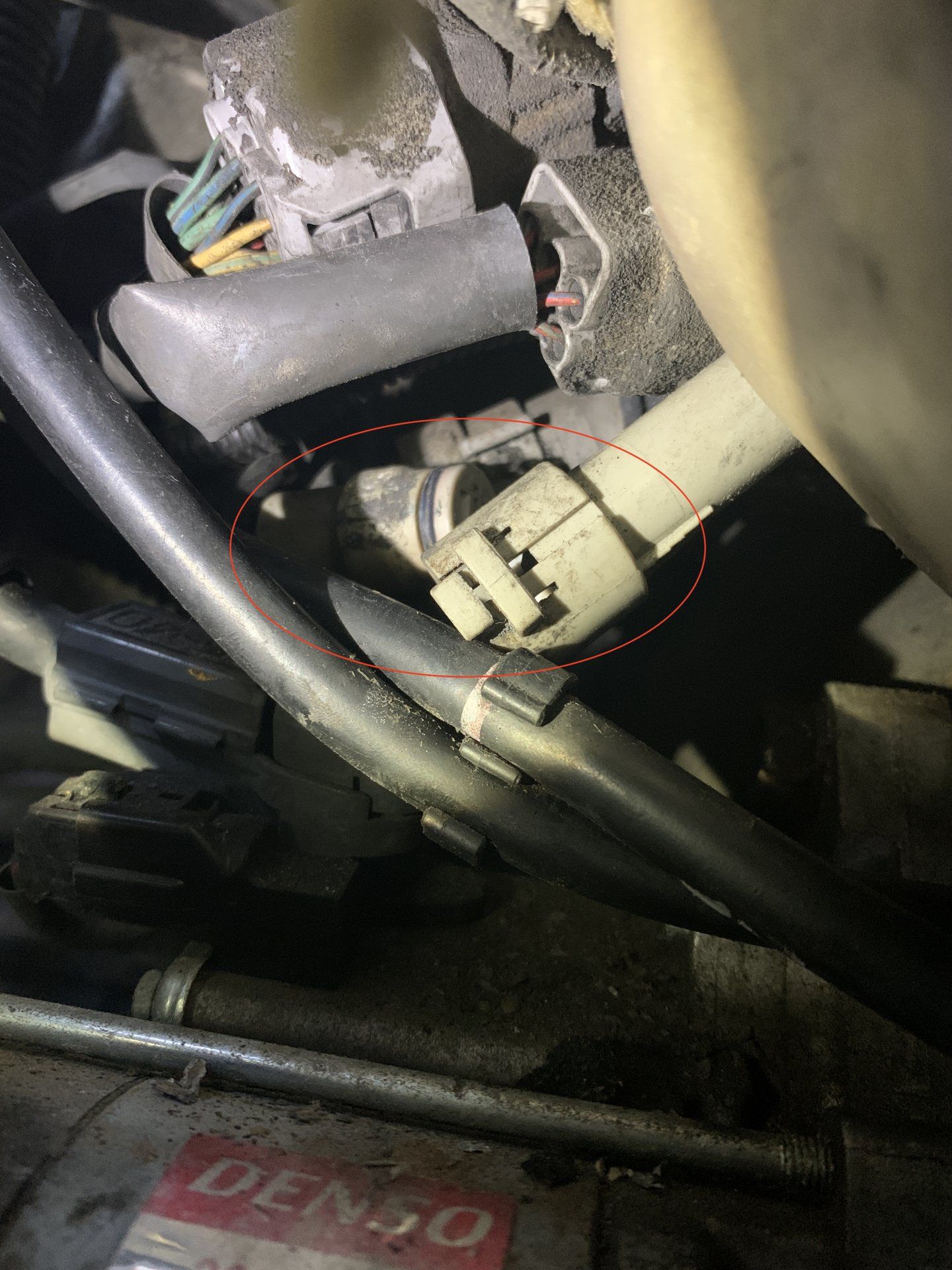

Well I got it all back together and it seemed promising on the first drive, but the second it acted up again. I just cleaned (what I think is) the neutral safety switch connector (photos attached). Please let me know if this is the correct connector. It's the only barrel style connector I could see near the PHH.
One male end looked a little crusty so I tried to clean it with some tweezers. Sprayed some electrical cleaner in the female side. About to go for a drive so we'll see.

Cleaning the connector apparently did not help. Still experiencing this intermittent problem.

I'm in the same boat, replaced solenoids yesterday morning, let the fipg cure 24 hours. Filled up with fluid and still sluggish start. My NSS was already switched out the most corroded part was under the pesky heater hose have you checked that end ? Today I will check the transmission control module and check for loose plugs into that

Thanks. I'll check that connector next.
