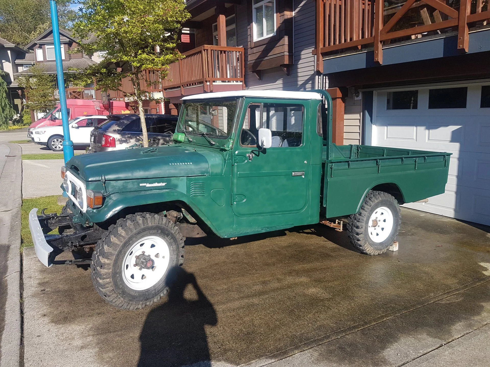

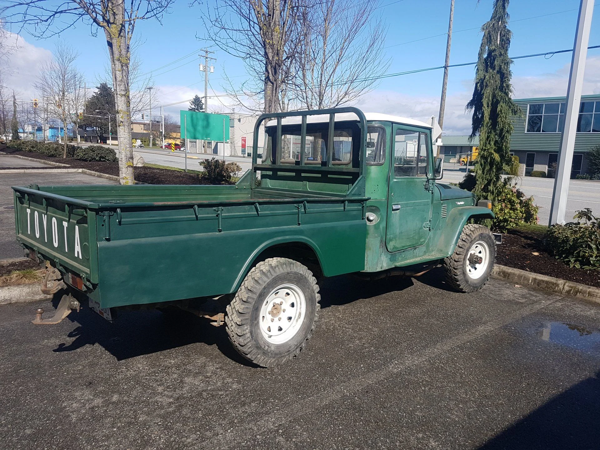

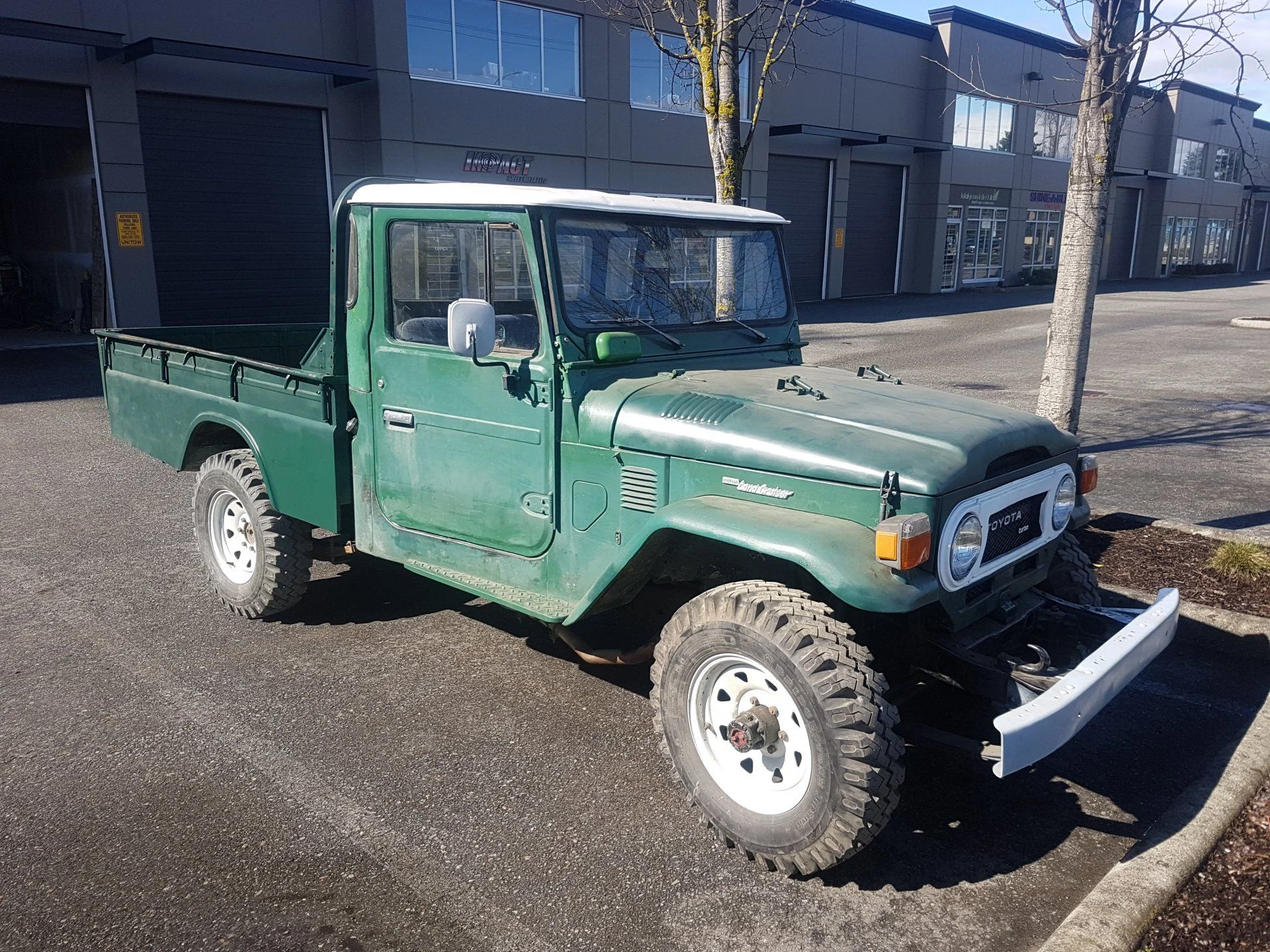

Some pictures of it outside. Ignore the mismatched paint. Still a ways to go in that department.

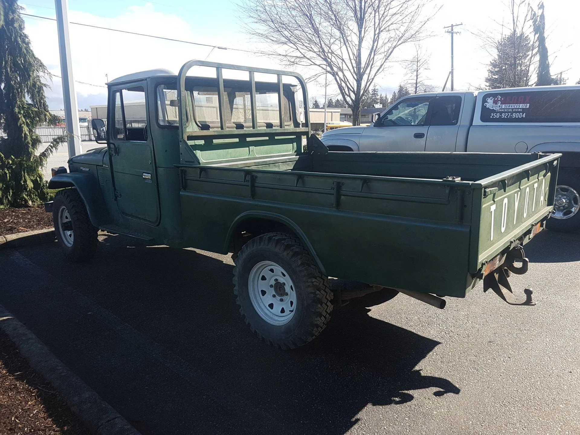

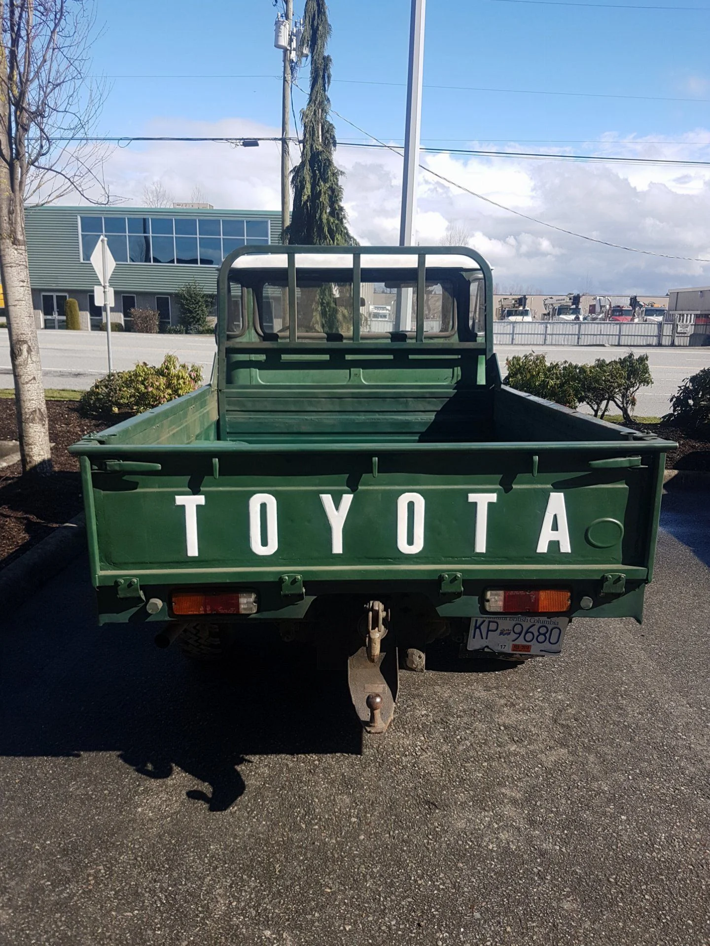

Pictures are of our destination after our first longer drive, and a washed truck. Last picture is of Joss in the "viewing chair" when we sat in the sun and had a beer in a water bottle.

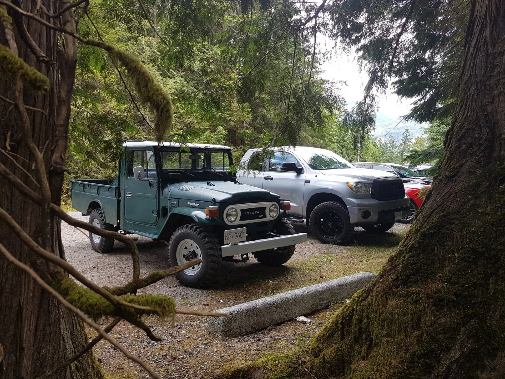

On that note, we really did not do all that much work on the Cruiser for the rest of the summer. We have just been enjoying driving around in it and here are some pictures of that. One shot is of the cruiser on the ferry coming back to the island. Another is at 10 Mile point in Victoria during our first drive around town. One is of a Thunderbird, a 60 and the 45 at Trotac Marine. The other is of my brothers Tundra and our cruiser near the Skookumchuck rapids. Last one is of Joss and I cleaned up for a cousins wedding. We have a stash of earplugs in the ashtray for highway driving. The truck happily moves along at about 105 kph in 5th. Lots of power in 1st and 2nd from the turbo. The 3B is quite a different animal when it has air being crammed into it. All in all it has been a great summer, but it is almost time to put the Cruiser away for the winter and finish up some more of the projects which need doing.
