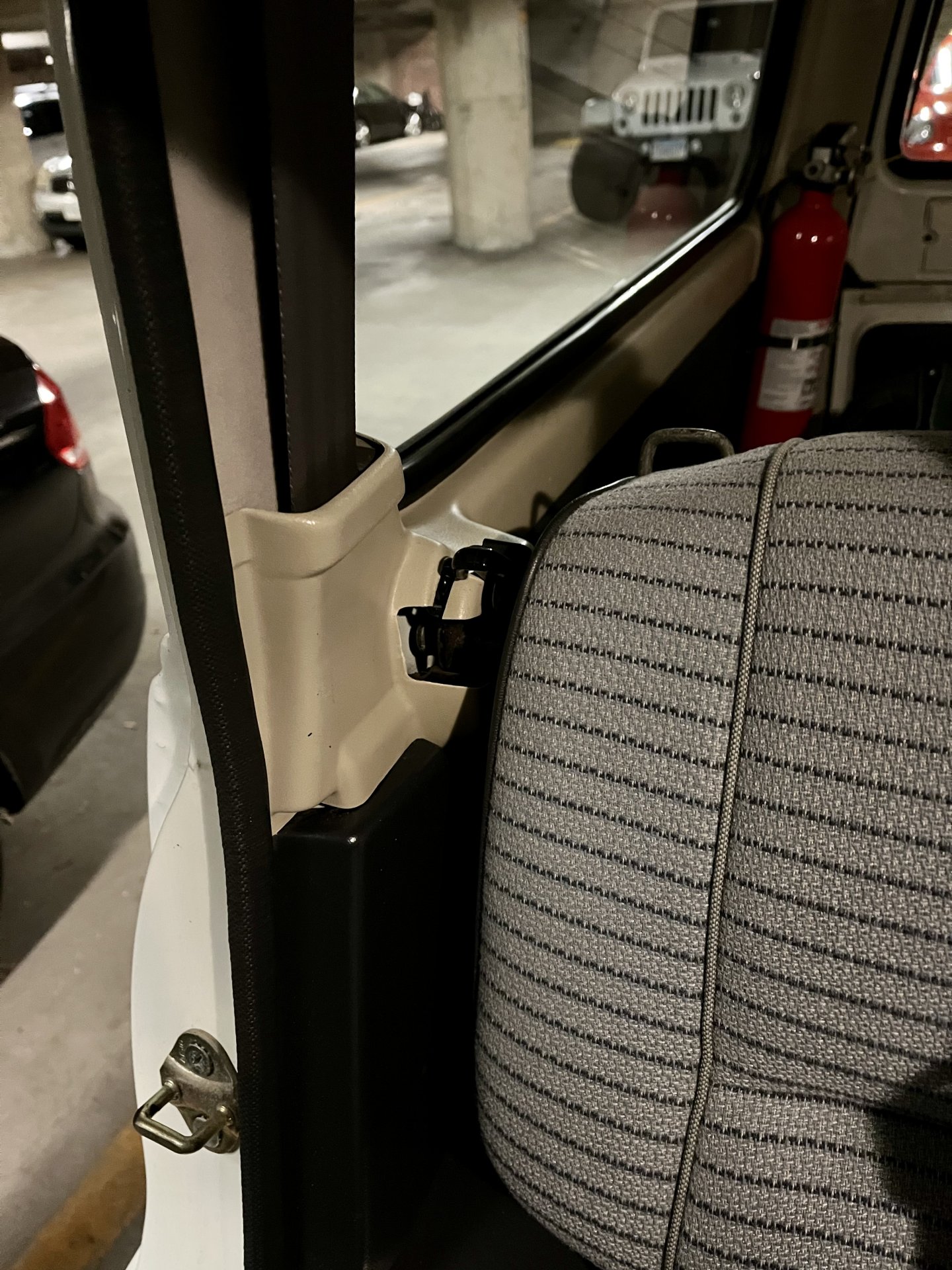

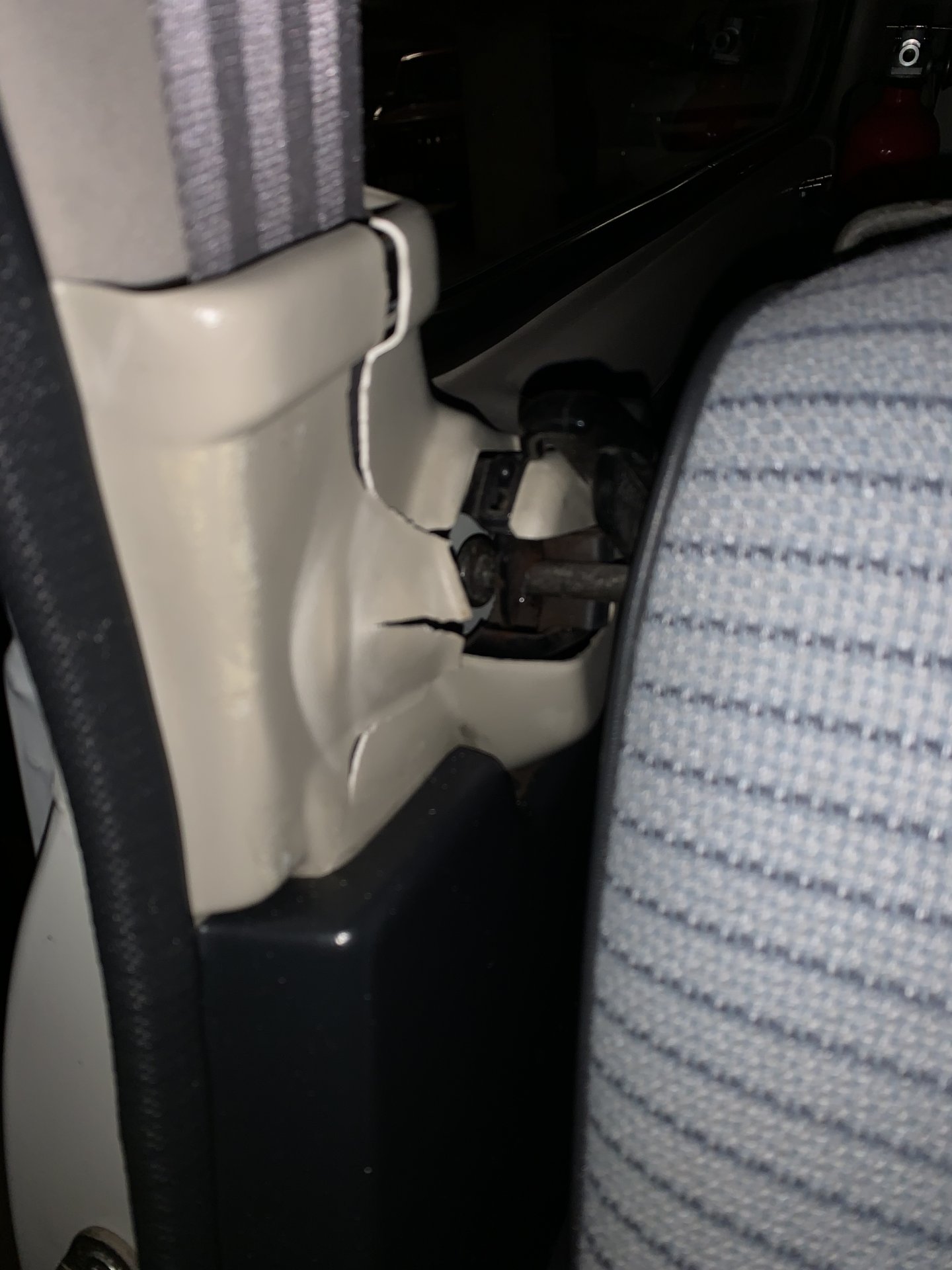

I’ve also got interior trim inbound from @FJ40GURU that I will have to wait a bit to install. My originals are badly cracked on both sides at the seat latches and look like this.

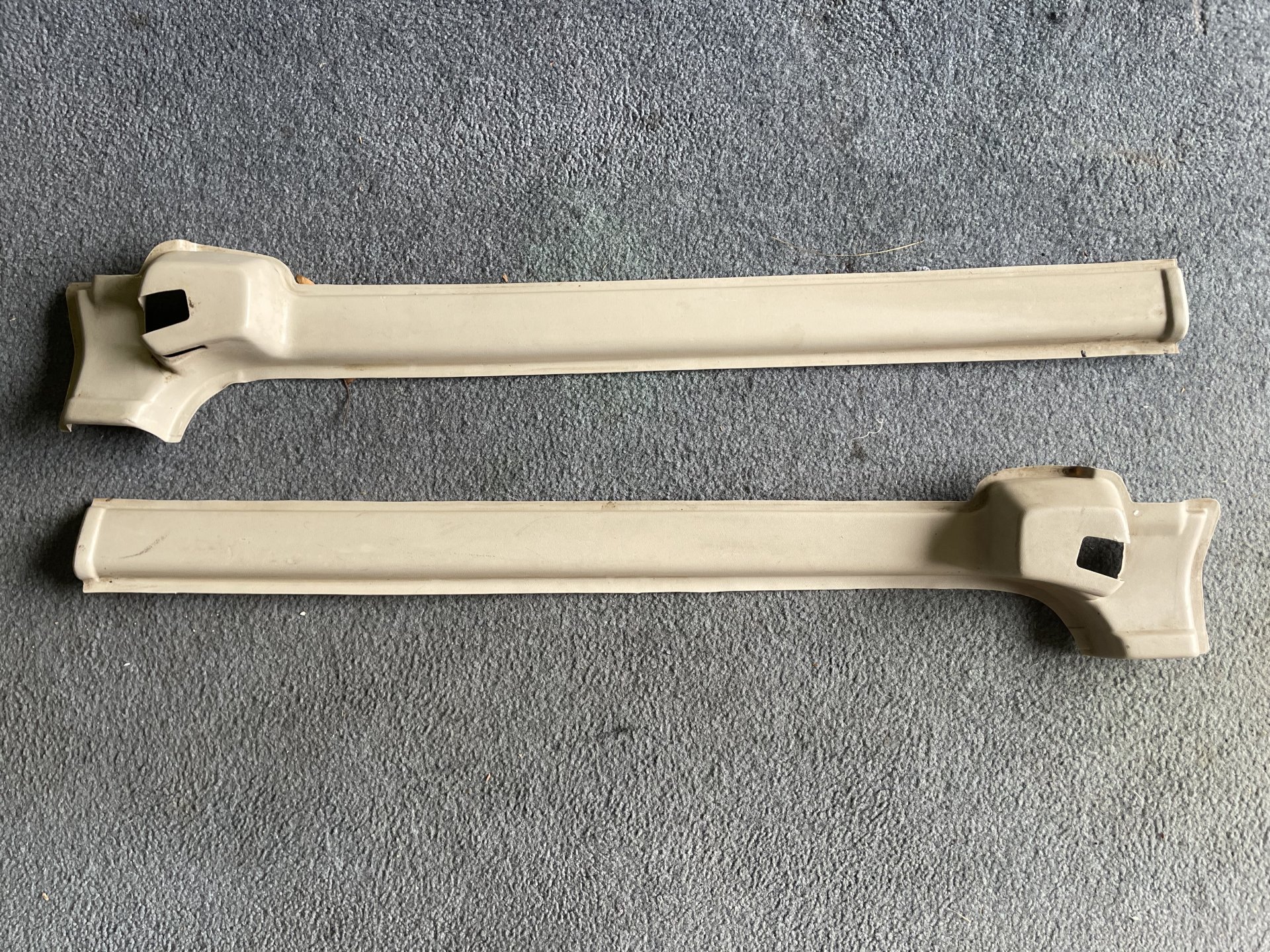

Here is what Amir is sending me.
Should be a big visual improvement in my quest to keep my rig close to stock.

Amir (@FJ40GURU ) hooked me up. These trim pieces are becoming very difficult to find in excellent (used) condition. They matched his description and surprisingly were more affordable to buy and have shipped from Australia than I’ve been able to source regionally in the States. I was a little worried about the shipping because they are thin and somewhat brittle pieces, but he packed them very carefully and they made trip around the globe successfully. I’m not sure what other parts he has for an FJ62 or other LCs, but you guys should hit him up.

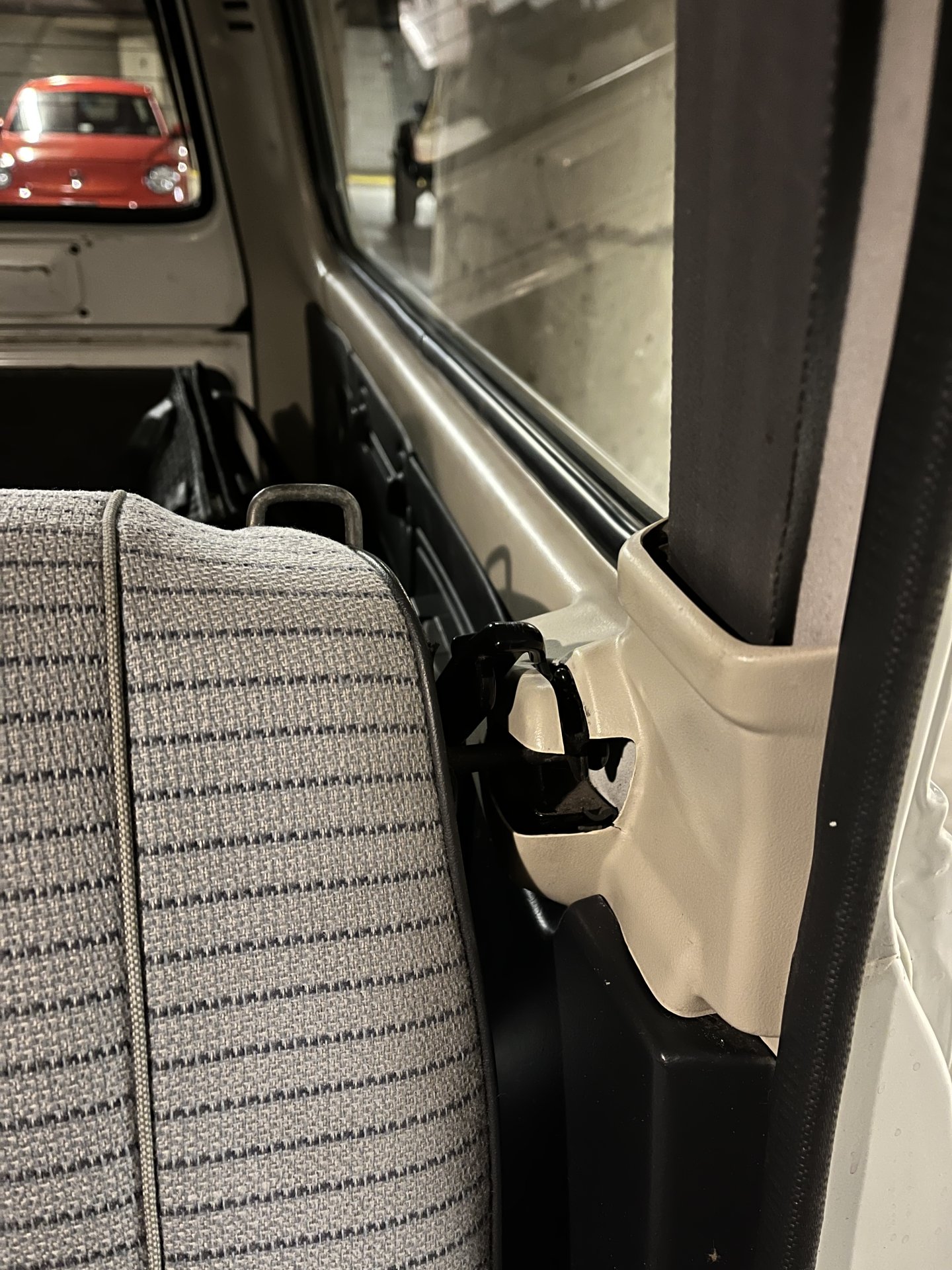

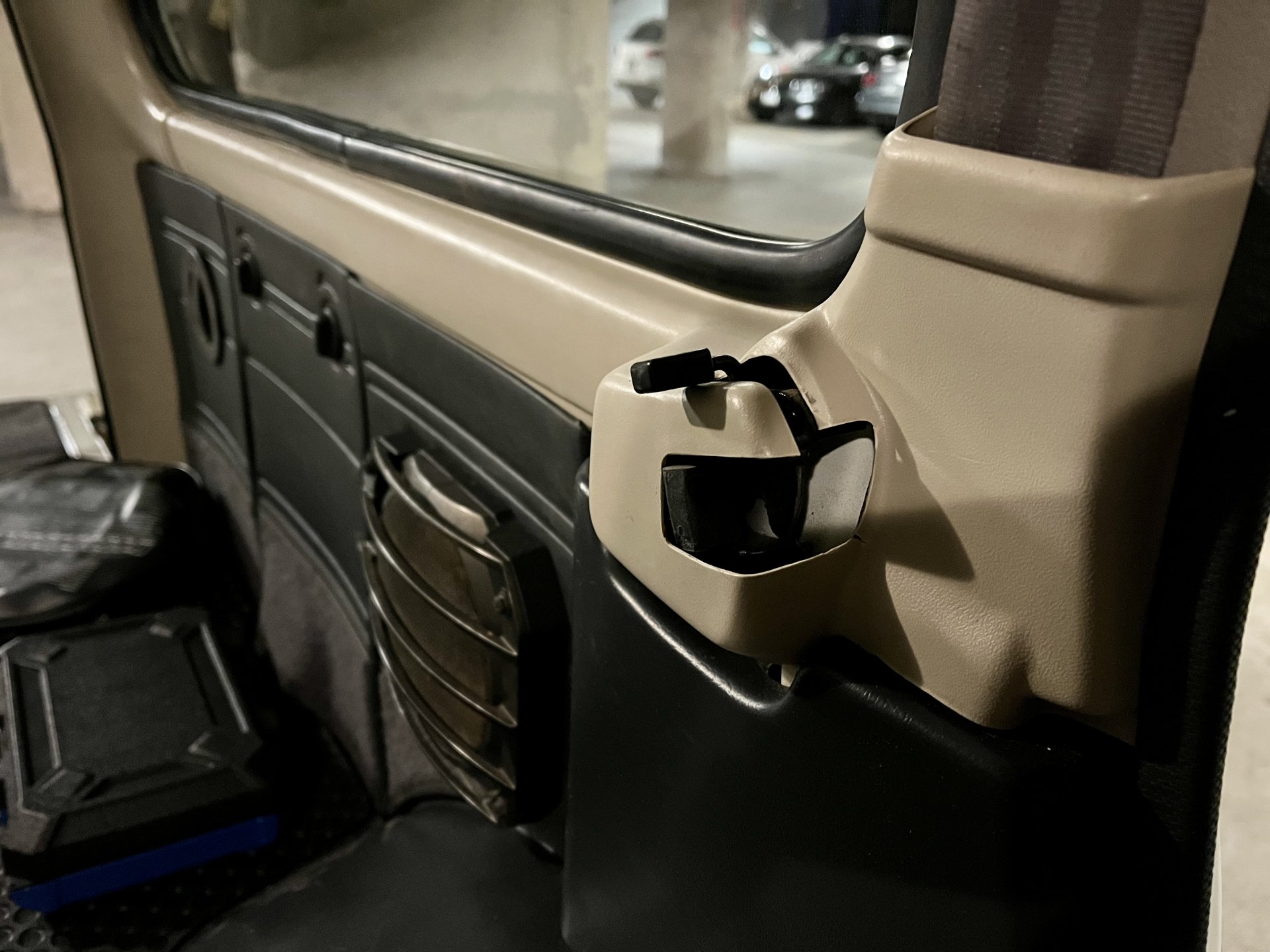

Lastly I replaced my cracked plastic trim pieces beneath the cargo windows with OEM replacements from @FJ40GURU . This involved removing the cargo panels and speakers on both sides, partially removing the door/body seals (not sure exactly what they are called), pulling out the old cracked trim, then finessing the the new ones in place without cracking them.
Not sure what Toyota was thinking with the design of those things. Even in good shape, they don’t fit well around the rear seat latch brackets. I can see why the originals cracked in the first place. And you have to carefully finesse the top edge in place beneath the window gasket because it helps hold the trim piece in place. Easy in theory but thick stubborn rubber and thin plastic are not very compatible.
But all in all, it really cleaned up the look of the interior. Here are a few pics.
BEFORE
AFTER

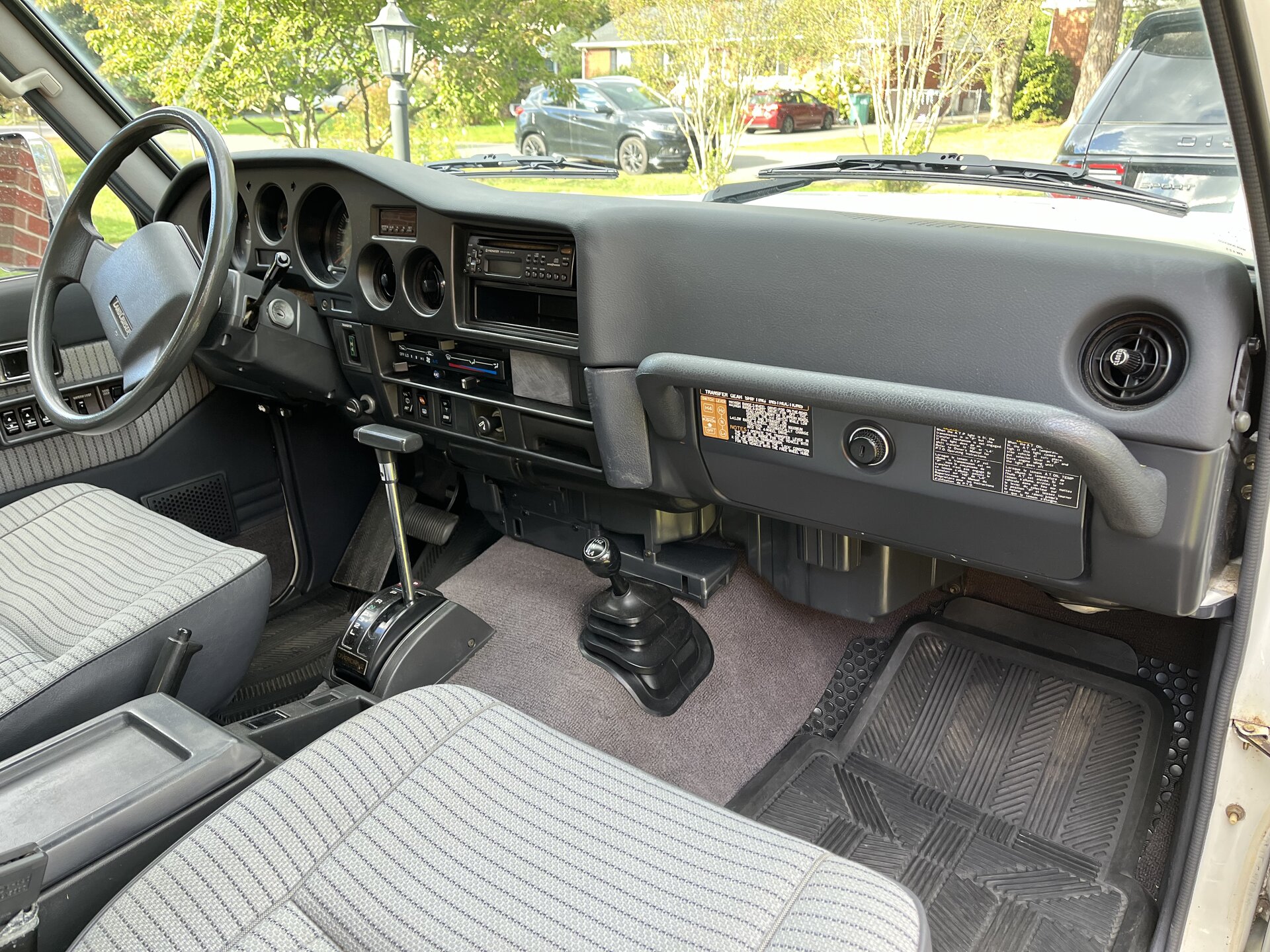

The OEM dash blank plate was butchered to accommodate for this gauge. So I purchased a new one from @ChaserFJ60. It
fits like a charm, but I want to sand the surface more finely then hit it with SEM prep/paint. Gonna wait until the weather is a bit warmer and less windy to do that. I’m leaving it in place as-is for now.

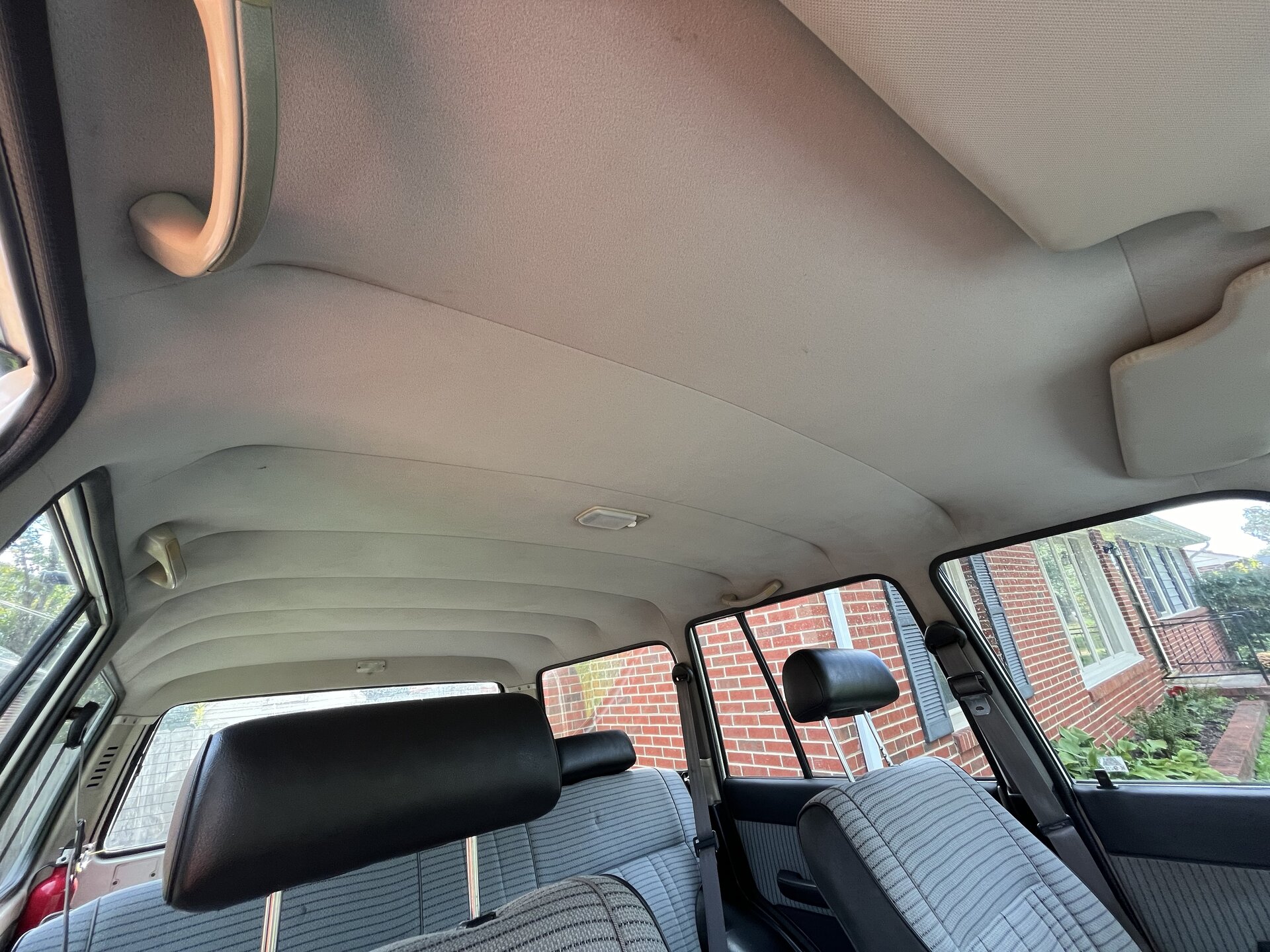

-Added BG 44K fuel system cleaner (11oz) to nearly full gas tank at 143,140
