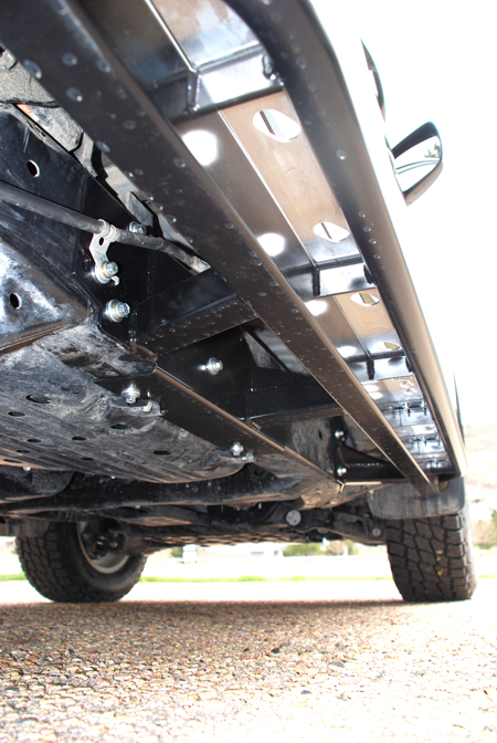

Here you go

I like the White Knuckle Sliders for the bigger kick out plate but the mounting frame looks less beefy than Slee's:
