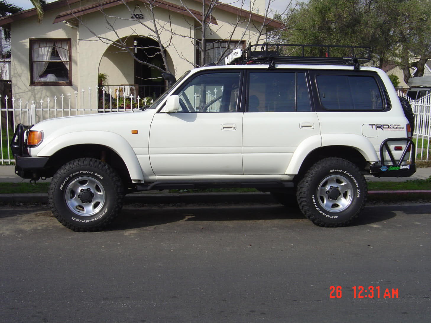

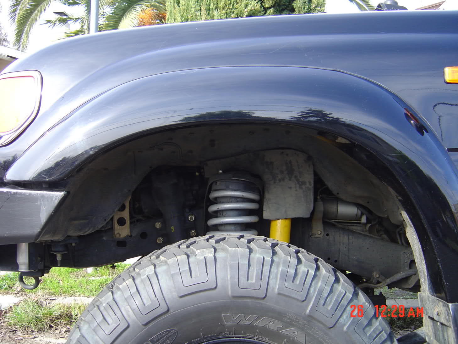

Here is couple pics of the Slee 6" w/1.5 spacers in the front only (for right now). We have not installed the rear upper control arms yet, thats why we have not out in the rear spacers. Cruiser is not level right now, the rear sits about an 1" lower than the front. I Will take some more pics when we get the control arms on and rear spacers...:

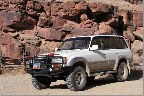

Here is my cruiser for comparison (2.5 OME w/ 1" spacers):

Looks sick ..
Oh, and is that an ARB bullbar cut up? I like it :beer: :beer: :beer:
TY

Get yourself a bigger screen, some of us actually have monitors bigger than 13 inches...:flipoff2:
oh and yes that is what a chopped ARB looks like, damn Mando Man!!!!!:D
Looks nice. Just wondering how big your tires are?
285/75/16 (33's)?
Same question for you.
How big of tires on each rig?
Looks really nice by the way.
Really really nice. :)

The truck belongs to a good customer of mine, Troy Demill. He is running Cooper Discover STT 285/75/16's. :D

285's on white cruiser and 315's on the black cruiser.....
Looks nice ....now you need some longer shocks!!
It has the L shocks installed, what we need is bigger tires. 37's in the near future?????????:)

I don't think an 11" travel shock mounted in the stock position is anywhere near long enough for that much lift. Slee uses these on the 4" lift...they will be extended 3.5" more on your lift...I doubt you'd have more than 3-4" of down travel left...and there is no way you'll have a good balance between up and down travel.
Did you measure how much down travel was available when you reconnected them?

I'd disconnect your front shocks and verify that you can get the front end to droop beyond what your current L-shock gives you. It's deceiving to compare pics to ActionJackson's or AMMO's because their body lifts (not that you or anyone else did) :grinpimp:
Nay
True, true-the Ls are going to kill your flex. I am at the limit and just riding the flat roads till I save some $$$ for bilstiens or somtin. Making me fret :crybaby:
