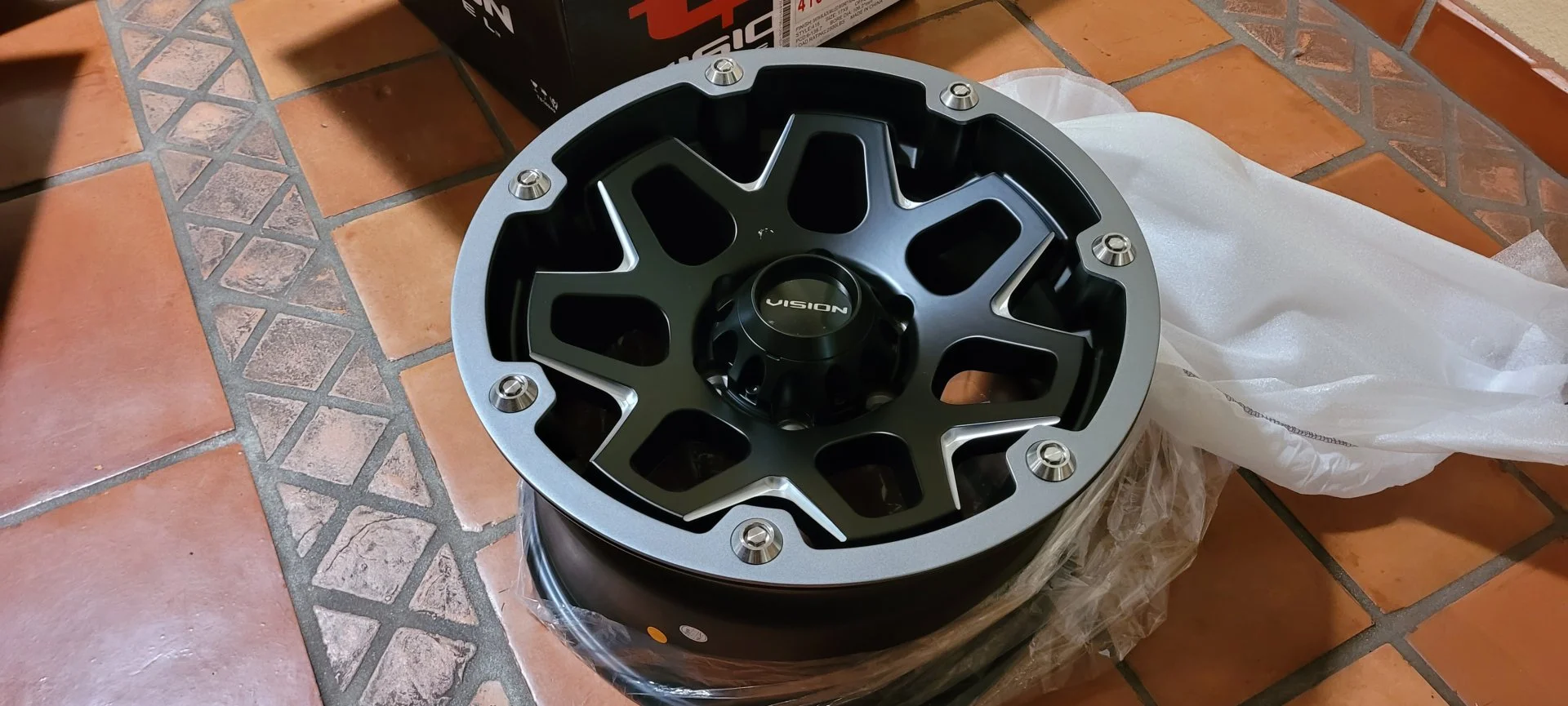

Vision Offroad Se7en 416 Rims in Satin Black with a milled gray ring 17x9 +12 offset

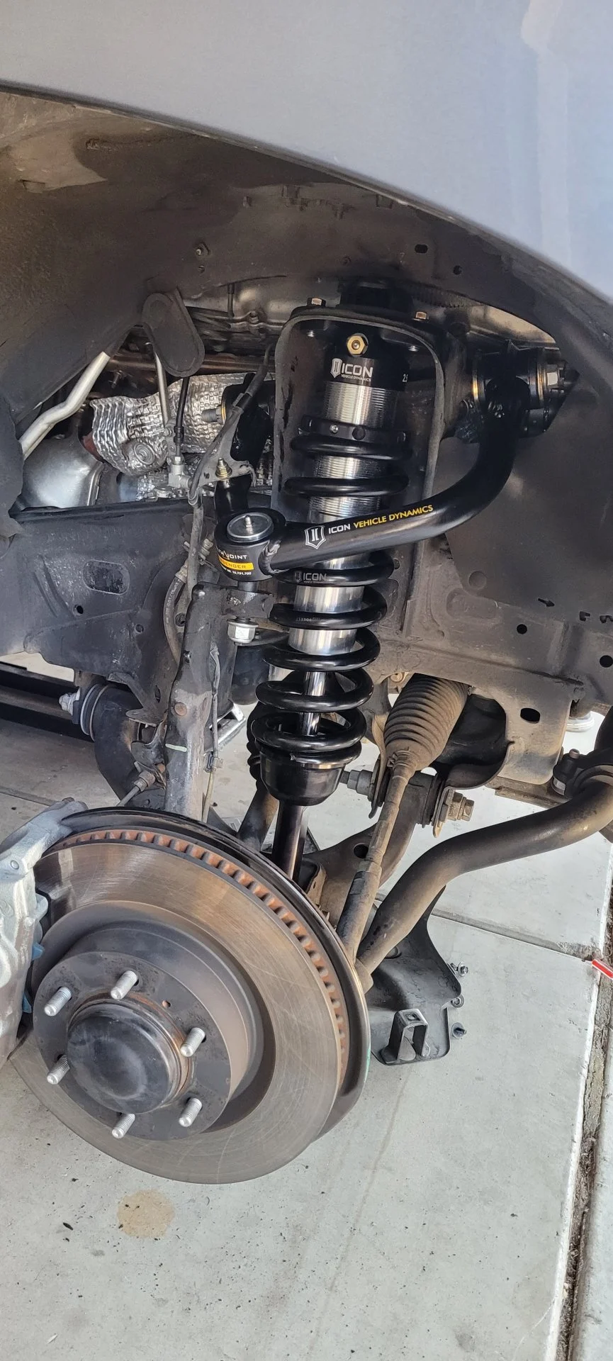

Icon 3" lift kit with an adjustable panhard bar and wrench

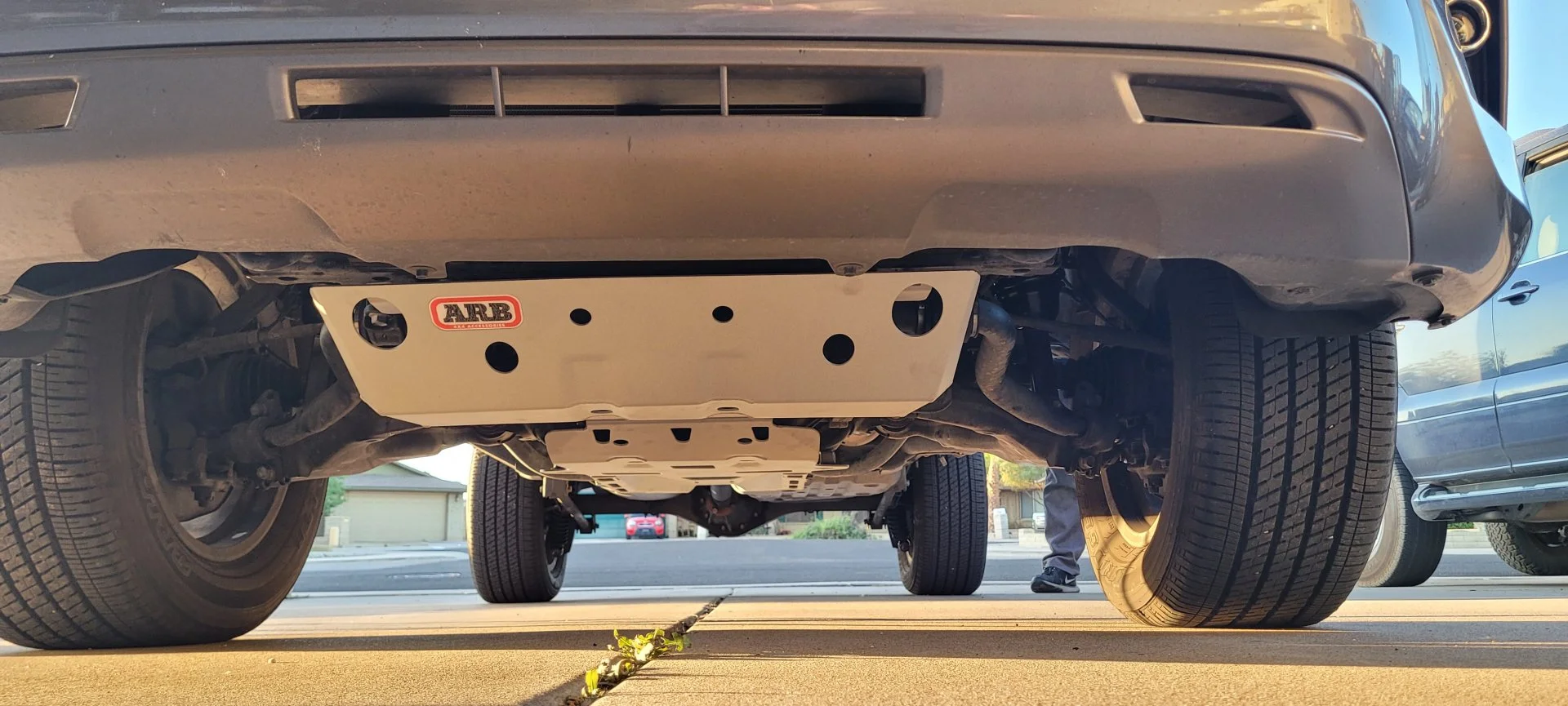

ARB skid plates

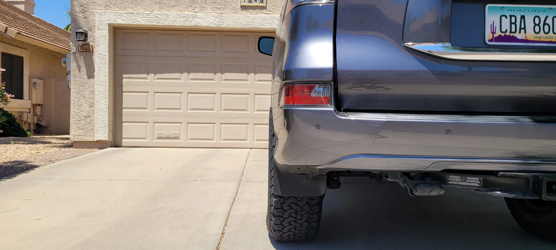

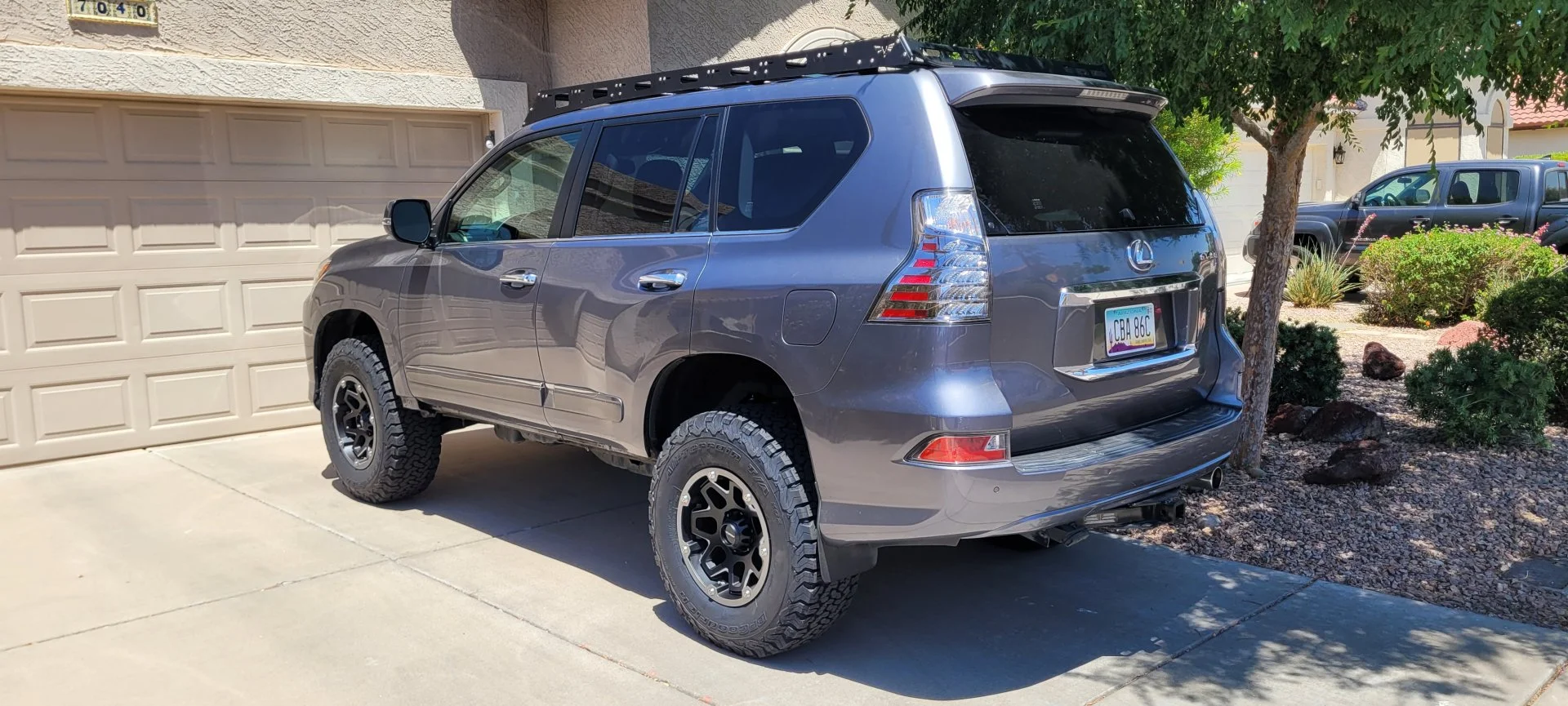

I still need to figure out what to do about a rear tire carrier, whether it will be a whole new bumper with a swingout arm or a trailer-hitch style carrier. Most rear bumpers for the GX look too bulky and ugly, but I don't mind Coastal Offroad's offering. Really hoping that Victory 4x4 rear bumper will come out nicely as well.

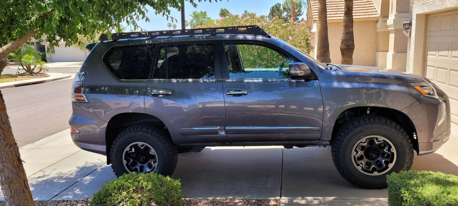

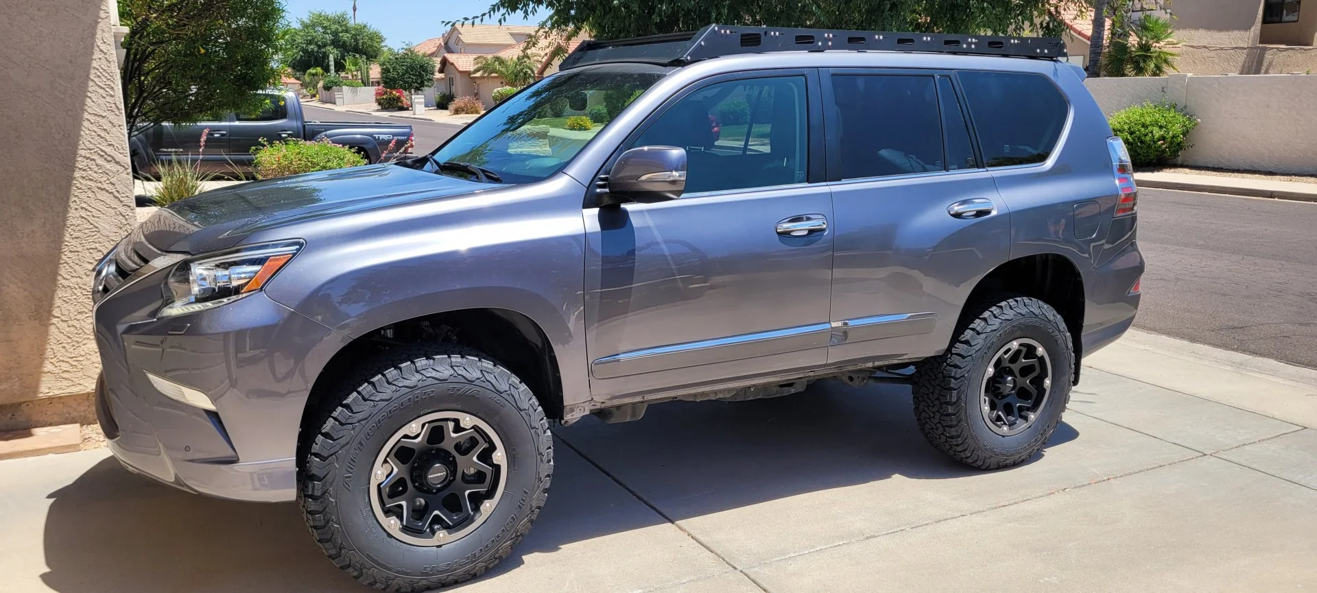

Maybe think about trimming the front and rear bumpers for approach/departure angles??
Looking good! :cheers:
Thanks! I'm going to trim the front as part of the Victory 4x4 Blitz bumper install once that arrives. As far as the rear, I think my lowest point is the trailer hitch. Another reason to go with an aftermarket bumper I guess..

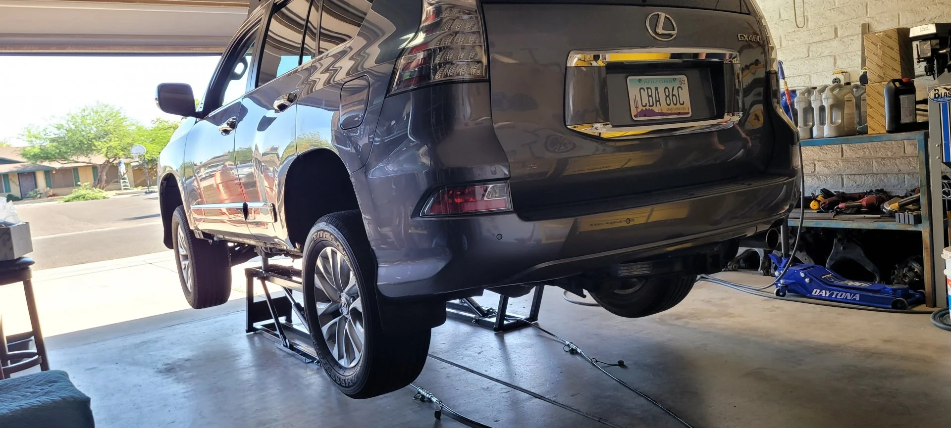

Great looking GX! Looking at yours makes me really want to take off my running boards. What garage lift do you have? I'm looking for a lift solution for my garage but can't make up my mind.
The install actually took place at one of my best friends' house, who is a Lexus master mechanic. He has the Quickjack BL-7000 EXT jacks with the truck adapter kit. He works on side projects all the time and having it is extremely convenient, especially when working on lifted trucks.
How do those 34" tires fit for you? Good looking build so far!
They fit great! The BMC is a must to get them, and the fronts of the front fender liner will need to be slightly pushed back with a heat gun to prevent rubbing while turning. I have yet to finish doing that but there is plenty of room for them to be pushed so it should be a very easy process.

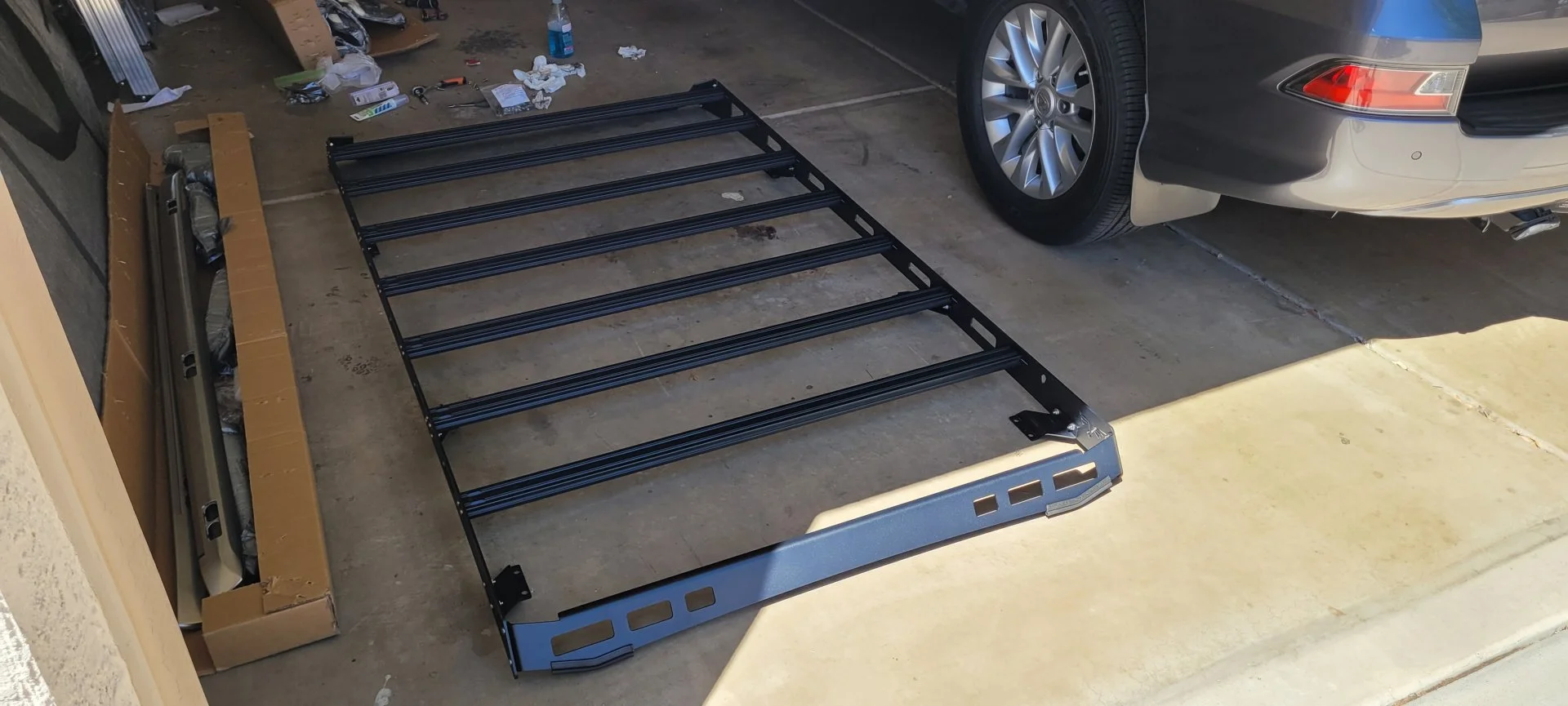

The Victory 4x4 roof rack looks so good and adds a lot character to the car. How is the wind noise on the highway?
I checked out every available rack for the GX before I decided on Victory 4x4's - it was the best looking one and very high quality. Honestly I can't tell the difference in wind noise after putting the rack on.

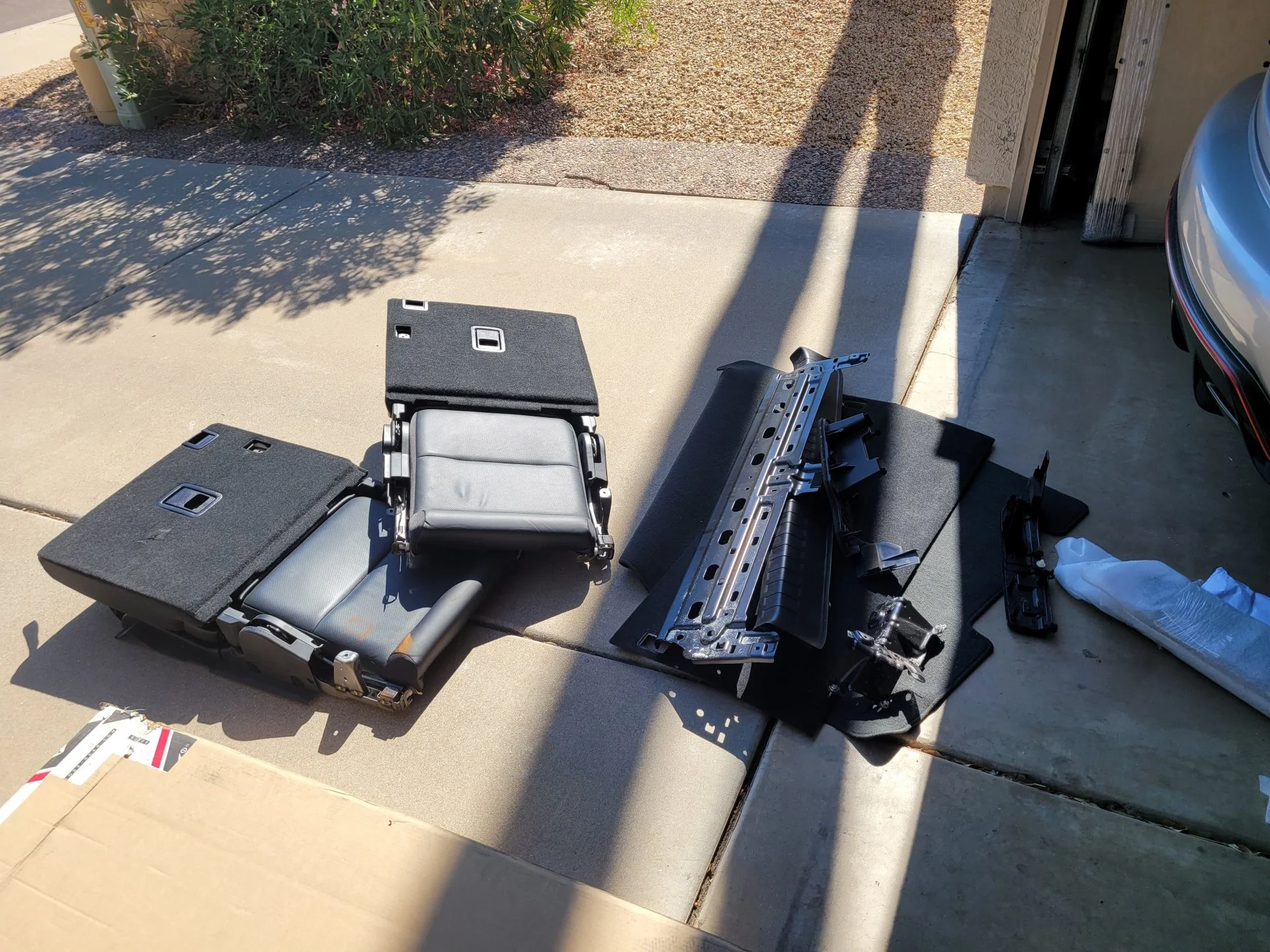

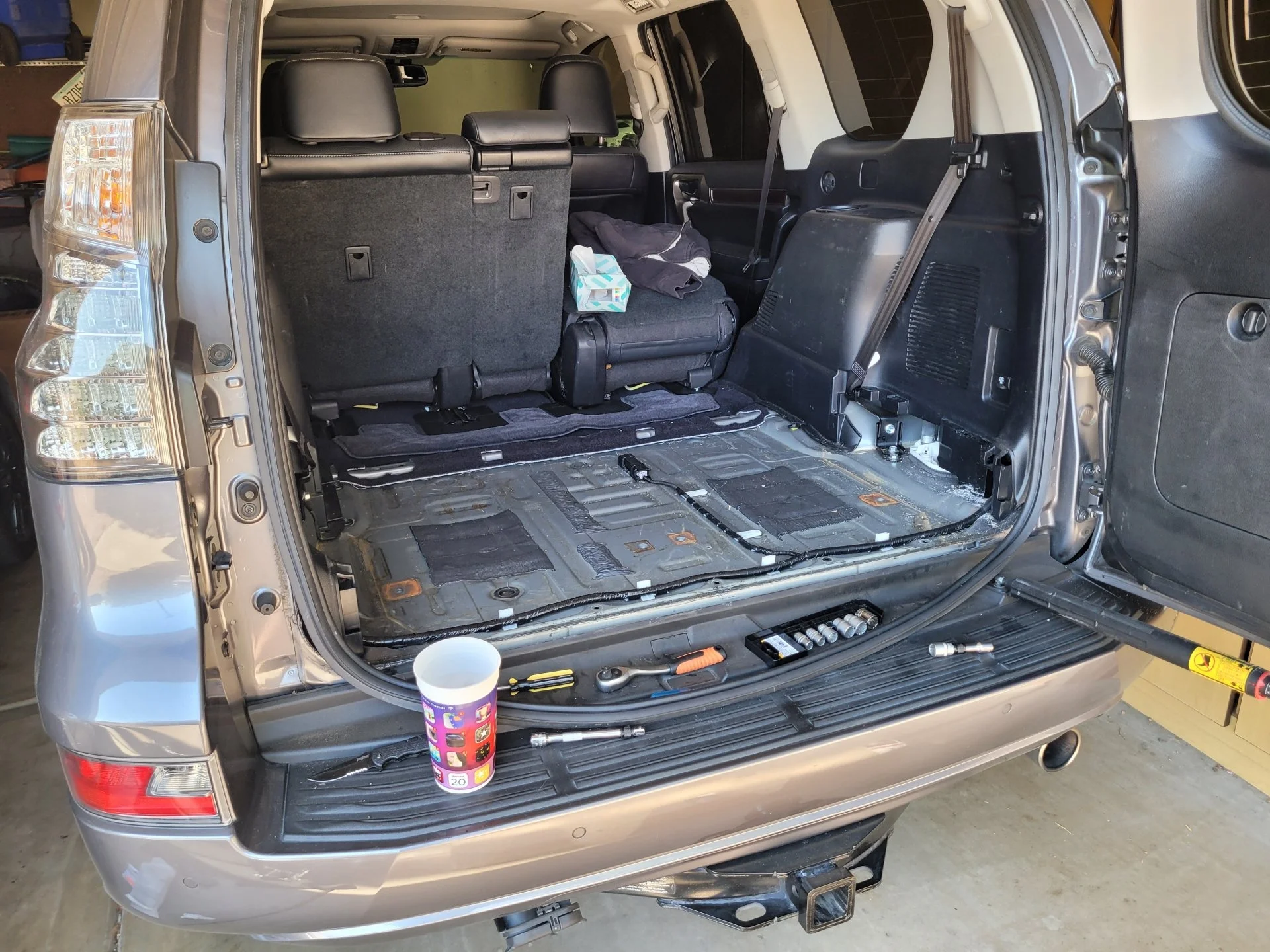

Got the Goose Gear 3rd row delete kit installed today. Good looking kit, but didn't come with instructions and the hardware supplied wasn't great. I ended up using a better set of long black bolts as well as black wood screws for the side panels. I didn't attach the side panels to the main board. Also for those installing this kit - the metal brackets will need to be bent upwards in order to line up with the holes they bolt up to. Not sure why they weren't shaped correctly from the manufacturer but it's easy enough to do.
I don't see a point in keeping the rear seatbelts anymore.. Any suggestions on how to remove the top piece that holds the retracting mechanism?

What vehicle lift is this? What is the maximum weight it can lift?
Remove the side panels to gain access. I left mine in and just zip tied the buckle in place.
