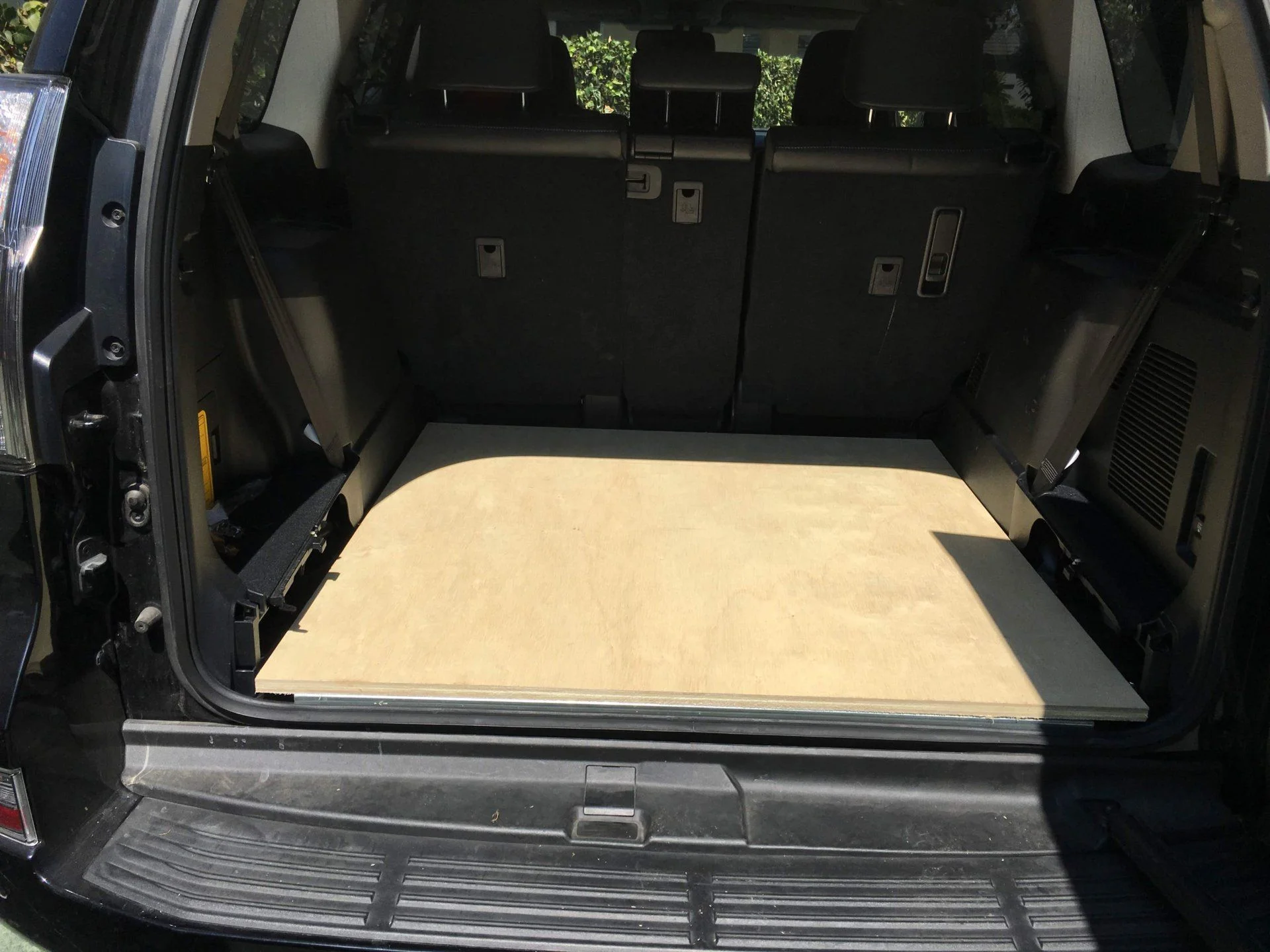

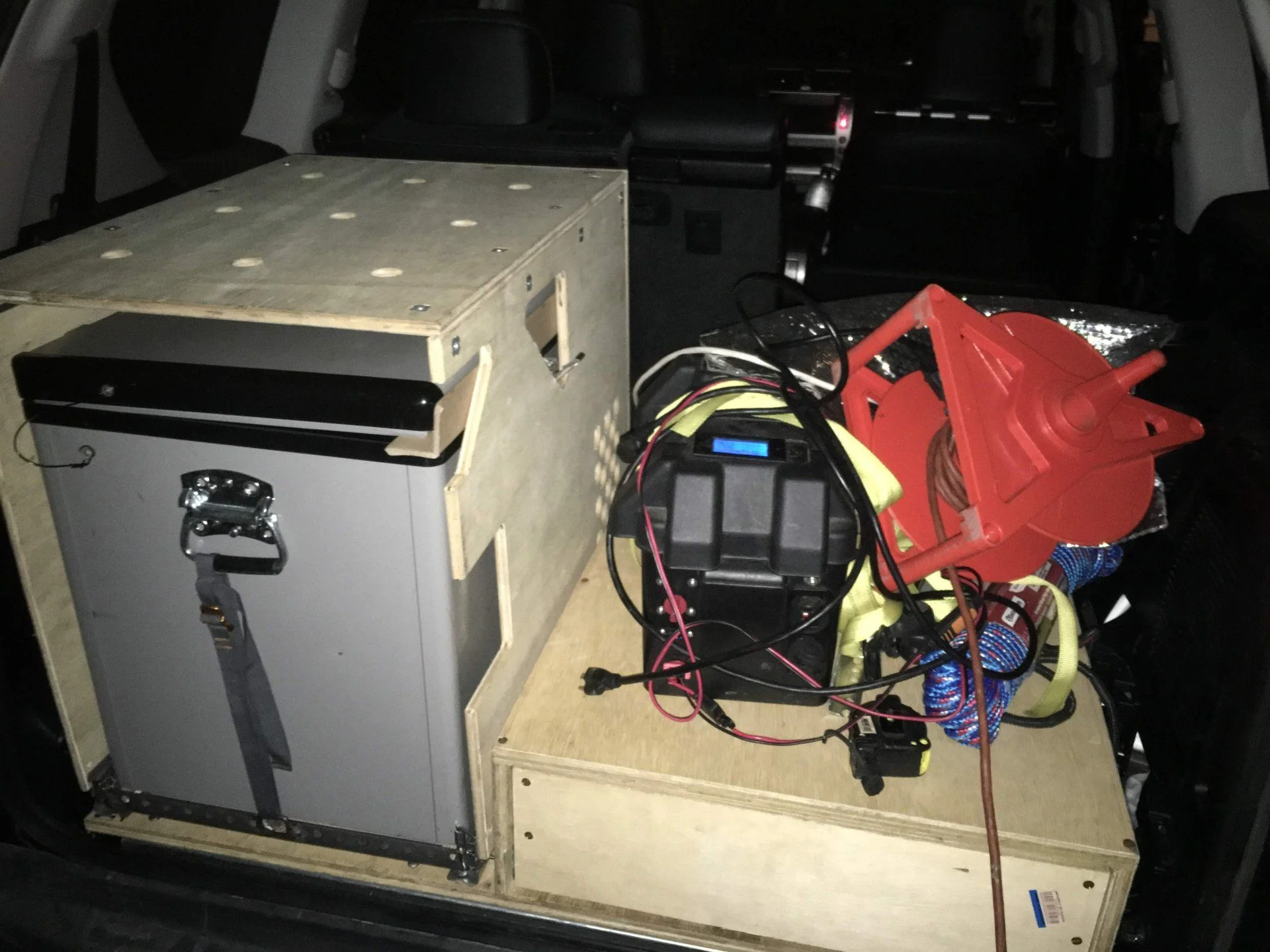

I am watching your thread closely. I am headed in the same direction with my vehicle, but on a budget. I just finished a drawer and slide out last week on mine. It's not finished yet, I had to throw something together really quickly in time for Labor day, I'll have to go back and refine it.
