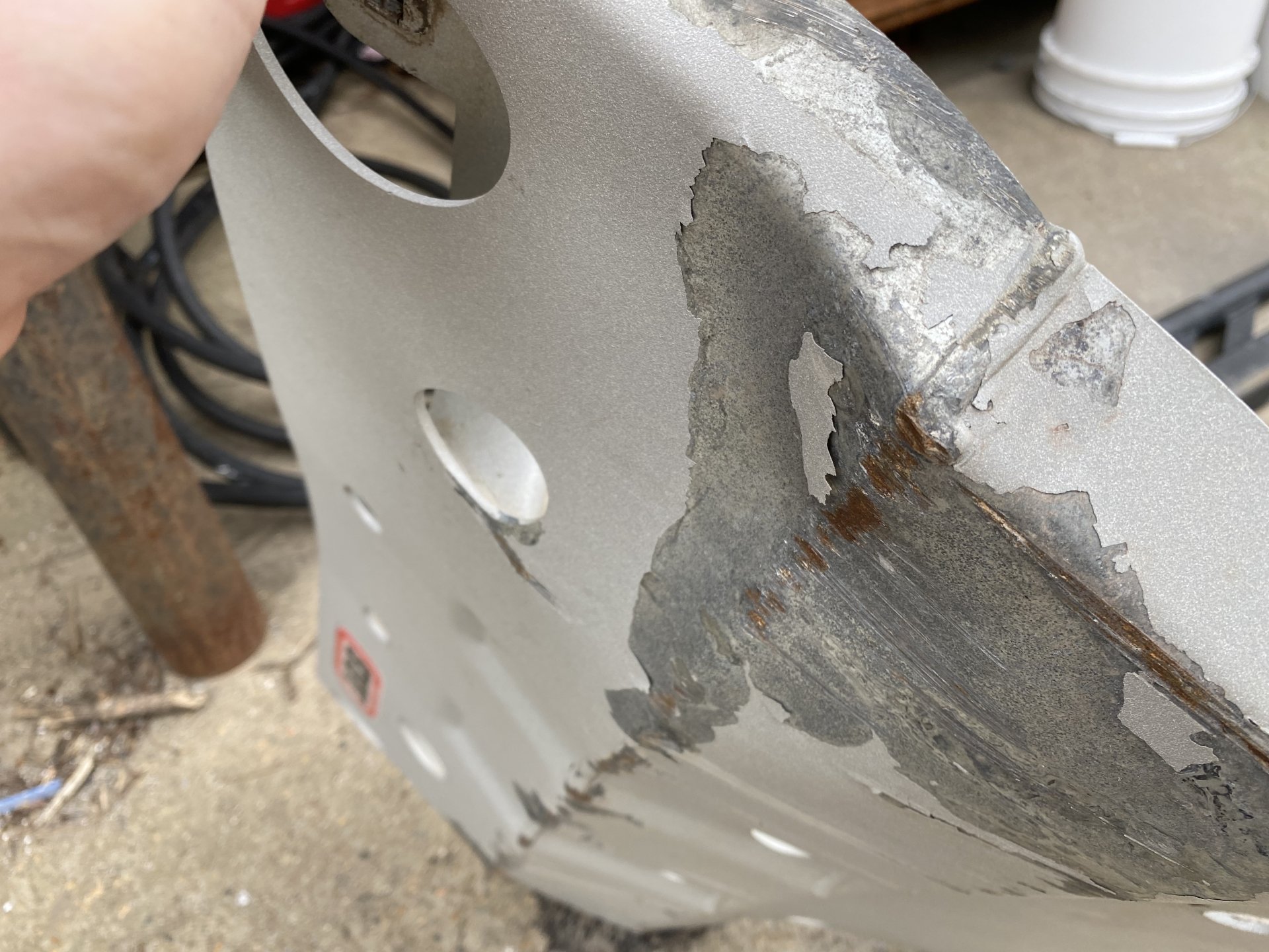

Peep this thread for my current skid build.
I recommend against 1/8”… hence the beefier build.

I would guess it would depend on what kind of wheeling you do as to whether you go steel or aluminum. I always say I'm not going to do stupid s*** in my rig and then I do stupid s*** in my rig. So, I went with the full set of Bud Built steel skids. Glad I did because in the first 2 trips I banged them up pretty good. To me, saving a few pounds on skids that are at the lowest point of the rig is not wise. Even if you have no intentions of wheeling in rocks, you may find yourself in a situation where you have no choice. Rocks and aluminum don't play well together. I just crawl under the rig (or if I can get it on my friend's lift at his shop) and spot paint them from time to time. As for mixing and matching, I have an Ironman bumper and the BB doesn't exactly line up with it but it's close enough. You can't tell unless you crawl under.
