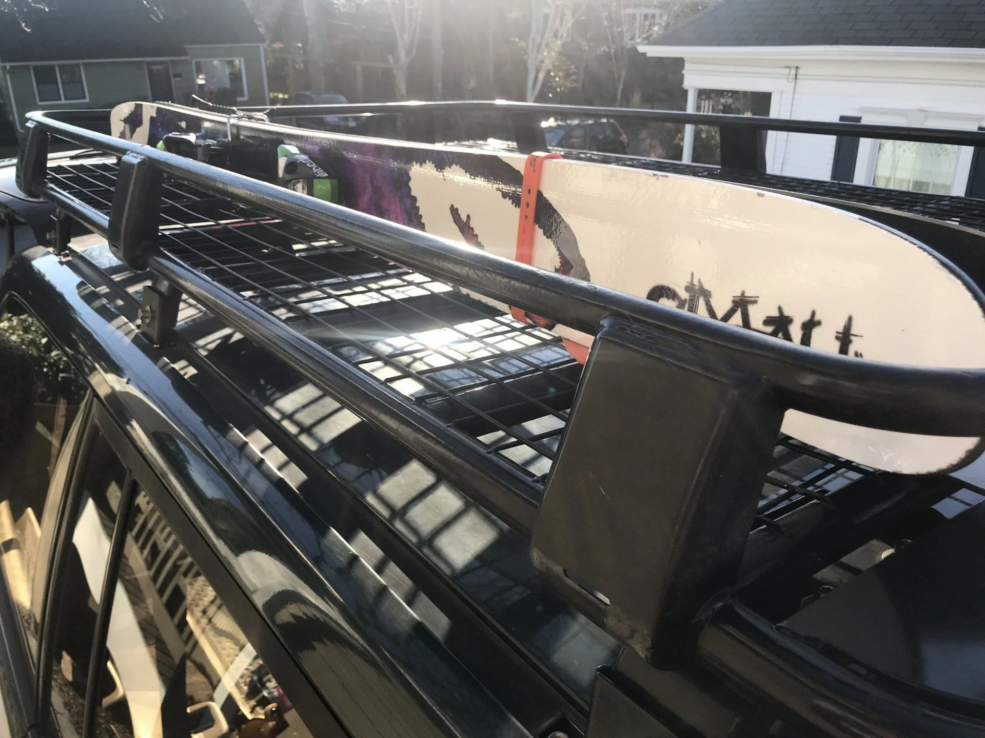

My LX470 has a knock-off ARB safari rack. I've been putting my skis inside the rig up till now with a seat down but a big family trip is coming up and I'll need to get two or three pairs up top to haul everyone inside. My 184-length skis fit nearly perfectly in the dimensions of the rack (see photo).
Want to keep this cheap but safe... (no skis lost on the side of the highway).
Thinking of either compression straps or mounting a couple sets of Quickfists to the rack and using a small bike/gun lock to lock them through the binding brakes.
Railgrabs seems to be no longer made. I have an enclosed ski box but I don't think there's any way to make it fit (has anyone done this with a Yakima Rocketbox?)
Any other options people are using? Advice? I'm aware that they'll get dirty up there... but this is a one-off trip and I'll risk it.
