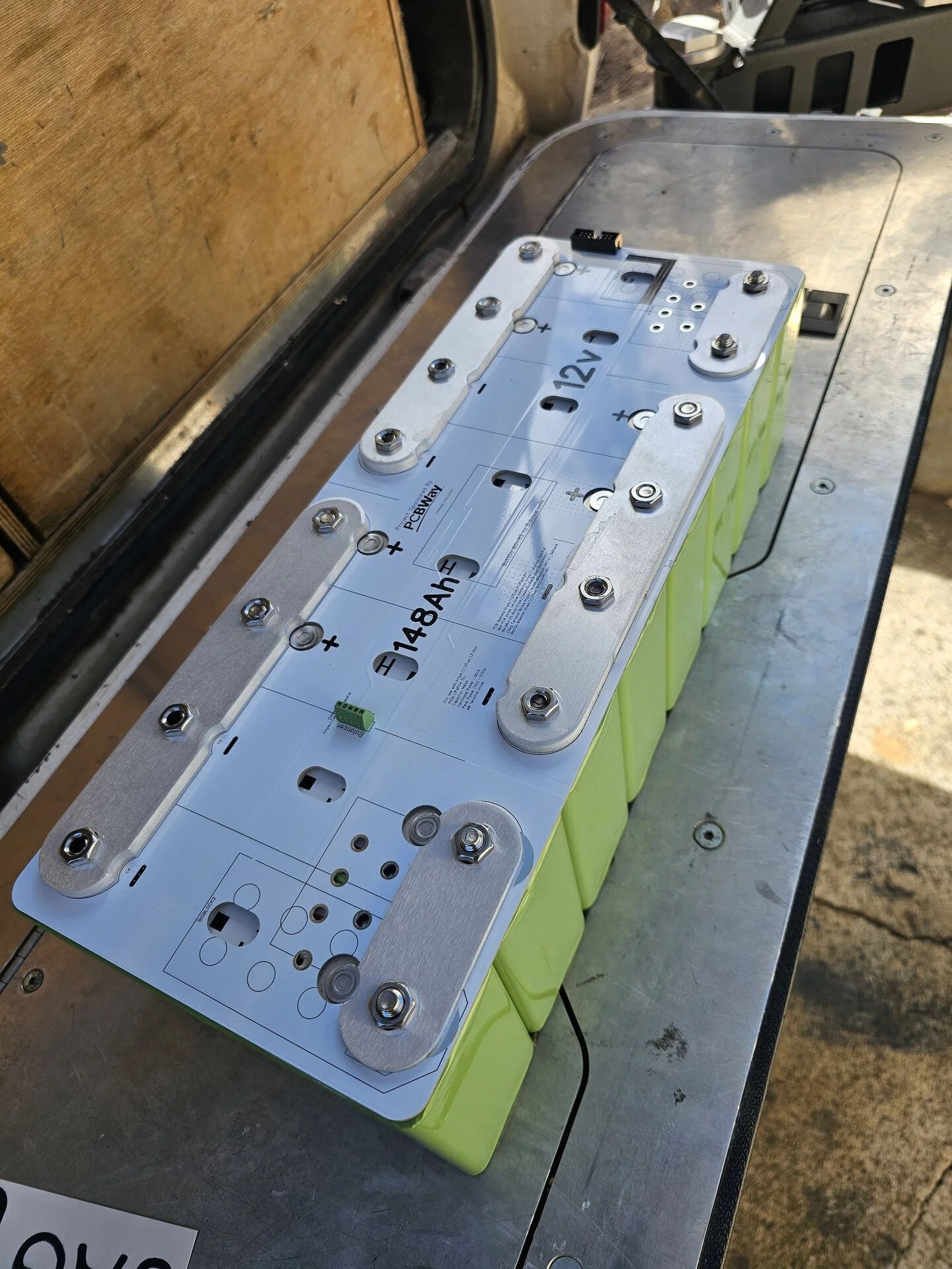

So here is the battery, and where I want to install.

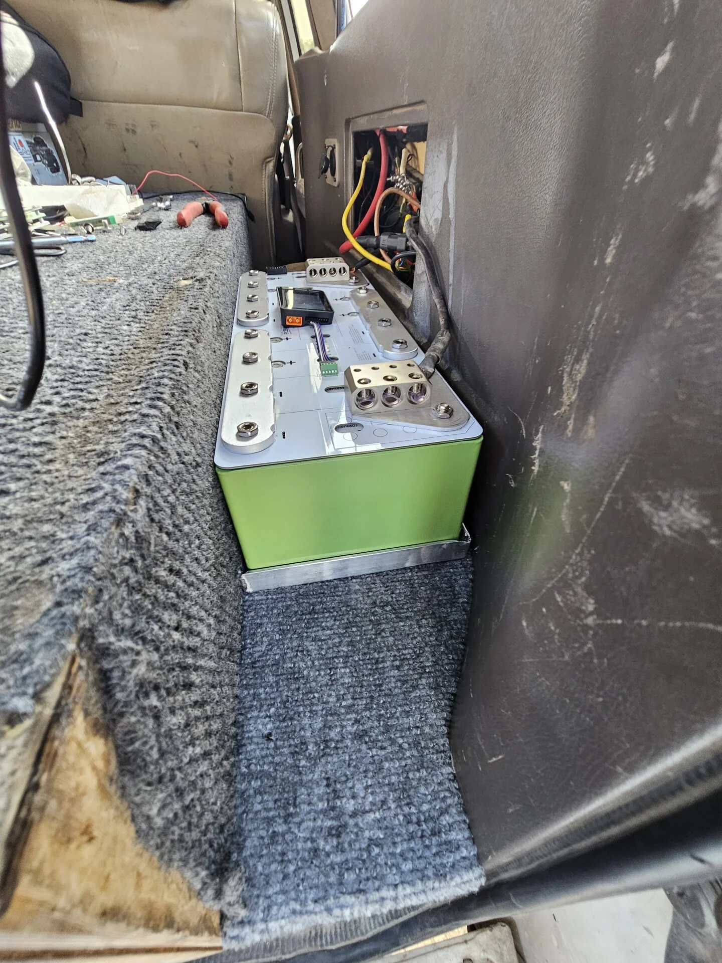

Down on the side of the drawers.
Building this platform for the battery to sit on.
Run a big ol cable to the engine bay, then have no batteries up there.

I made a platform for the battery to rest on, also starting making a battery holder.
Going to use the jag35 compression plates to mount instead.
I removed the old battery I had on the qpm and hope to put in a twin arb style in place. I have a morrflate 10 6 in the drawer now.
It seems odd to me that the bars linking terminals are all beefy thick, but the two plates at the connection ends are half as thick.
I have no idea if that's significant in any way. Just see it as odd 😄
They talked about it in videos, they said something about it only connecting two batteries and not four.
They have done some thermal testing, with a flir like camera.
I'm sure they know more than me.
My brain says all the current from all the cells passes through those two end terminals. But that's maybe a simplistic view?

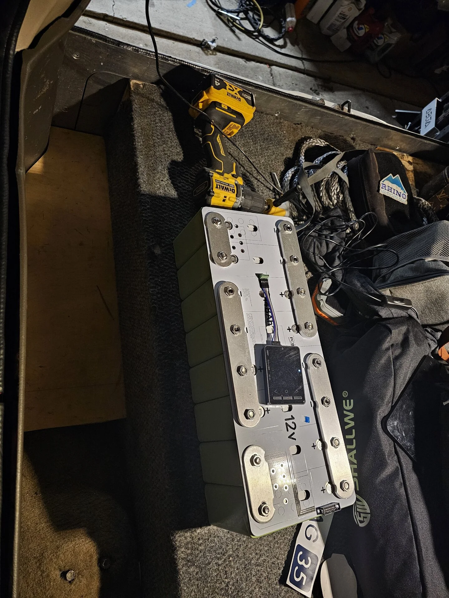

Temporary wiring charging system is working
Wagan Tech dcdc 40 amp with monitor
And inverter is underneath.
Monitoring the charge and discharge today. While working on Halloween helmets.
