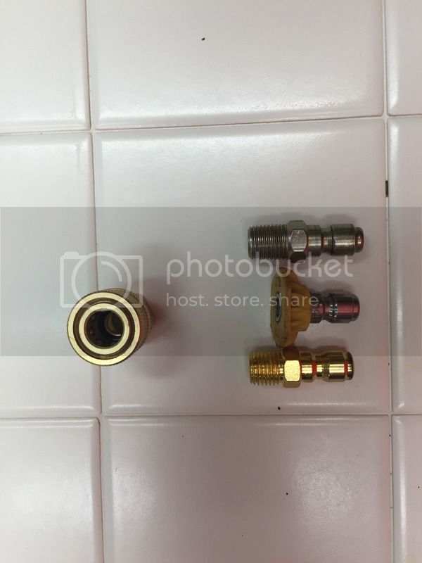

When I first tried to attach the new head, the male quick attach on the blaster head, had too long of a collar to mate with the female end on my wand. A quick trip to home depot with the part in hand allowed me to buy a replacement male end that would attach to my pressure washer for $10.
