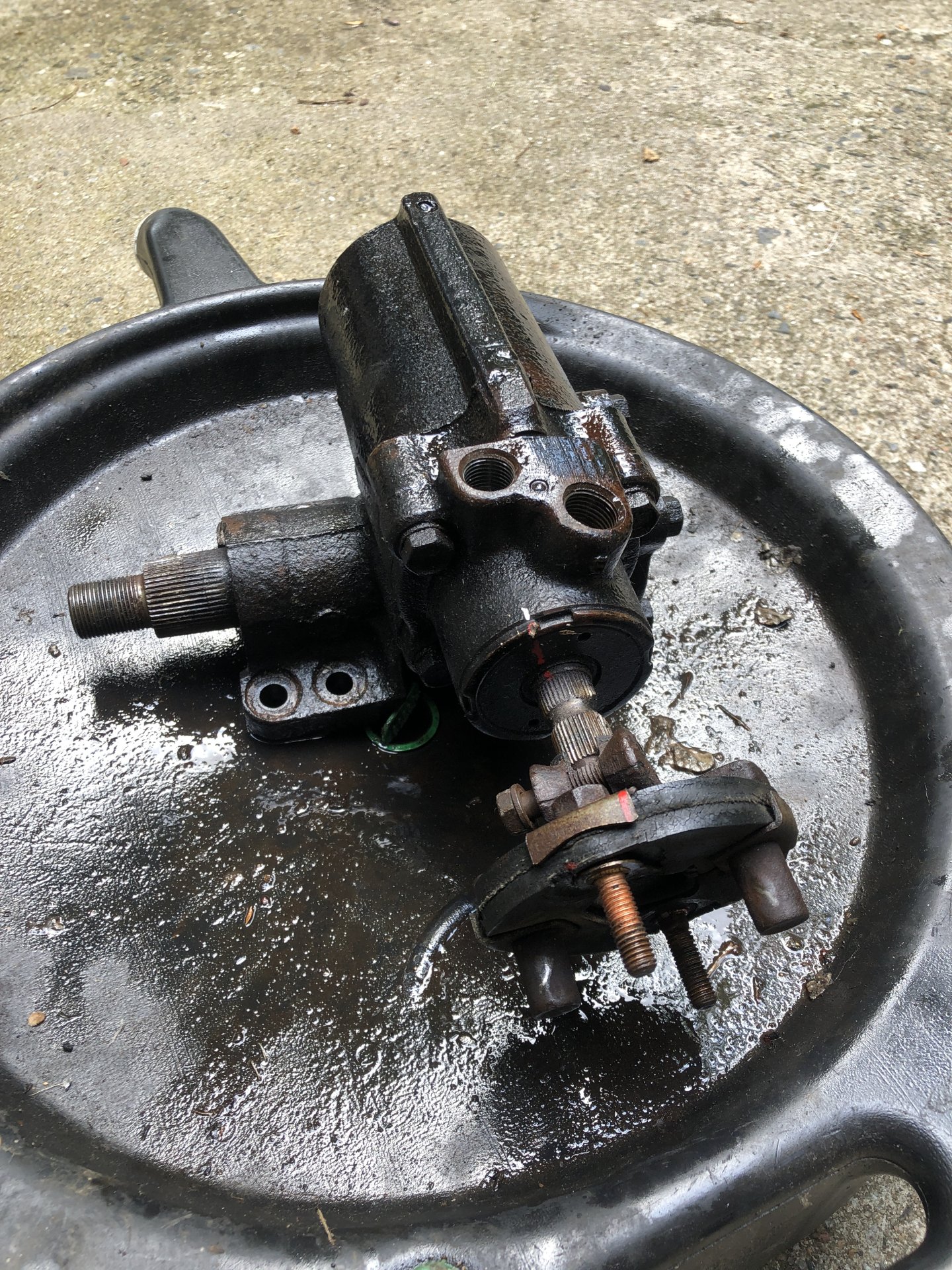

In the pictures, it appears to have some age on the joint. (what might early start of break down of the leather/rubber doughnuts). Have you considered replacing it while you are in there? [i.e., re-start with a freshly rebuilt steering box and any other convenient hardware with wear such as rag joint]

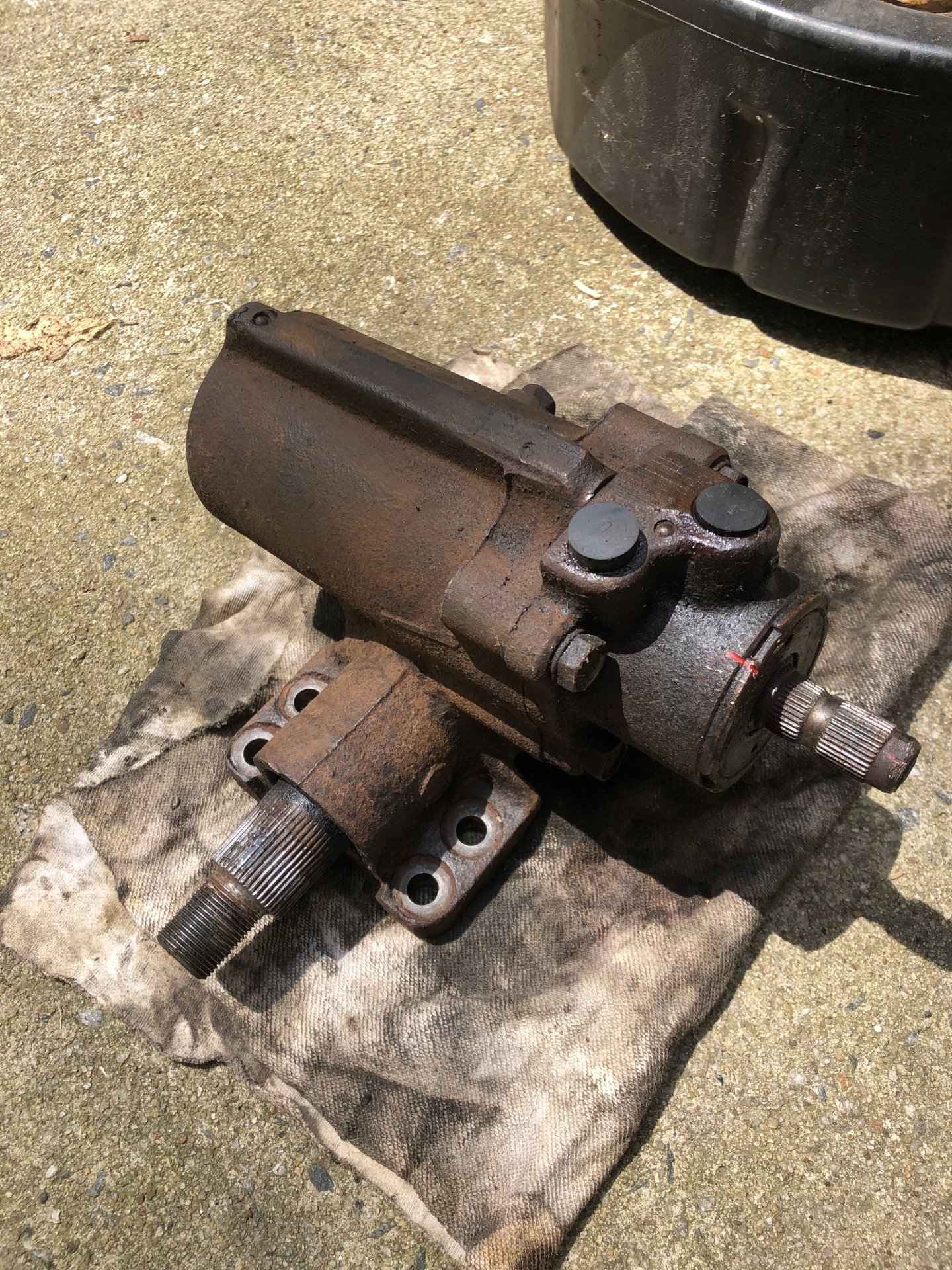

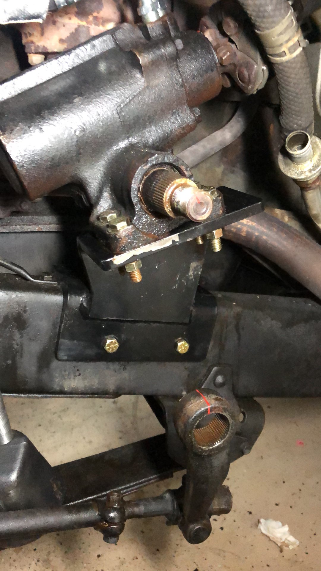

Just a small update…everything went well with the conical type puller and didn’t even produce a loud ‘bang.’ Just gentle tapping on each side of arm, a few twists of the puller and repeat. Made hash marks (in red) just so I can get it aligned correctly when I reinstall…not sure if this will help or not.

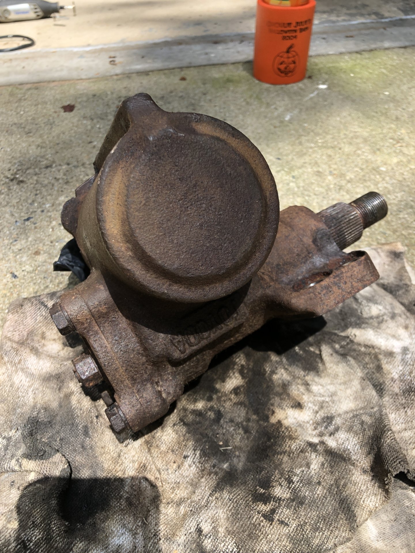

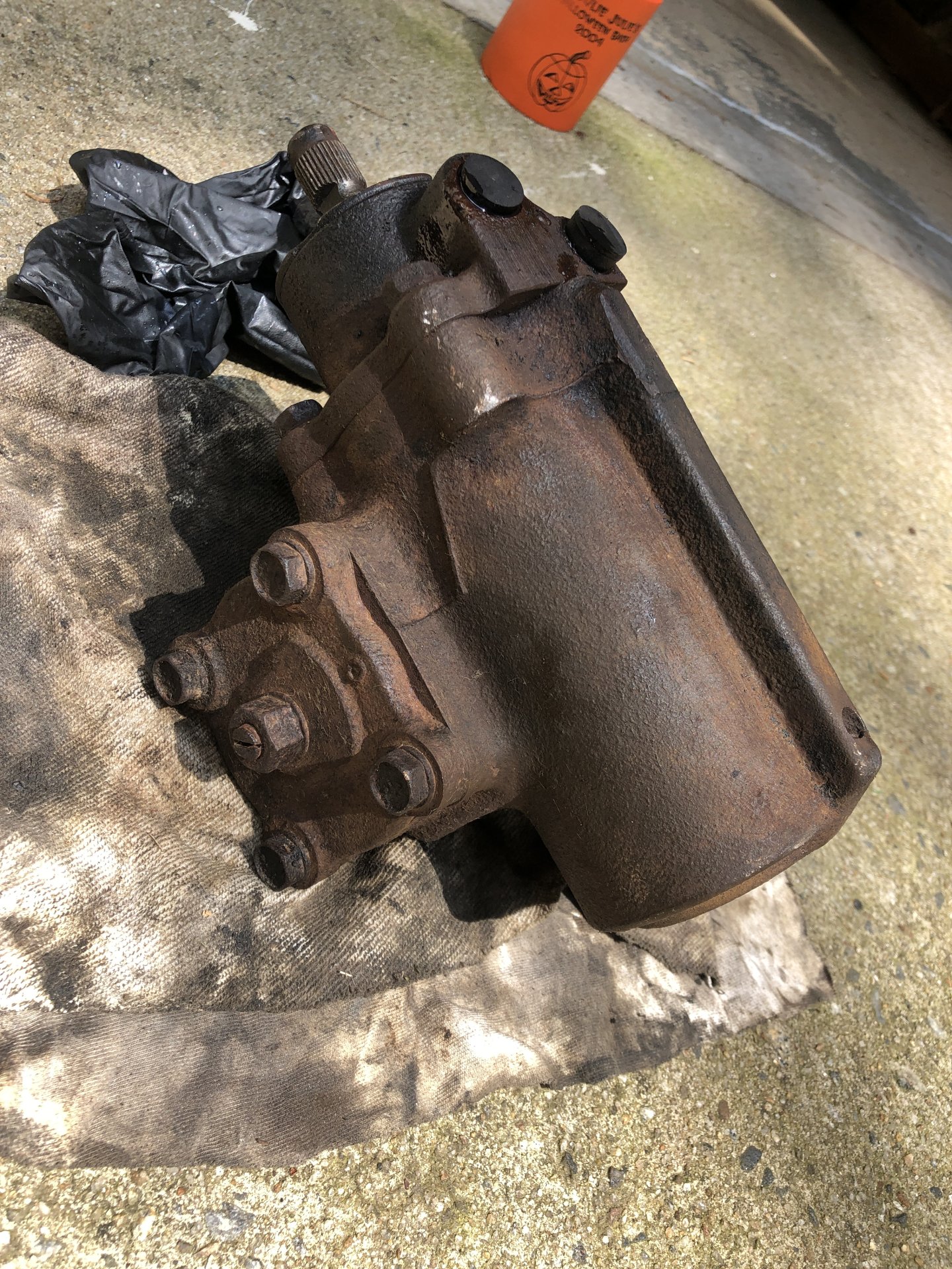

Unfortunately this box was supposed to be refurbished by PO and it was clearly not. So now it’s to get it cleaned up and shipped out to West Texas Off-road for a complete rebuild.
Just to let you know, the odds of your markings still being there after the rebuild are slim. They will probably clean thoroughly the housing and Pitman arm shaft. You might consider using a punch to leave a small divot on the end of the shaft and pitman arm.
