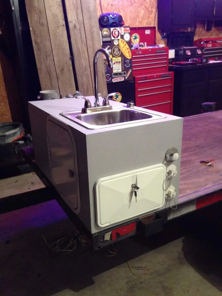

Here is my soon to be finished trailer and accessory, Hot Water Box, 6 gal water heater, sink and outdoor shower!

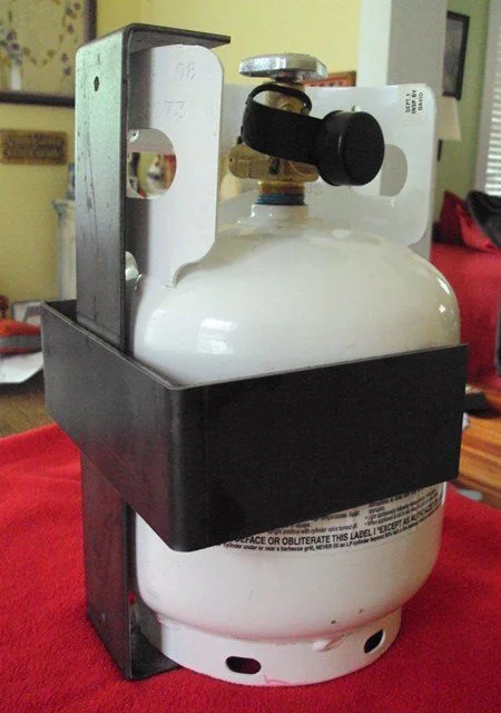

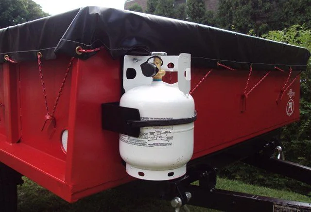

Made a hanger for my 5# propane tank " I was too cheap to buy one.
Brake pressed a U shape to hold the sides and an L shape to hold top to bottom.

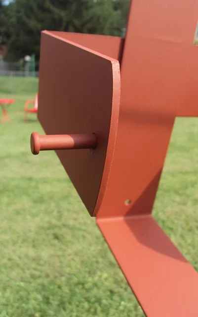

Two clevis pins to hold a bungee strap and a bolt through the safety lip to lock it down.

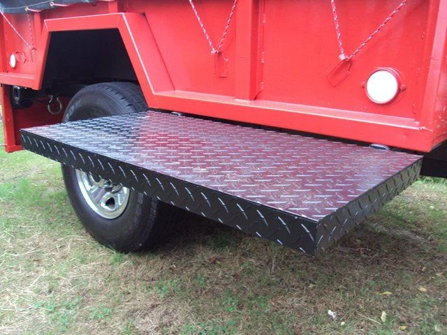

Mounted two 1 1/4" hitch receivers under the tub to hold a diamond plate cooking area.
