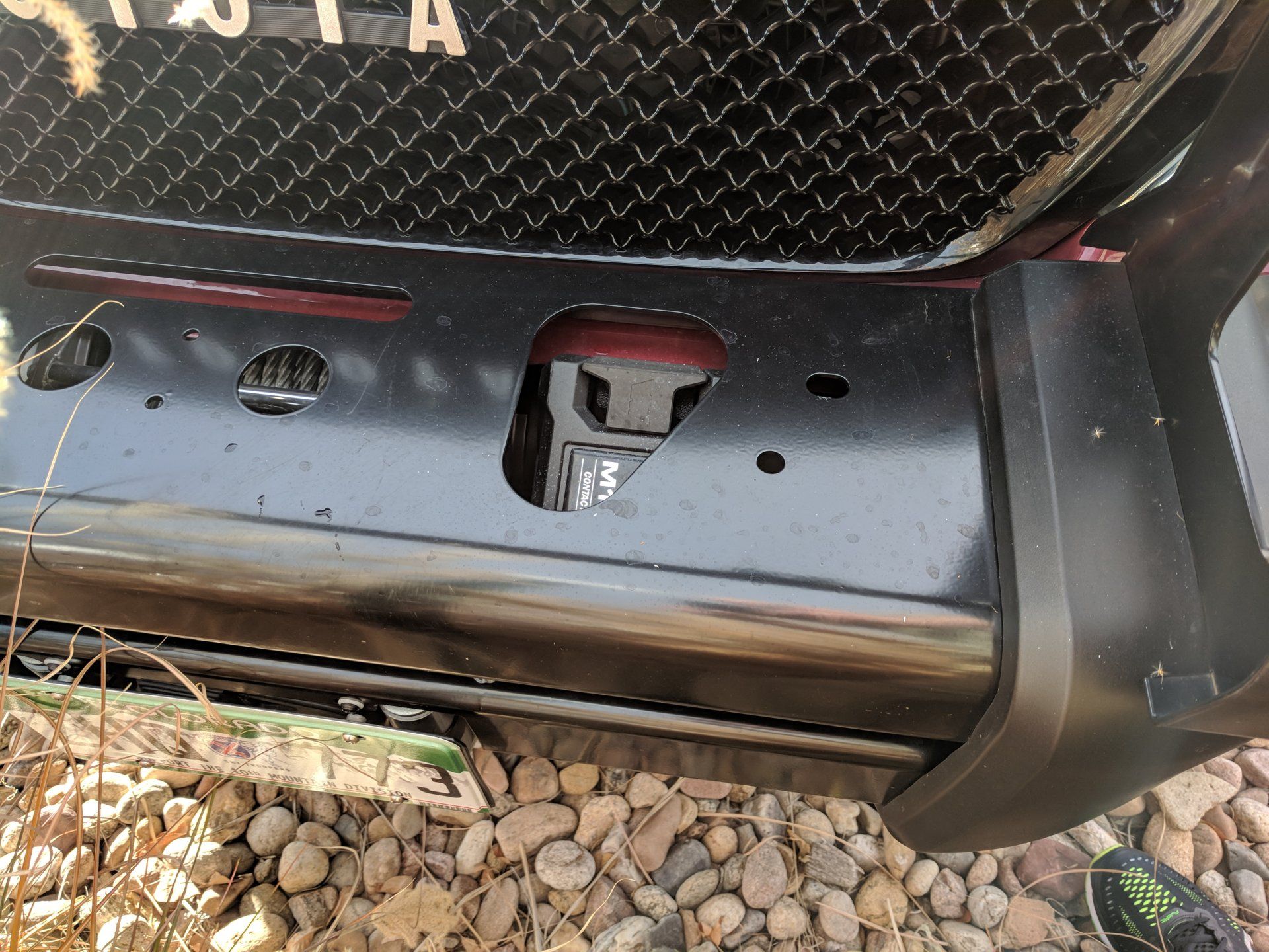

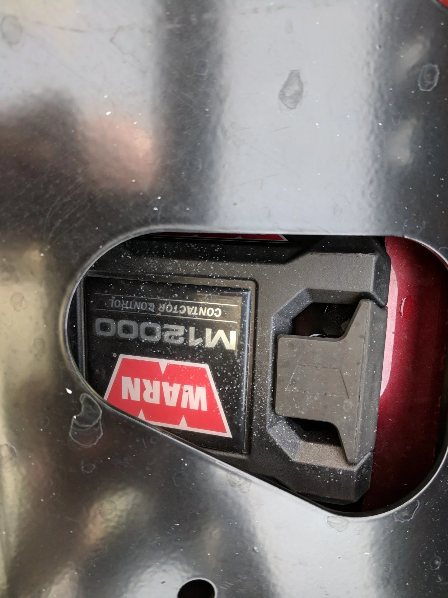

Warn M12000 on an ARB Deluxe bumper for my 2011 LC. Slee did the install and was able to make a simple bracket for my combo. YMMV.

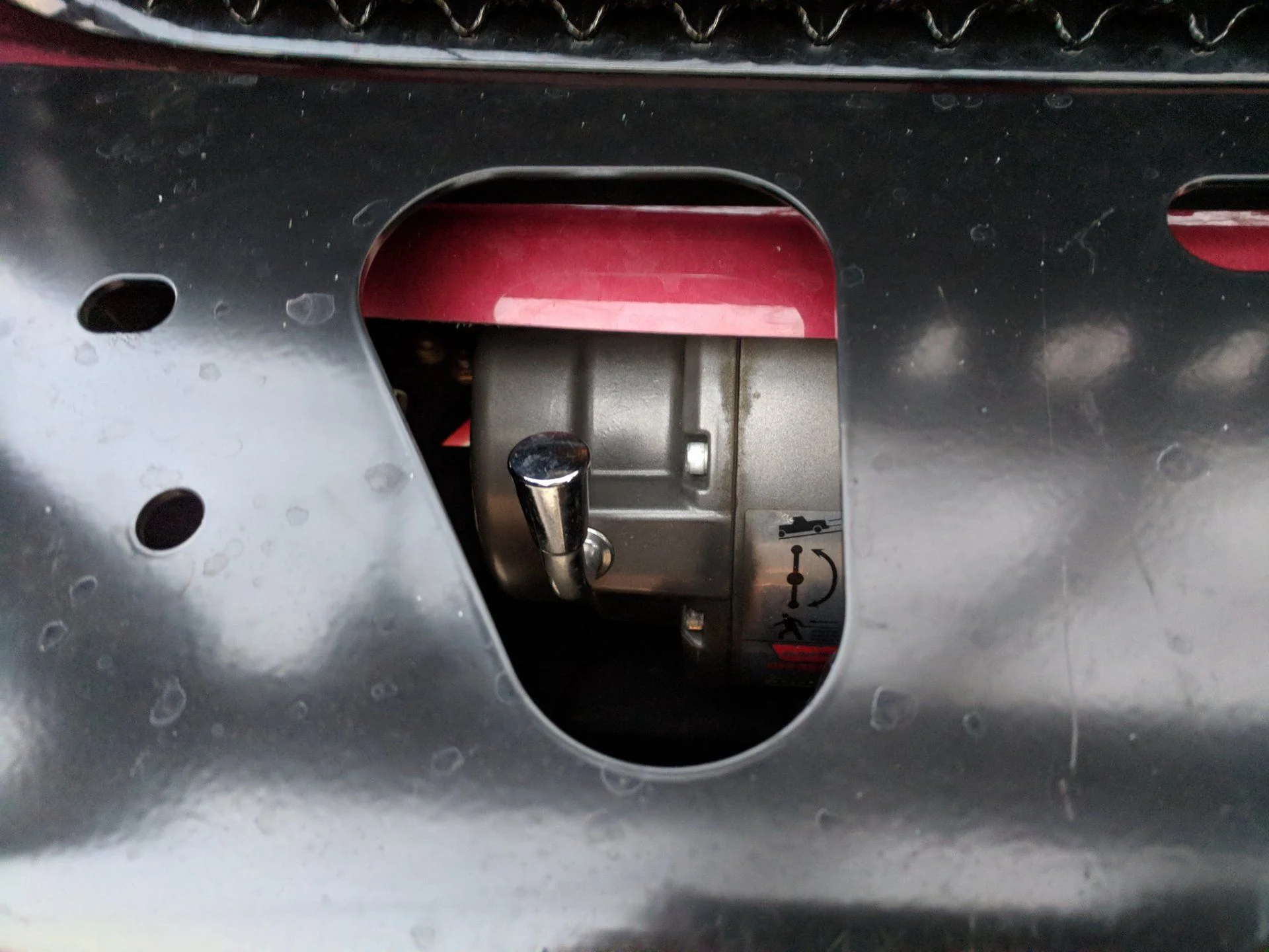

That's pretty slick. How do you engage the clutch or is it clutchless?
There's a 'trapazoidal' (?) shaped opening over the clutch arm just like the one over the contractor pack plug. I'm sitting at the world's longest red light on Colorado Blvd otherwise I'd send a pic ;) but hope that answers your question.
Edit: pics of clutch lever added

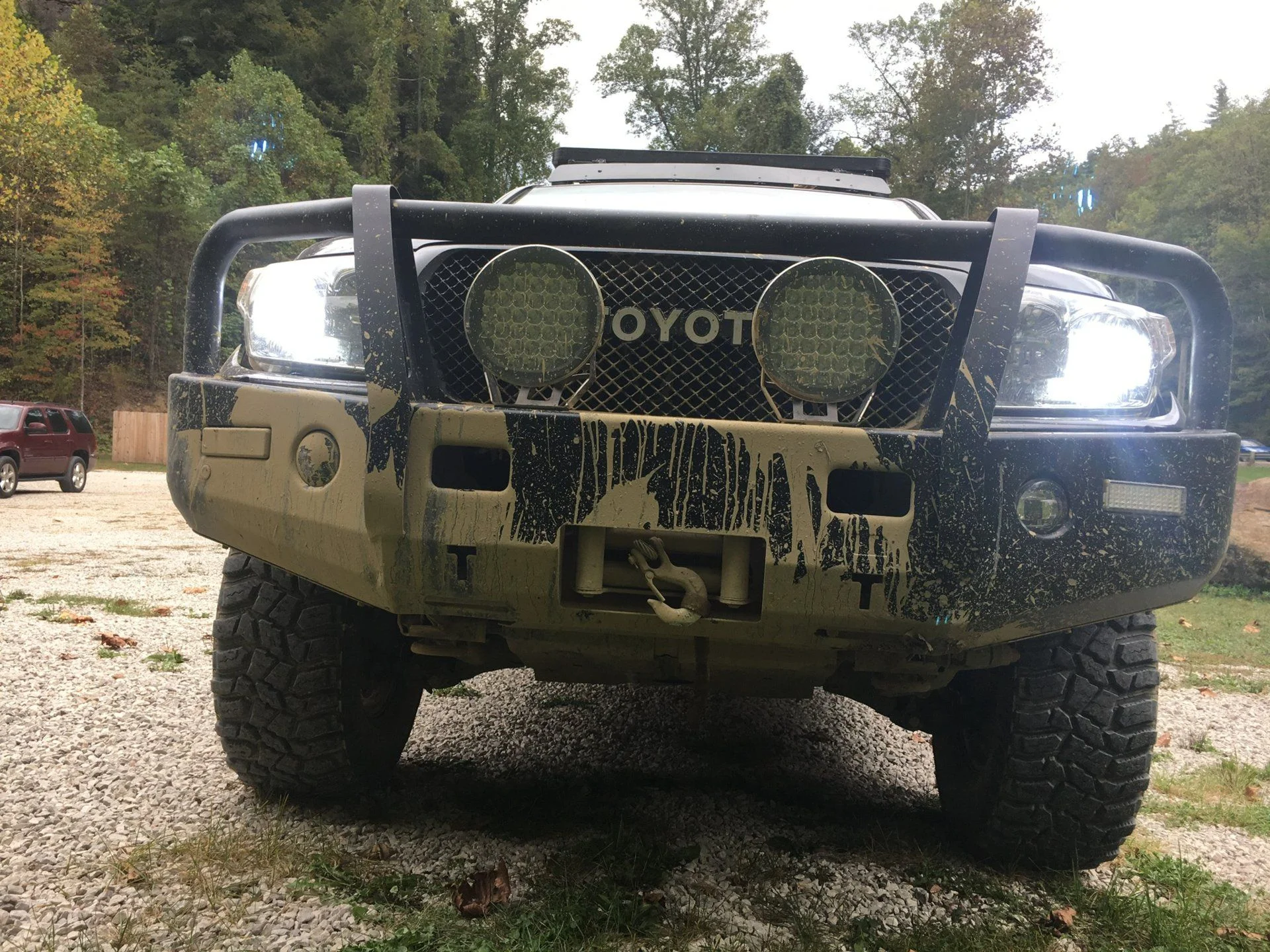

Warn zeon 12 platinum. No relo brackets needed It all fit and wireless remote. I like it
