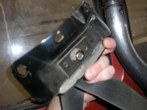

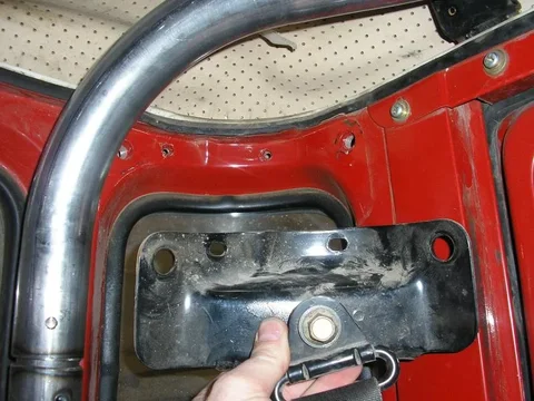

I am moving mine from the hard top to the roll cage - I won't need the original brackets anymore :grinpimp:
I can get some pics later this evening - I'm running out the door right now.
no better pics, but hope it helps
Cheers
Peter
Awl, just sent you a PM
a.greenspan Thanks for the pics. What type of belts are those?

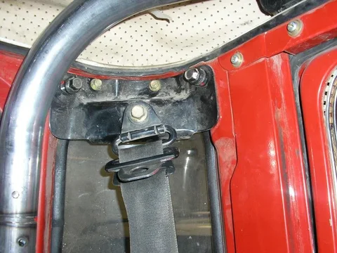

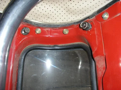

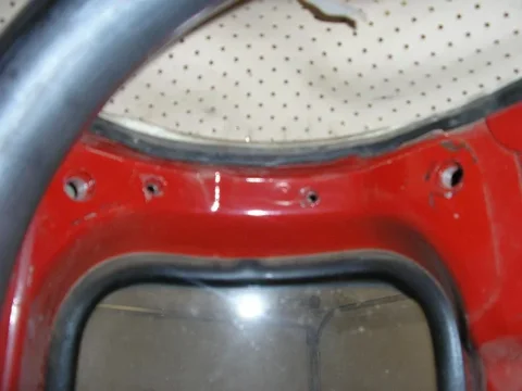

These are my shoulder belt mounts from my 1978 Canadian spec. FJ45 LPB... possibly soon to be yours :D
Threaded bosses in the top..
A couple of M12 bolts and two smaller (M5?) bolts
Just to be clear - I am keeping the belts but your welcome to the brackets

1973 Toyota factory 3 point seatbelts .
Co-driver belt is a 3 point static belt (factory)
Both belts are not very useful !!!
The upper shoulder belt mount points (factory) in these FJ45 pickup cabins are dumb, same dumb thing in Awl_TEQ`s 45 I think. :rolleyes:
These Toyota mounted belts are unsafe at any speed, they mounted them only because the law

I agree they are not perfect but they are original to the truck. They few times I wore mine (I should say the few times I actually drove my truck, I always wear my seatbelt) it wasn't uncomfortable. I believe the law around here states that if the vehicle came with them from the factory then they must be present to be road worthy. I also think you can upgrade to a four or five point harness, but you can't downgrade to a lap belt only. I'm not with the Transport Canada so don't take my word as law :D.

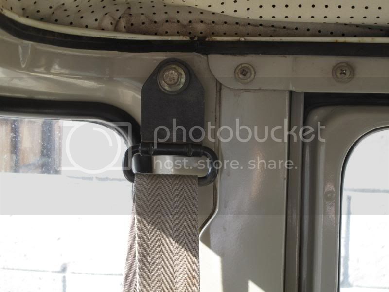

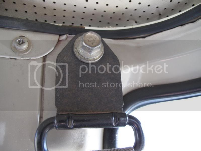

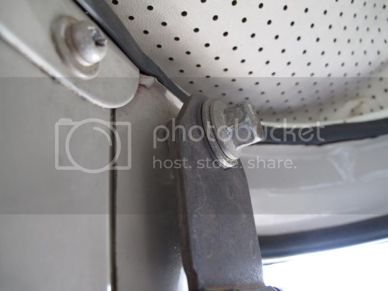

Here's another few pictures for frame of reference. These are from my 1980 HJ45. They also have a single captured nutsert in the pillar. Interesting change from Awl's to the 1980 vintage.
The first two are close-up's of the driver's side and the third is the passenger side. Which I guess because it's RHD, it doesn't really matter.
Keep up the good work, I'm enjoying your build.

Did you HJ already have the nutserts on the pillar for these belts. I just got some retractable belts thinking I would install them this way. The PO had them install on the screw to the left in your image below. Which obviouslywouldn't be as solid as that large bolt. I have a hole in my pilar where your belt is mounted, but its just a hole, not threaded nut.

While a old post (five years) I plan on using the Canadian style in my 65 FJ45. Since I didn't have any fixed nuts I plan on using nut inserts instead cutting the top and install a fix nut then weld back together. Besides having four inserts instead one to hold the bracket it's also in rounded section which is stronger than flat metal. I'm am curious if the brackets I bought from dr_claw are the ones off Awl_TEQ truck.:hmm:

I haven't looked in a long time but I recall the bracket just bolting in with about 4 bolts. It bolts into the side(corner) panel at the top edge and has no affiliation with the hard top cap that I remember. But I rarely remember things anymore. Or I remember them differently than they happened.:oops:
