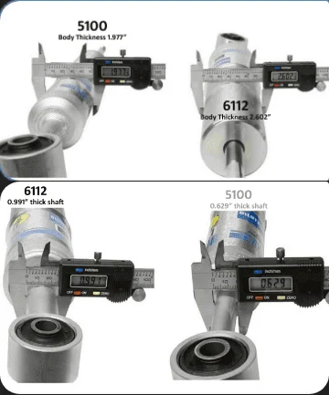

I think there's a lo of chatter the 5100 is inadequate for the mass of the GX. The 6112 is a better fit...
These images are from a build here on mud:

I read in an Australian vendor web site that the Dobinson shocks have a 56mm external body oil reservoir (2.205”) and a 18mm piston rod/shaft (0.708”)
This is just using information from the internet...
