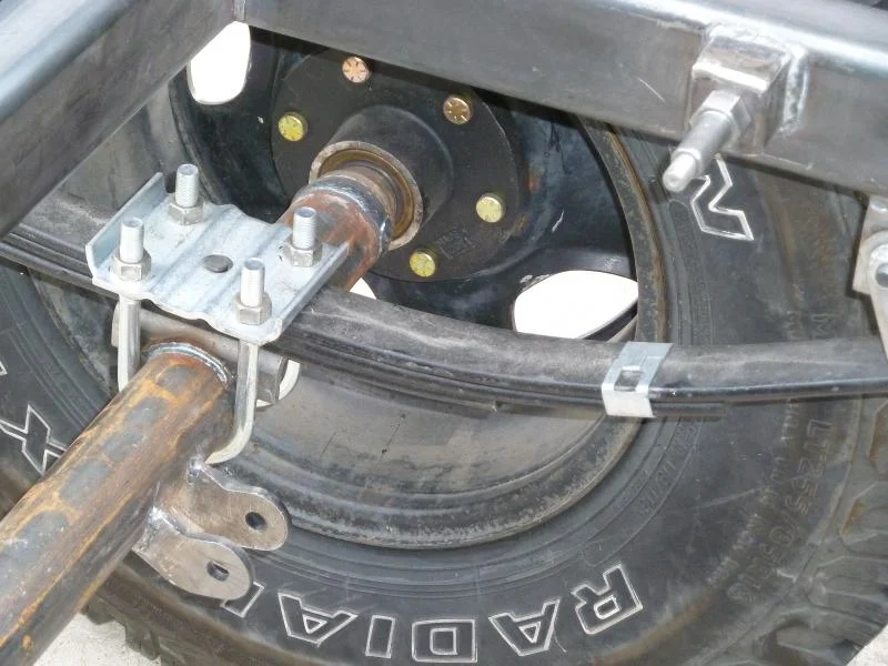

For a rubber torsion axle you can see what was done @ Vta 4x4 for the lower mount here:
Those are just a pair of the garden variety shock tabs welded onto the rear of the trailing arm. For leaf springs I'd suggest placing the lower mount as close to the wheel as is reasonably possible, and that they be within 10* of vertical if at all possible. Lay them over approaching 45* and there's no point in bothering as they'll have very little damping control

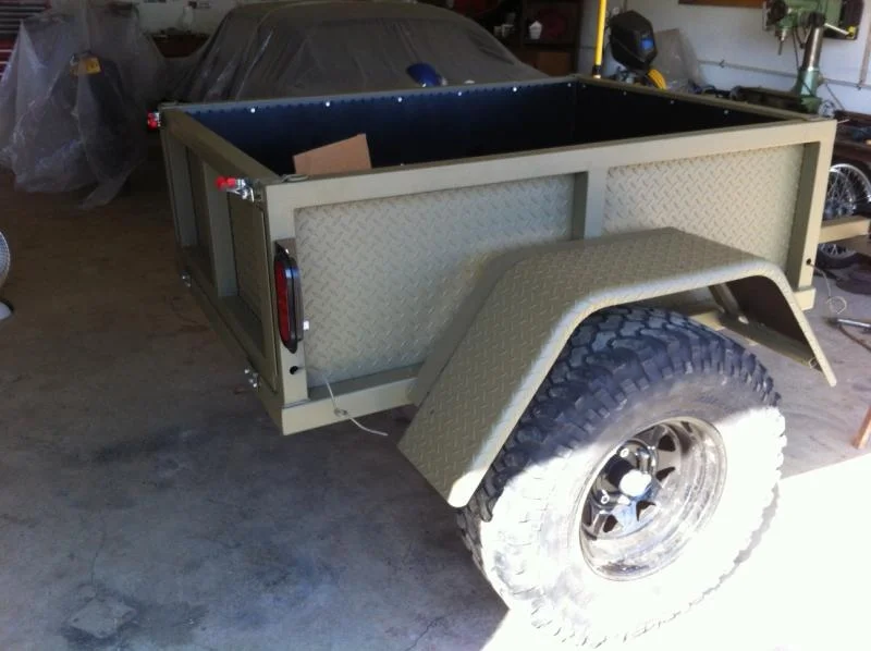

My trailer is currently back with the builder for fabrication for shocks and electric brakes. Also adding a 28 gallon aluminum food grade aluminum water tank under the belly and a sleuth of other modifications.... Should be ready in about a week. I am very excited.
I've been following this thread because I'm having the same dilemma with my project. Thanks for the shock link Drew. Do you happen to have a pic of how you mounted them on your awesome trailer? I think we are running the same axle/spring combo.
That is one of the nicest utility trailers I've seen in a long time! Wow!

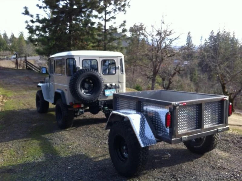

I didn't see...did you make those brackets or buy them? I'm building a trailer and I'm wanting to put shocks on mine too. Thanks!
~Daniel
oregonfj said:
I just fabbed them up. The shocks only come with one mounting bolt. I welded that bolt to a 1" square tube stand off and cut the lower mounting brackets from some steel plate.
Right on, great job...thanks!
