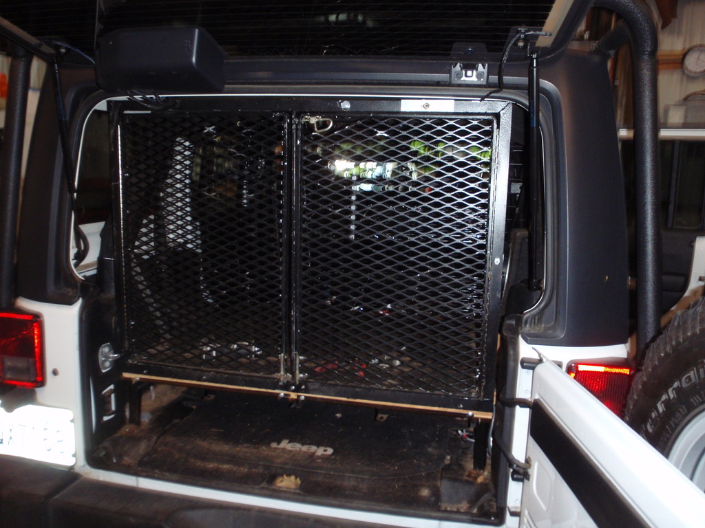

So a couple years ago, I built this - a divideable kennel for my wife's dogs
it always was a work-in-progress

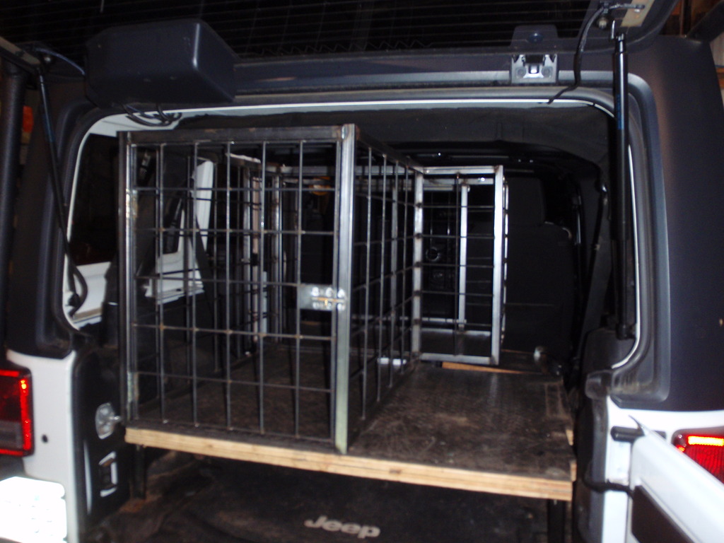

so as you saw a couple weeks ago, I built new kennels for the Heep.... today I started installing them

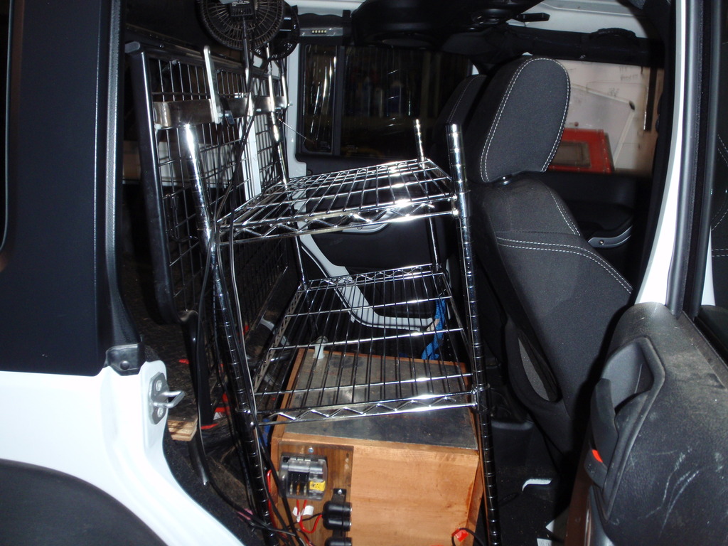

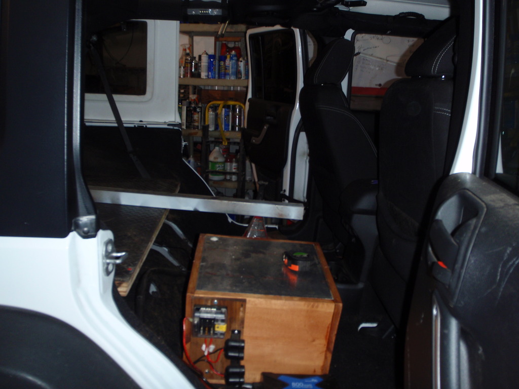

first was clean up some wiring
and move (again) the speaker
so here is what it looks like

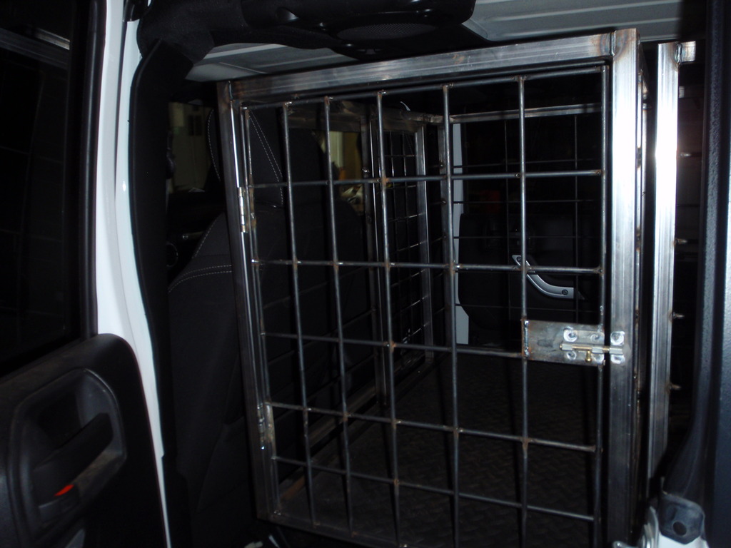

it gives my wife some flexibility - she can haul one dog, or two dogs and her older dog gets worried when she can't see where she's going - so the kennel allows her to be in front and can access the front seat through the middle
this also gives the benefit of when she loses her keys - that she still get the dogs out - you can get into the front, but you cannot access the rear gate without keys... which was a problem because that was the only way to let the dogs out....

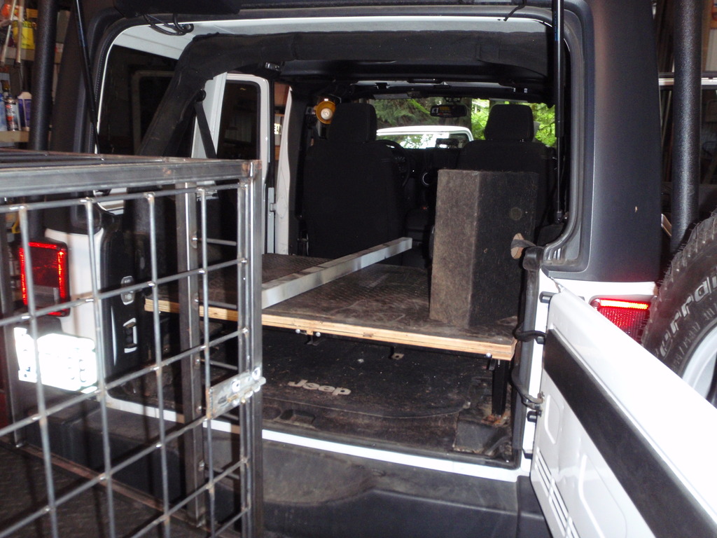

so I had my wife load her heep back up....
I'm going to do a drawer and a shelf and it should be done except for the extras
I know some think it's animal abuse to build a smaller cage for such a large dog - actually, it's only people who want extra space for a dog, it's all about defensible space. Not just that but should bad happen and they be in an accident, not having a lot of room is much safer

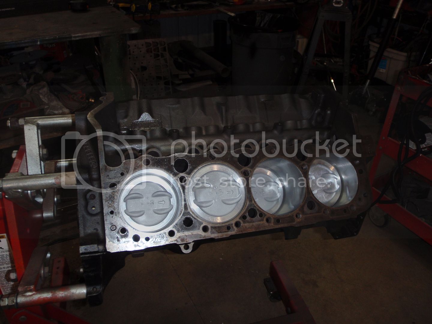

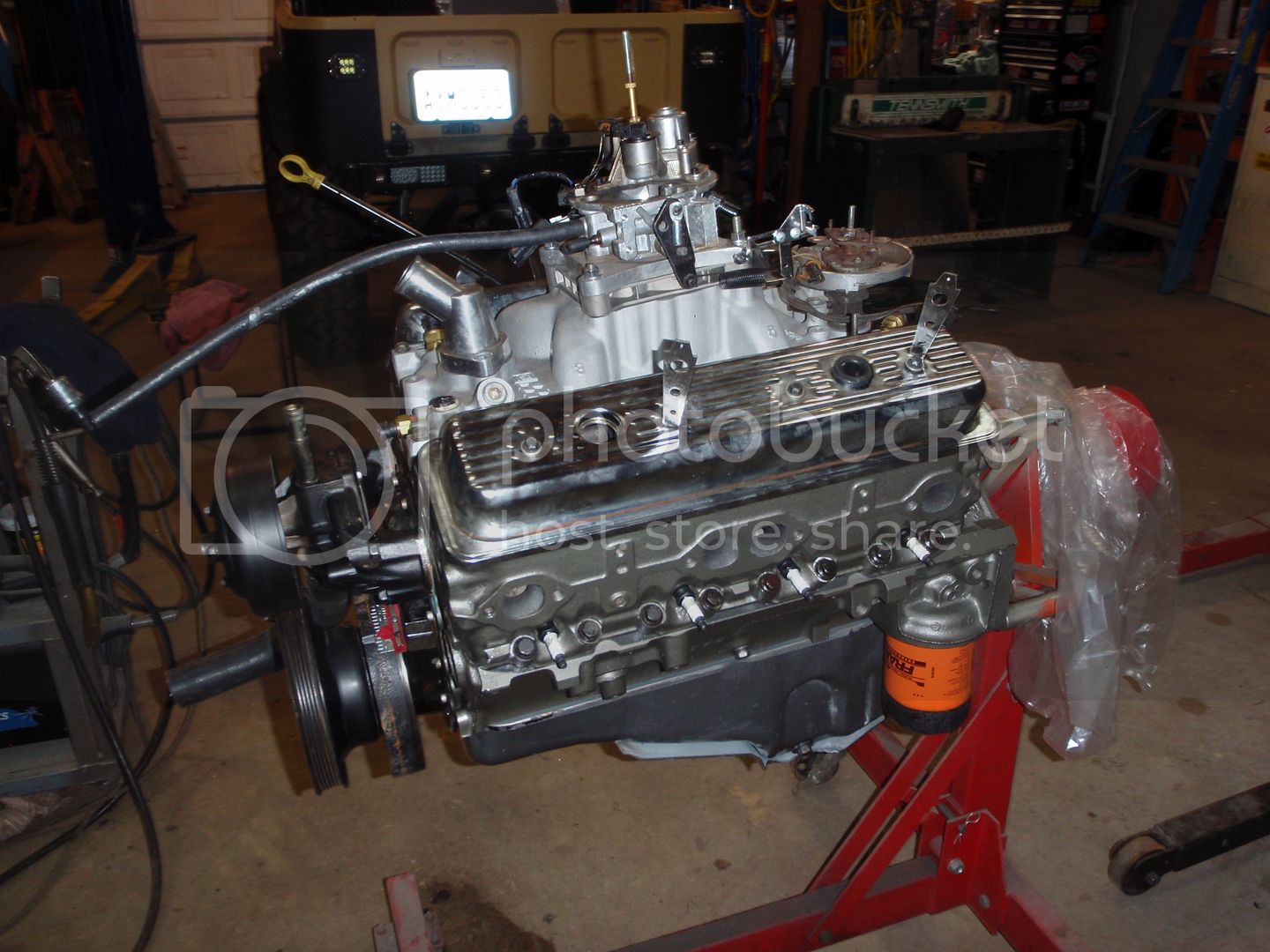

Buick motor off the stand

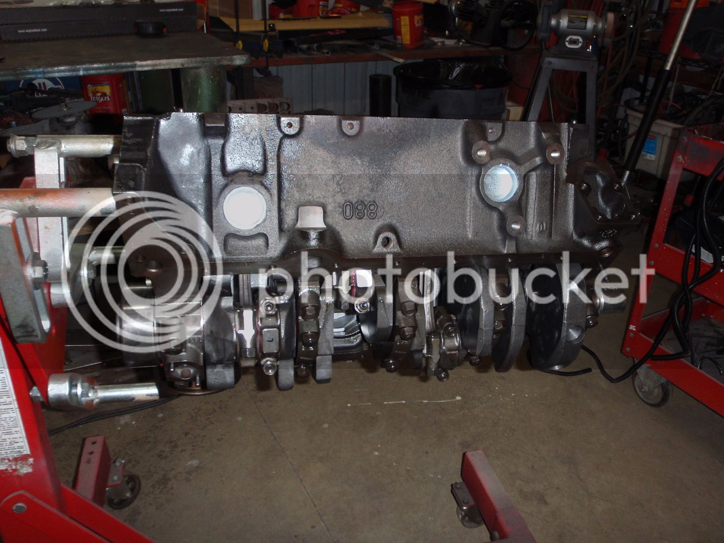

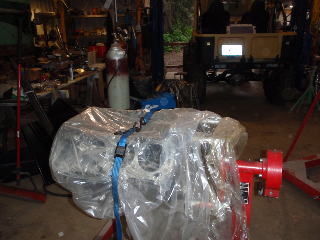

new 355 short block on the stand
The guy gave me a 4 bolt main, roller block instead of the 2 bolt....
grey is the color this time
I like what I got, and the shop who did the work was immaculate - always a good sign. Best of all, here's the cost break down
$900 tax included for the short block. If you look at my prior pricing, you'll see this is $200 lower than what I figured. Had I gone with building a short block myself, I'd have been at $1300 but worse, end of summer before the machine work was done. From the place off ebay, all in was about $1000-$1100 but I'd get a 2 bolt block. While I don't think I need the 4 bolt, it is a feature

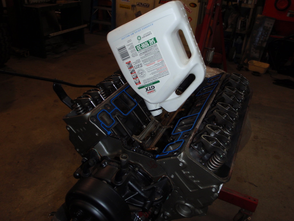

I was being nice when I told the builder that I didn't need intake gaskets because I already had some.... ummm, they must be in a very safe place because I can't find them. That said, intake gaskets pretty much require sealing the front and rear crossover with silicone
I have done it both way, use the provided gasket and just seal the corners or only use RTV. Since any deck work changes the intake to block gap I think RTV only is a good choice. As long as you don't have enough blow-by to blow out the RTV.
the reason I avoid the rubber intake gaskets is for that very reason. They work well for plastic intakes, but all it takes is one backfire with a metal intake and you have a vacuum leak.
