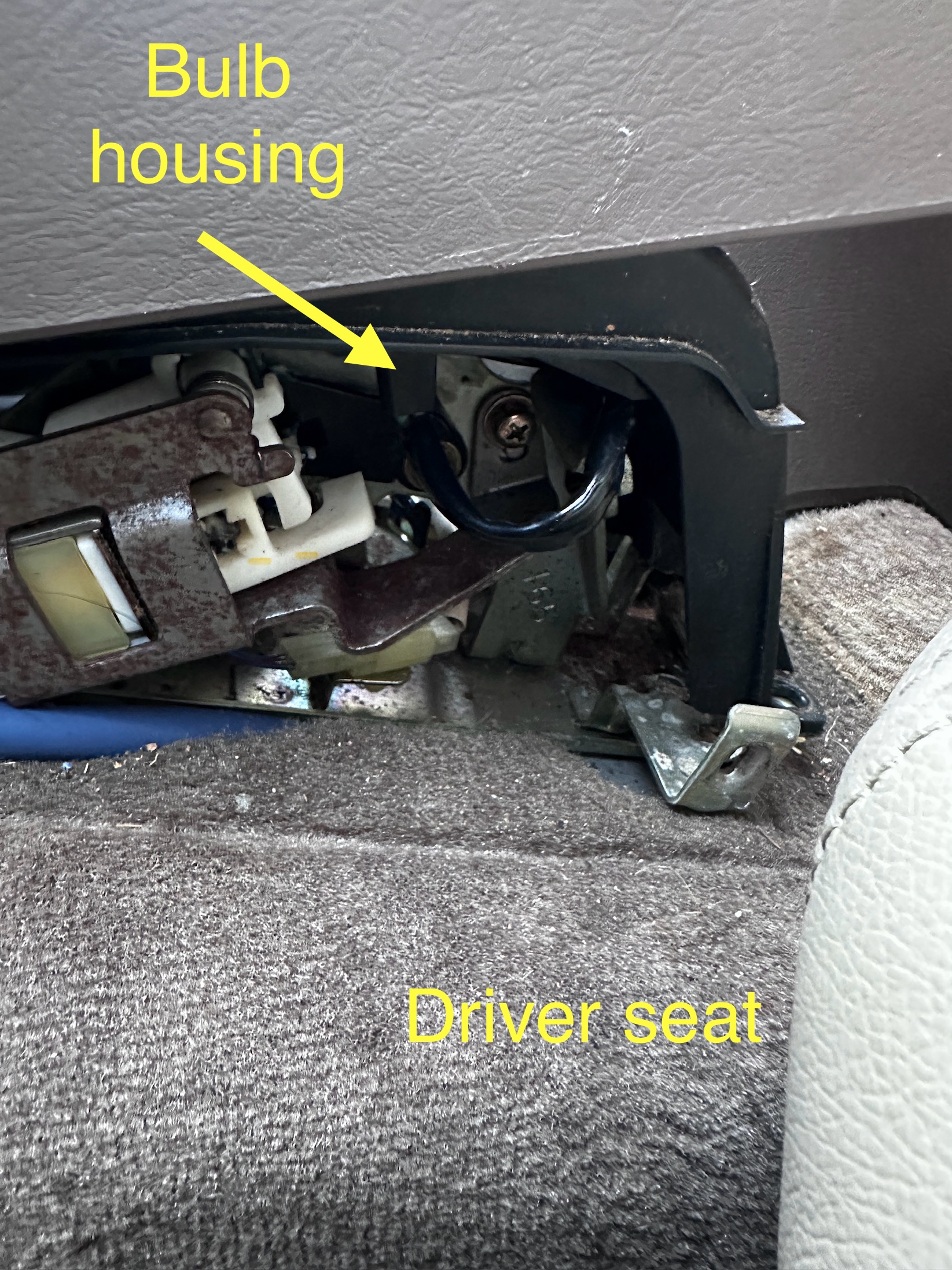

One of my pics from this thread shows the bulb

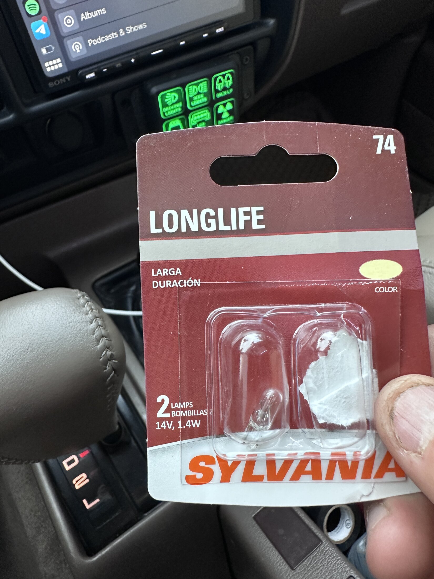

On my LHD, it is accessible from the drivers side once you lift the console. There is a black socket that twists to remove. I used this part number bulb: 90981-11018. That is a clear bulb, you may be able to transfer your green bulb cover over to it (or puchase it separately).
I used this bulb from O’Reilly. It fits, but if you wiggle it, it breaks the circuit and stops illuminating. Took some patience to get it to stay on once inserted. A replacement from Toyota would probably be better.
The condom didn’t make any discernible difference. I tried it on and off. I like it off a little better, the light is just a bit more even and bright.
Easiest way to replace:
(1) remove the four screws holding the trim to the shifter console.
(2) lift up on the rear part of the console, and look under the shifter. You’ll see a black cable. Follow it up under the shifter and twist the plastic housing counter clockwise to free the bulb housing.

FYI. I added a small amount of carbon based conductive grease to each of the wires and the connection is stable.
