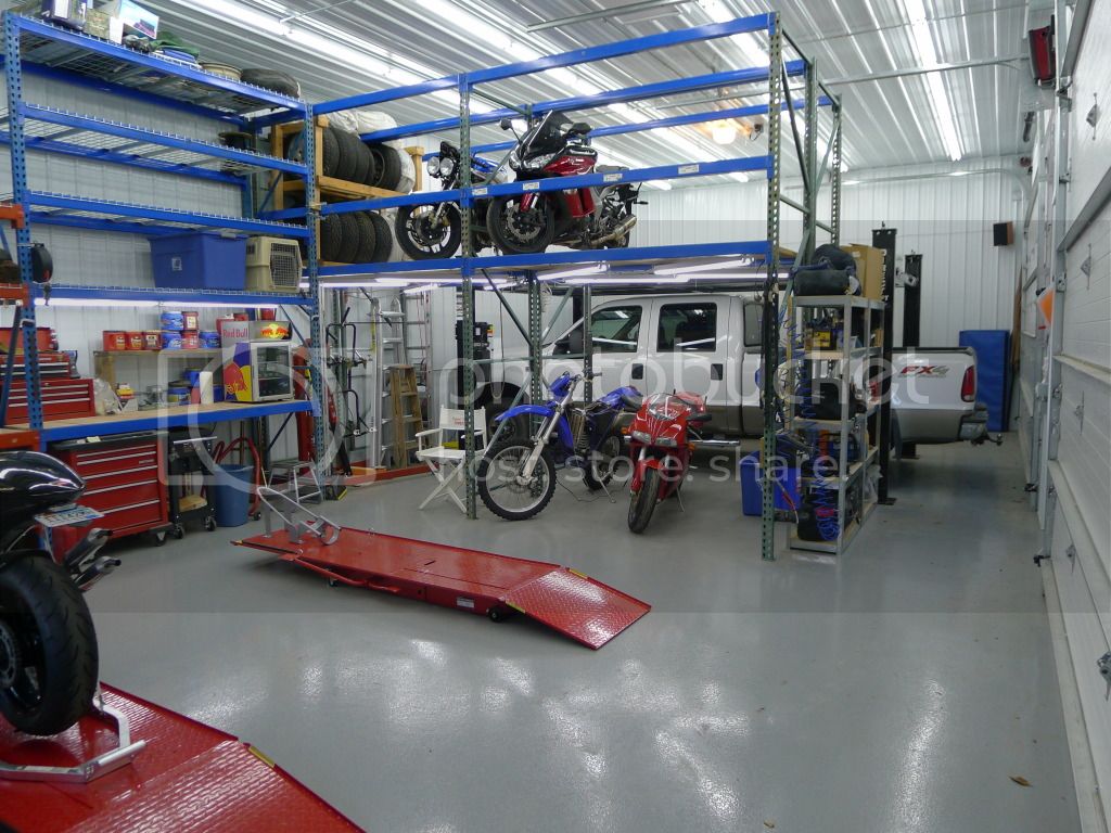

pallet racking. Works good. Bench down low, storage everywhere else. You wont have to worry about over loading it. And you can usually get it cheaper then buying shelves to fit the space.
@gahi, hello there. You hsve any pictures of said shelves. I am not picturing this.
Thanks.
these aren't mine, but same idea. Use one of the lower shelves as a bench. Then heavy duty storage everywhere else.
You can get much shorter ones then in the picture, or cut them down to the height you want.
I picked up some pallet shelving years ago when a place called Home Base was selling off everything in the store. Pallet shelving went last. I picked up the shorter 8' high shelves. Also looked and found the narrower runs that were only 8' long. Most the runs I have are heavier duty then those pictured. Because this was long ago the shelve material was 2"X6"s. If I had a taller ceiling and forklift I could stack engines on them. Probably not as cheap as a store liquidating everything off but in larger cities you can find surplus stores that buy stuff like this up and resell it.

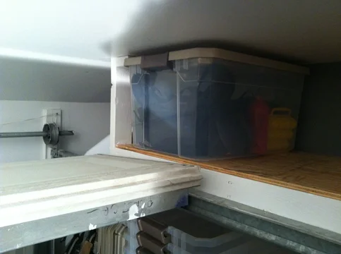

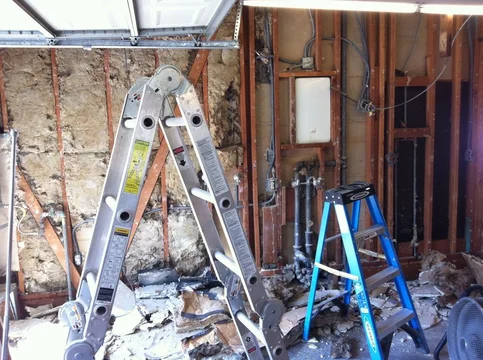

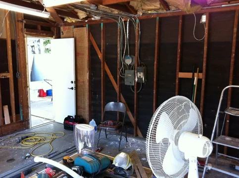

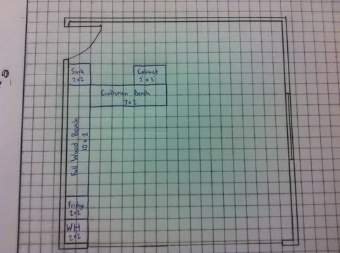

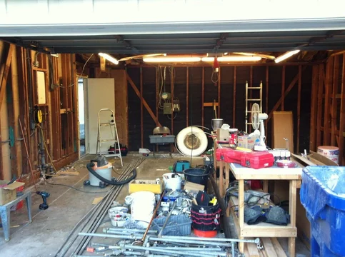

I did a very similar thing with my garage. Built the entire thing around the storage bin dimensions, and my wife's car dimensions :bang:. I went through alot of sketches/mockups before I tore into the walls. (Which was easy considering only one had drywall).
IMG_1575.webp IMG_1579.webpIMG_1608.webp That was the e-panel for the entire house (which I later upgraded to a 200amp)

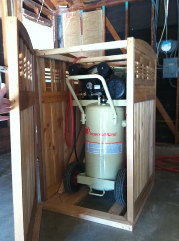

IMG_1611.webp IMG_1745.webp I built a Compressor shed (Hide its ugly ass, knock down noise, free up room inside the garage)
This is IR is pretty quiet... considering. Continue in next message...

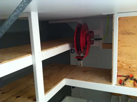

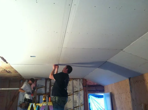

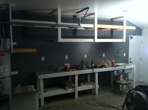

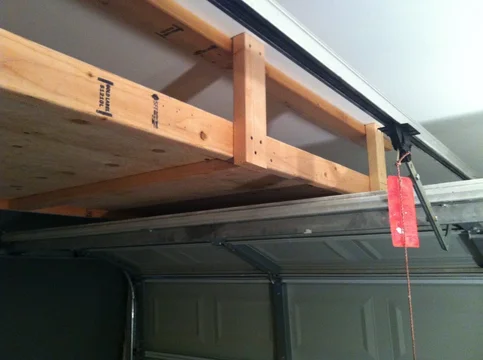

I wired 20amp receptacles EVERYWHERE. My father-in-law was laughing his ass off at me (Until he saw the garage a few weeks later and realized what I had anticipated. We re-enforced the ceiling heavily, and ran the compressed air line to where I was going to hang the Reel-Craft. Stuffed the old/original cast iron sink into place and continued building. No space was spared.
