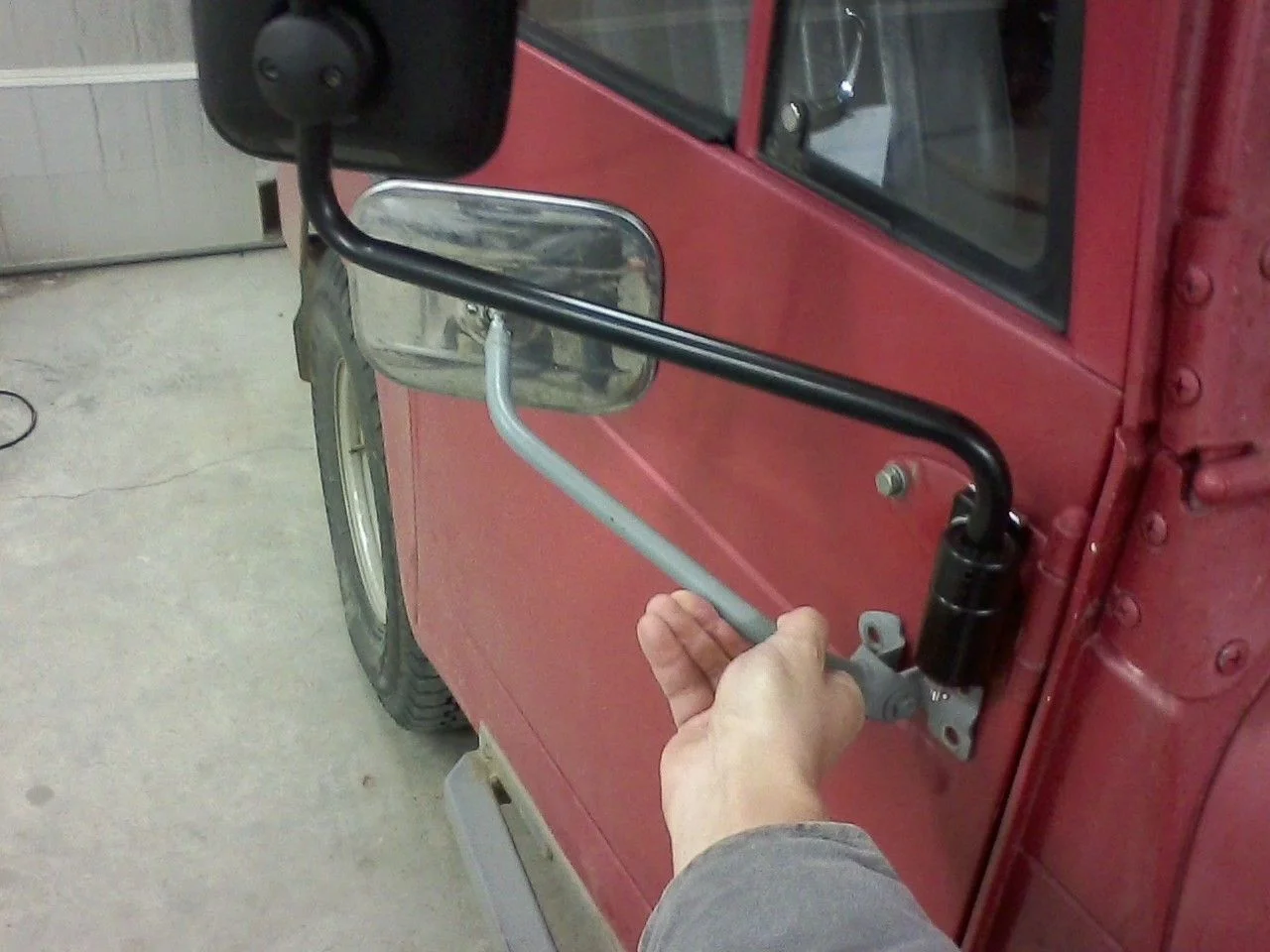

It’s personal preference, but I hate the convex mirror on my hard doors. Maybe my vision isn’t what it used to be, but it can’t see anything in those convex mirrors. I switched to rectangular flat mirrors. There is a light vibration, but without doors I just reach out and touch it if I need to see in more detail. My arms are homemade and I think they are much of the source of the vibration. I have been meaning to try a dampener in between the mounting points, but honestly it’s not that high on my list.

This isn’t an ideal picture but you can see how I have them mounted currently. I realize that these aren’t the original mirrors since my ‘69 would’ve had round mirrors. That’s why I also asked if my mirrors are just crap?View attachment 2332426

I think I actually tried that glue idea a few years back to no avail haha. I have the new mirrors coming this week so we’ll see how that goes.
Update: got the mirrors installed and wow what a difference! I got the 5 inch one because it looks like it’s a bit closer to the original mirrors rather than the 6 inch. I’m not huge on the convex but it does leave you with almost no blind spot. And no vibrations at all even up to about 45! Could see clear as day! Thanks @JohnnyC for the idea!

As for mirrors, I'm running some that have long arms on a rotating base that can swing in and out. They are sold for tractors. I like them, large convex heads, but they shake some due to the construction of the pivot point, convex makes up for it a bit. My factory arms with rectangular cheap auto store mirrors shook too. They are little large, but visibility is good, I can see everything behind me. Can swing them way out and look like a Dodge.
