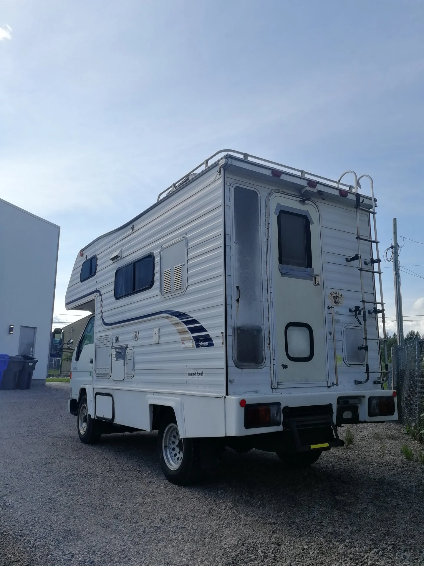

Thanks for the info! Unfortunately the front suspension doesn’t seem to share any parts with other Toyo models. Part #’s control arms, bushings, ball-joints, etc. don’t cross with anything. Would be a whole lot of custom work!
Ah well, keep it stock and do what you can. Reliability is the key anyways. That’s a cool rig. Where in the big city are you?
Agreed, reliability is key for sure. The upgraded torsion bars have helped, along with low profile bump stops, clearance is solid in the front. (About 10.5") And CV angles still aren't too aggressive. It's no rock crawler but goes almost anywhere with some careful navigation of extreme trails.
And thanks, really happy with the rig. Bought it on a bit of a whim and was very pleased with what a durable beast the truck has turned out to be. If one was really ambitious it could be turned into a real off road monster. The differentials are the same as many 4Runners so lots of options for lockers, etc. for both the front and rear. Add a modest turbo to the 3.0l diesel engine and there would be more power to push larger tires

It’s the Toyota 5L engine, it’s a 3 liter inline four. Same as some of the Hilux trucks use and the Land Cruiser Prado I believe.
It’s the successor to the 3L 2.8 liter engine that was much more widely used in the 90’s
I live about 45min west of Calgary.
