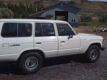

The old man wants to keep the splits. The old lady wants to go tubeless because they charge $40/wheel to change the split rim tires, which pays for more than half of the new rims anyway.
Advantages, Disadvantages, opinions on either option?

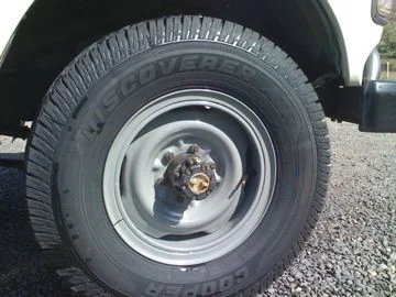

JohnnyC's link helped settle the issue. I took the split rims into the local powder coat guy (Who's name happens to be Johnny C). They did an excellent job for a good price. New rubber is on the way.
