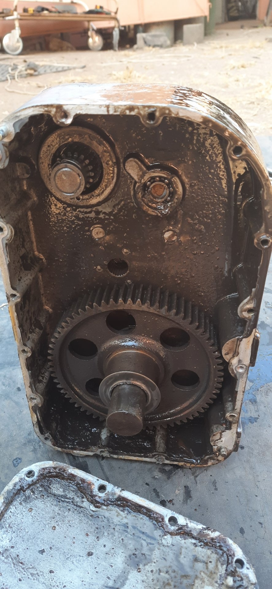

Hi all,
I found a similar thread to this topic, but seems as though its unanswered. I have also been stripping and servicing my 8200 and I am having a very difficult time separating the brake unit from the gear shaft in order to access and replace the severely worn bearing between the two. It seems extremely difficult to separate and I am worried about damaging component's. Please any help or advice on how to split them would be so appreciated!
Thank you in advance.

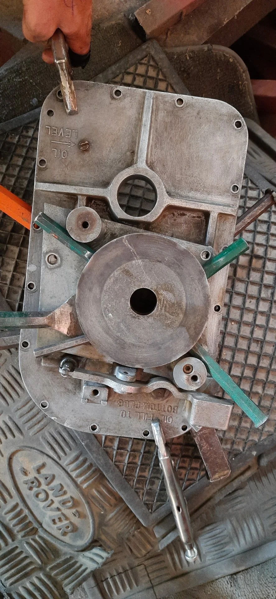

*please note * Picture is not the correct part I am referencing to, but cannot seem to remove it? Sorry for any confusion.

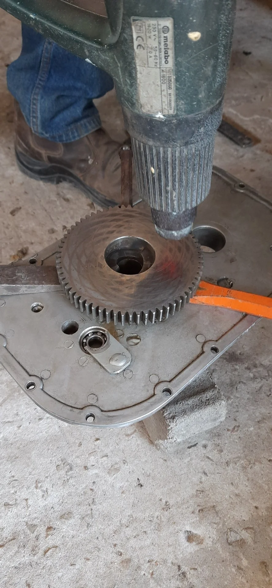

Thank you for responding. Been trying to heat and wedge it to split but to no avail! I do have a diagram thank you but not the best clarity. It definitely seems as though it should split but just don't know why so fixed?
I see the problem. Its that Land Rover floor mat. The winch is revolting and not cooperating because it thinks you are about to mount it on a Land Rover.

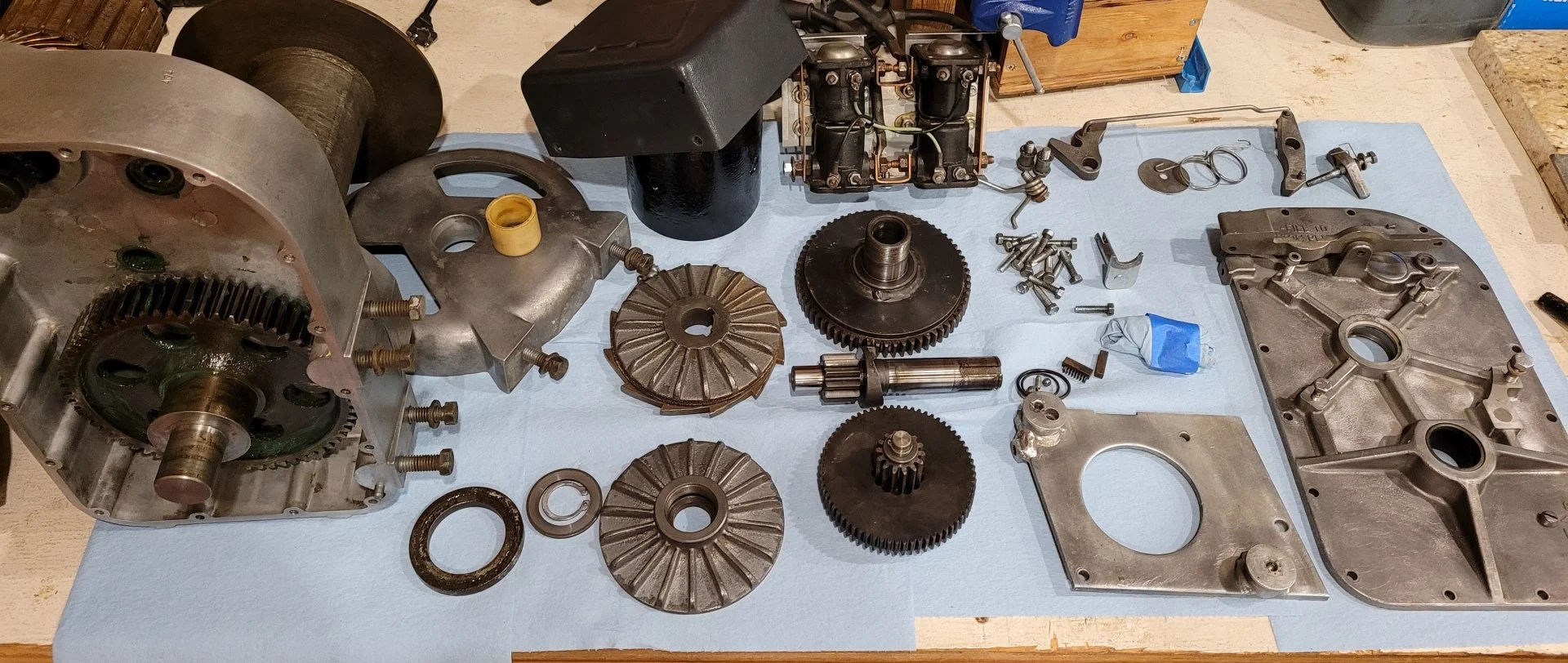

I was reading this thread as I am in the process of rebuilding/cleaning up a 8200 and had come across the same challenge.
Savutisky: I'm not sure if you already figured out how to separate the inner brake shoe from the gear shaft since the posts in June (or given up?), but it's not pressed on - it's threaded (left hand thread).
Mine took a little penetrating fluid and light tap with a appropriately placed punch/hammer to loosen (while holding the gear by hand), but otherwise wasn't too bad. Just be careful not to drop some of the needle bearings like I did when you take the shaft out...
It's all apart and cleaned up now and I'm planning to put everything back together in the next few days.
