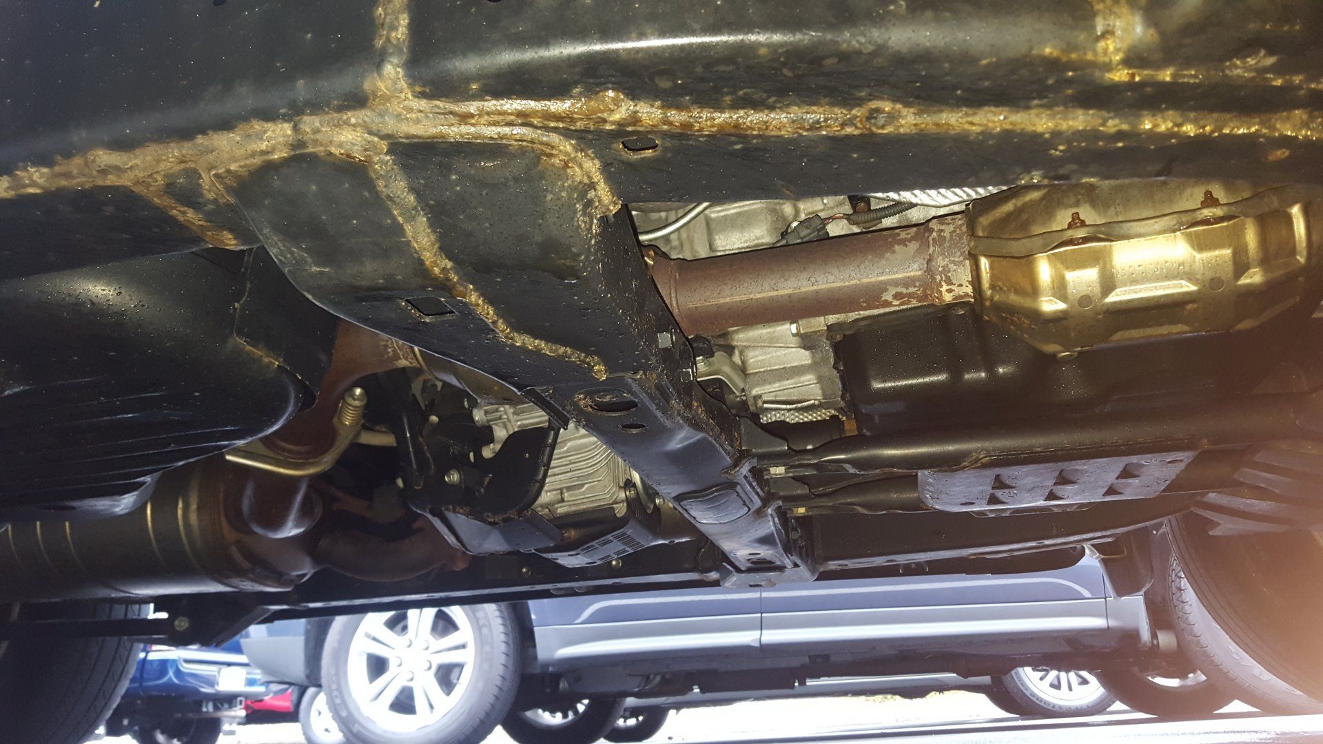

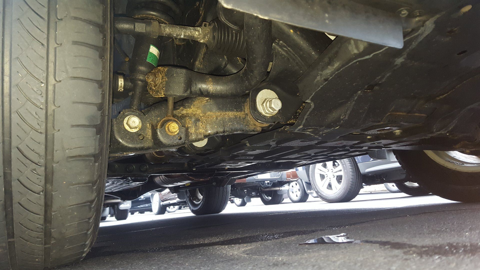

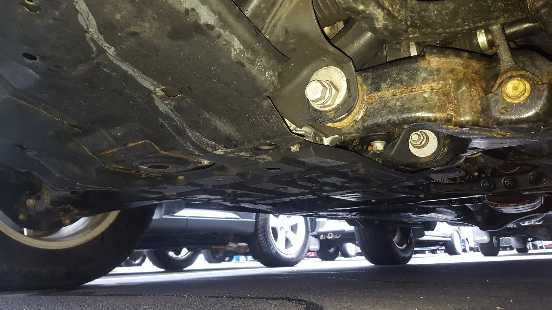

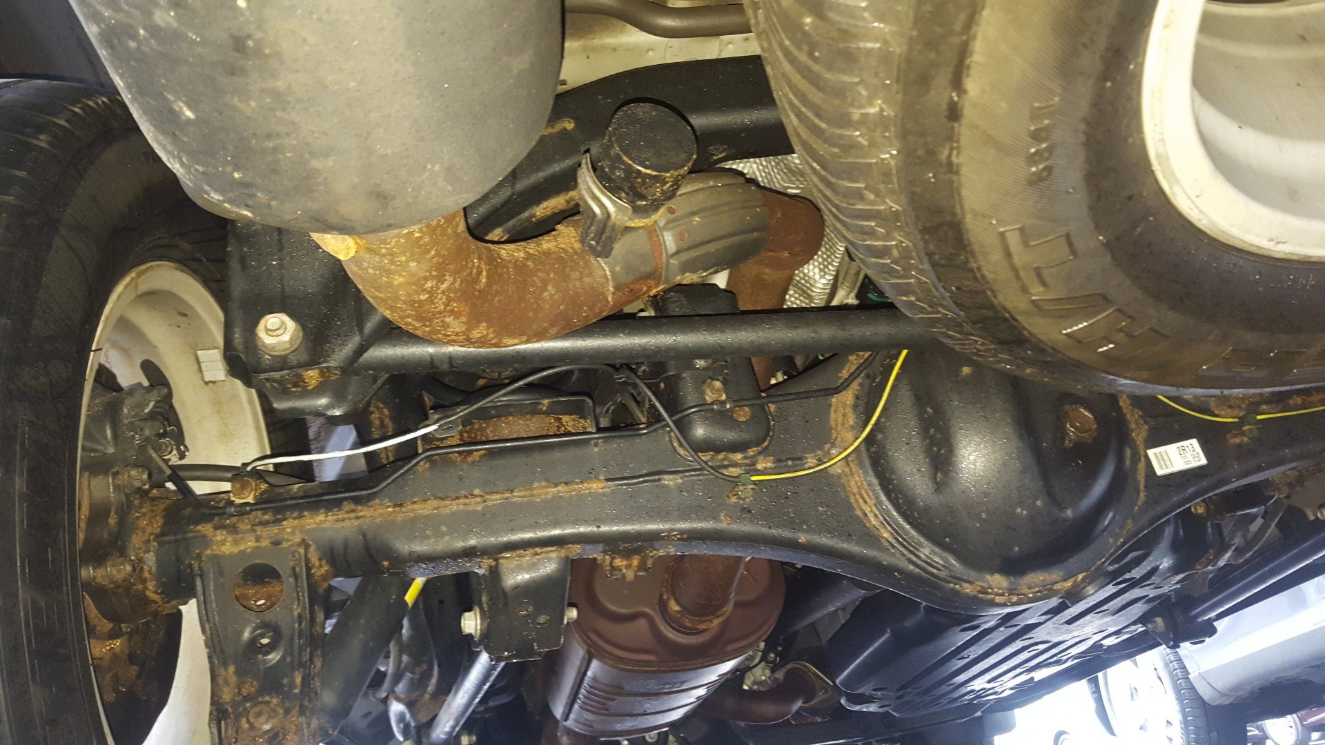

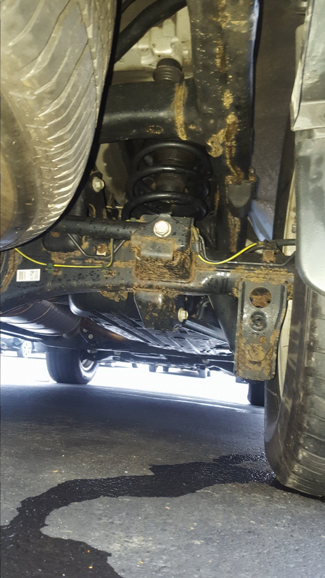

This is a 2013 in Ohio a buddy is considering buying. Any of this rust look serious? Seems like just surface rust to me but my rigs are all clean.
Knowlegable opinions appreciated
this is a
Looks to be in about the same shape as the 09 I bought a couple months ago. I thought it was pretty much all superficial as well. Only issue I've run into was the KDSS valves being a little tough to get moving.
I think it was $41K and had 85,000 miles. 2013 year. It wouldn't scare me off but I'd fly up and check it close. He just has photos the dealer sent trying to decide if it is worth flying up to Ohio from Texas to check it further. :))
Looks like surface rust to me. It should be addressed but the reality is that even if it wasn't treated it could probably be left alone for another 10 years and wouldn't become a problem as long as the vehicle is taken care of moving forward. It would get uglier but wouldn't mechanically or structurally become a problem. In my experience all Toyota vehicles will rust along weld lines if you live in a salt area and are not very diligent about keeping the undercarriage clean. It seems the paint Toyota uses does not adhere well along weld lines.
Thanks for the feedback guys. I felt the same. Minor rust from what I can see and wouldn't sway my decision unless I found something critical on inspection. Just wanted to run it by some other eyes in case I didn't see something and gave my friend bad advise. I told him to go check it out close.
What i see doesn't bother me at all.
Your buddy doesn't have to worry about the rust I see. The treatments others have suggested are a good idea. That superficial rust shouldn't affect the price in the Ohio regional market.
