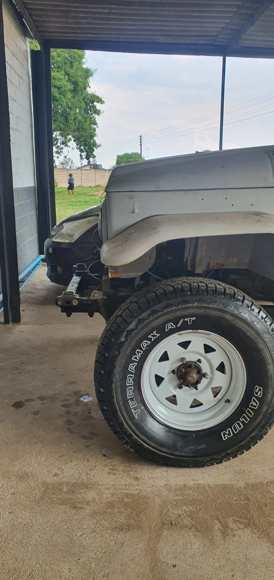

And now that he mentions it, I went to great pains to try and keep the tyres in the correct position in the front fenders on my build. I largely pulled it off but anyone who knows their stuff knows I missed the mark by about 1/2"
