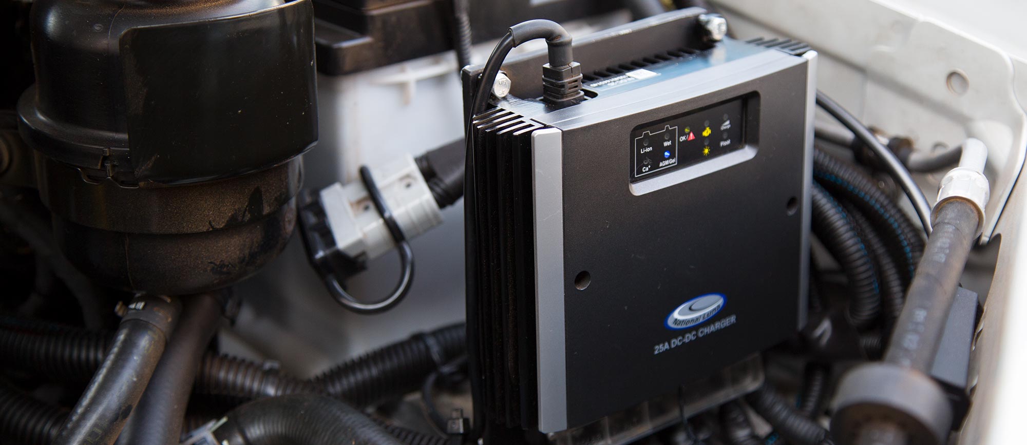

I used Slee primary and secondary trays, and Redarc BCDC, SBI, and in-line fuses. I hacked together a plate to mount the Redarc bcdc from scrap plate aluminum I had in the garage (note to self: one of these days I need to make or buy a brake for making small brackets like this). I made the wires to length with supplies from Amazon and a Harbor Freight hydraulic crimper (I may redo some of them later, because mild ocd).
Just Curious, is the BCDC rated for outside use? Everything I remember is it being called an in vehicle charger.
I'm not an expert, but nearly every one I have ever seen in a land cruiser was installed in the engine bay.
I would have liked to install it much closer to the auxiliary battery, but this location worked out better for me. I can always relocate it later if necessary. I'd just need to make a different bracket.
The BCDC will work fine under the hood. Best in the front of the engine bay rather than by the fire wall were it would get hotter. The only time I have had mine not work because of temperature was when it was to cold. It will not work below 14F. Once the engine was running for a bit it warmed up above 14 in there and it was happy again and started working. If you want to use the Manager30, it need to be in the cabin of the car where it is cooler.
