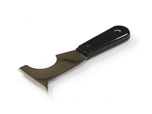

I like the painters 5 in 1 for not marring the surface when tapping something in between to surfaces.
Axle shafts are totally out. Housing still in vehicle. Using brass drift so not to mar. PITA so far and still in. Figured it might be beer thirty. Will try that Jmack thanks.
Yeah, that's what I do, just drive a pry in between third and housing. I've been using J Mack's scraper all week, painting the basement. works great on rollers.

Thanks for the advise. Floor jack did the trick, along with a paint scraper and PB Blaster.
