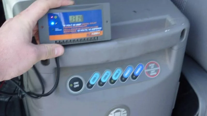

I sent the morning star back and got a Sunforce 10 amp controller instead.
I think that might not be ideal. It only has the lead from the PV and a lead to the battery. In this situation, can I run the leads that are for the battery to one of the fuses in the fuse block?
Also, any ideas on how to run the wire through the cab for the PV and the battery? The battery is currently in the bed (I don't want it gassing out hydrogen in an enclosed space). I was going to use a military style connector, but the spot I wanted to run the connector to (has a ding in the roof) is covered by the towers for the roof rack.
Here are some pics.

Curious why you didnt stay with a Morningstar controller?
FWIW I have several installed systems using the same Sunforce-60031 without any issues.
