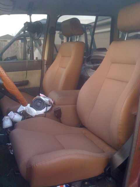

No problem. I put BMW seats in my 60. I am a big person, too. If you want to see the details do a search. :flipoff2:

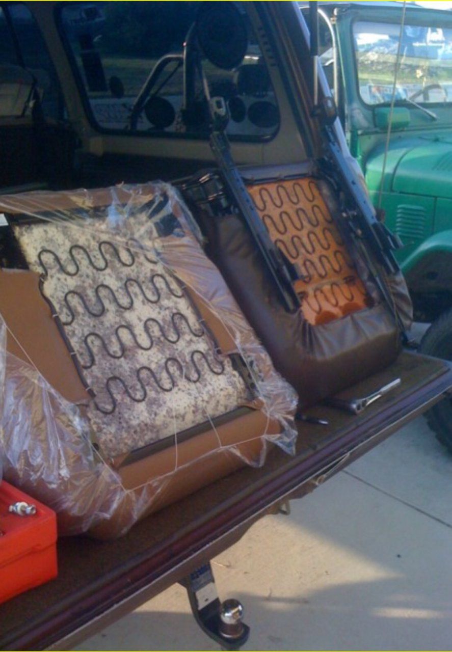

Seat bottom foam replacement from SOR. Pricey but excellent quality. An easy swap out.
Don't know of a thread. But you will need a good set of hog ring pliers and a box of rings. I had my seat edges replaced with vinyl done separately. If I had to do it again, I would take in the SOR foam and have an Upholstry shop do the fix on the seat cover and bottom at the same time. Not hard to replace the foam, just a little frustrating.
I think i posted this before but I used 1992 Lexus es300 heated/leather. VERY comfy with lumbar adjust. Love them. Not quite bolt in though...
You may need a bracket made,i tried lining up the bolts but not really close. project is on hold due to budget cuts. LOL
TorFab put in my seats a month ago. His bracket is a no brainer. Found seats on Ebay, E-46 seats from the 3 series I think around '03.
Tor warned against the "sport" seats as they have side bolsters and glad I went with the non sport species. I am 6'2" and stepping up into the Cruiser with the EMU lift would be more hassle with the bolsters. Total game changer for comfort and adjustability plus my long legs can stretch out more.
Sold my stock seats for $150 and bought the bimmer seats for $300 and were in excellent shape...Tor's brackets are around $150.I think.......... Great investment!
