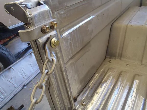

The 7/16" and metric bolts are really close. Don of FC Fabrications did the math when we needed a bolt to fit the chains on my 45 tailgate as the original holes were stripped. He tapped the bed with 7/16" fine and we used a spare set of Toyota seatbelt bolts which appeared to be the M11 1.25. No binding, galling or other issues whatsoever.
