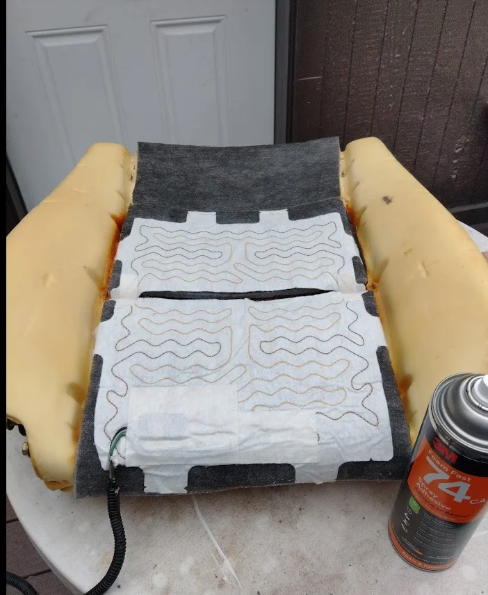

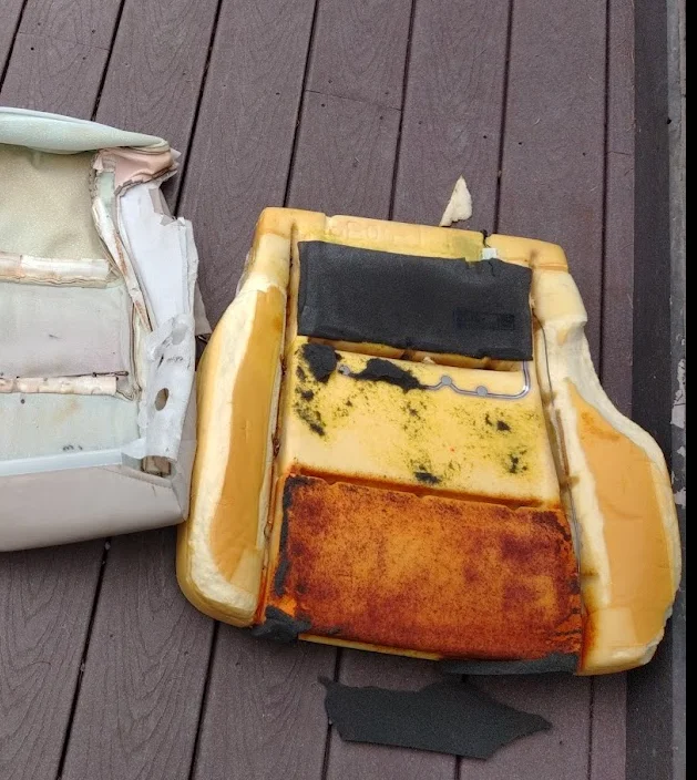

If you are going in far enough to replace the heater pad you will need to remove most of the upholstery. If it's in good shape just put it back but if you have a lot of wear try and save up some $$$ and replace it.
The seat heater wire tends to rub where it connects to the side bolsters. Either there or right in the middle were you sit is worn out / corroded / etc. I didn't have to replace mine but I did have to solder a very tiny little wire that I suspect I did a poor job on repairing.
I didn't get many pics. I think this is the seat back and the corroded looking thing is the seat bottom . Never knew foam could like , rust sort of. Not shown are the side parts of the bottom heater pad. The material is tougher than it looks but the connection points are frail.
