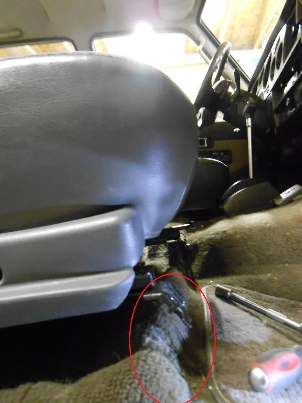

As others have noted, they're almost a bolt in, but the right front (and left front) feet are about 2" away from the Toyota seat mount nut. See photo. I will have to fabricate a foot extension for this anchor point.

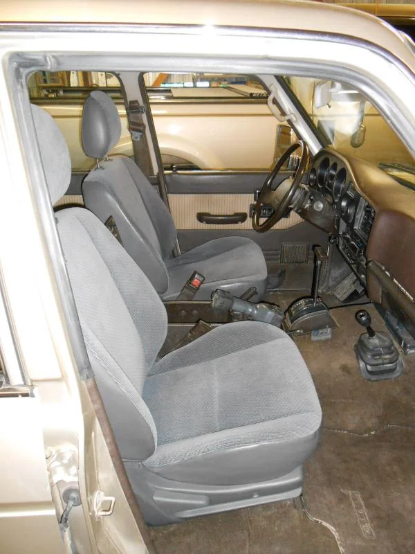

I went to Pick and Pull today and was happy to find a set of decent front seats for my FJ62. I discovered a 2000 Rodeo with a set of cloth non-power seats worth taking. After a few squirts of some PB Blaster, wrenched four bolts off, paid $60 out of pocket, my ass started to feel better. Actually I am hoping the whole left side of my body will regain feeling after I replace the OEM milk crate I am sitting on now.

To clarify, the outside seat rails or door side is where the anchor bolt foot runs about 2" short. As SteveH's first photo illustrates at the top of the thread.

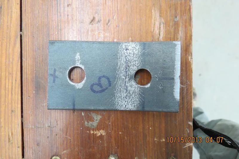

I built a few simple brackets to compensate for the disparity of the door side rails on the Izuzu Rodeo seats in my FJ62.

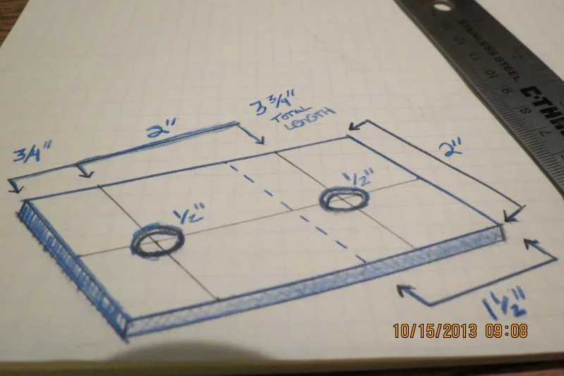

I sketched a rather crude concept based on a few precursory measurements. Hope you can read the layout alright. I chose to use a 2” wide ¼” thick piece of steel stock. The 2” width fit nicely inside the “foot” of the seat rail. The holes are centered in the middle or at 1” and are exactly 2” center point to center point. The hole that the top bolt fits through is ¾ of an inch from the edge of the bracket to its center point. So draw a center line down the middle of your piece and then another line ¾ “ from one edge across the width of the piece. Where those two lines meet is the center point of your top hole. Measure down 2” from the top holes’ center point and draw another line across the width of your piece. The new line cross marks the center point of the bottom hole. Take note that the holes are not centered lengthwise. At the top of the bracket the hole is closer to the edge and the hole at the bottom is further from the bottom edge. I drill the holes before I cut the piece to length as it was easier to clamp on my drill press. I drilled the holes with a ½” drill bit. Once I finished the holes I used my steel chop saw to trim the length to a hair under 3 ¾”.

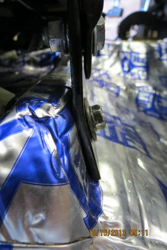

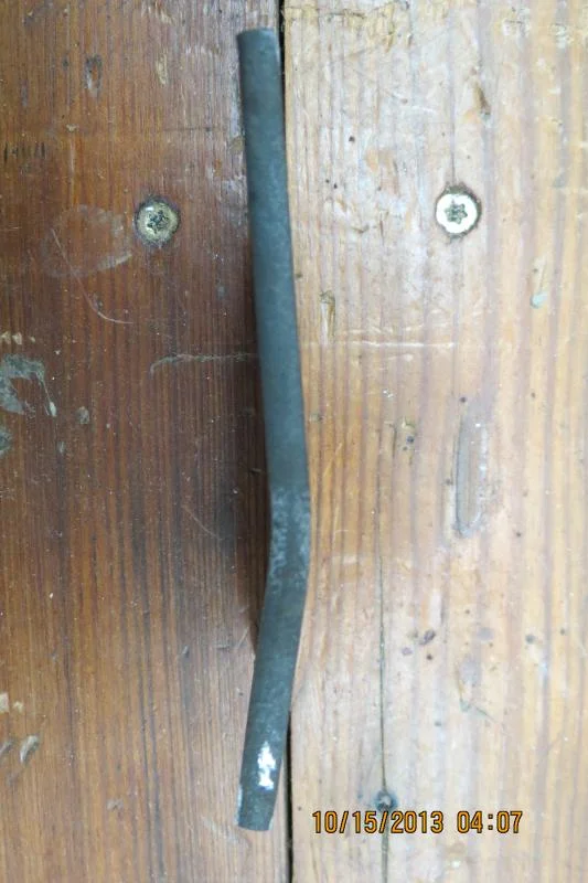

I found when I test fit a cardboard prototype I realized that a straight bracket would not work to secure the bolts evenly. The little ridge on the floor of the cruiser where the bottom bolt fits has a very slight angle to it. I figured that I needed to bend the bracket at 1 ½” from the bottom edge of the bracket to meet that angle. I drew a line at 1 ½” and set it in my vice on that line. I tapped, with moderate force, the piece with my sledge until I had met the angle. I have no idea of the actual amount of degrees but as you can see in the photo it is very slight. I basically just tapped a little at a time and checked it in the cruiser until it fit. My goal was to meet the angle at the bottom of the bracket and have the top portion be close to straight. Once I got the correct set up I bolted the bottom in first and then tapped the rail “foot” to meet the bracket flush.
I hope this description makes sense and is helpful. I sure had fun putting the new seats in! Many thanks to SteveH for his insight and in starting this thread.

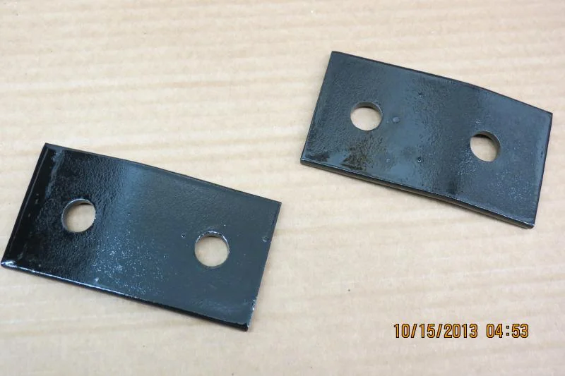

The dimensions of my finished bracket are:
2”w X 3 ¾ “L X ¼ “d
