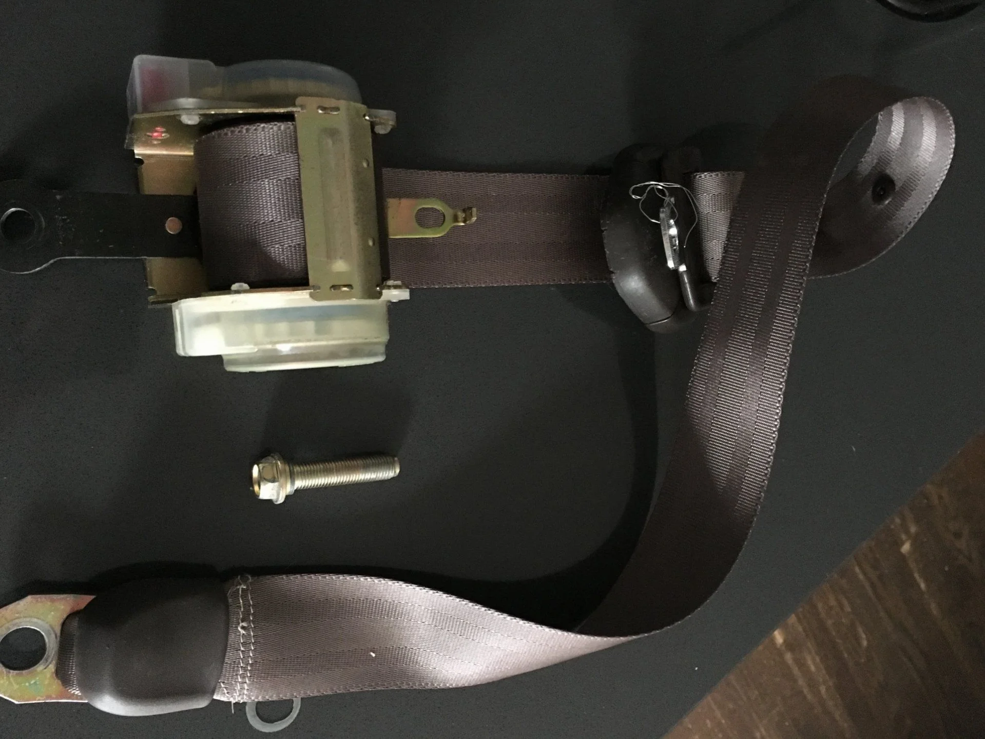

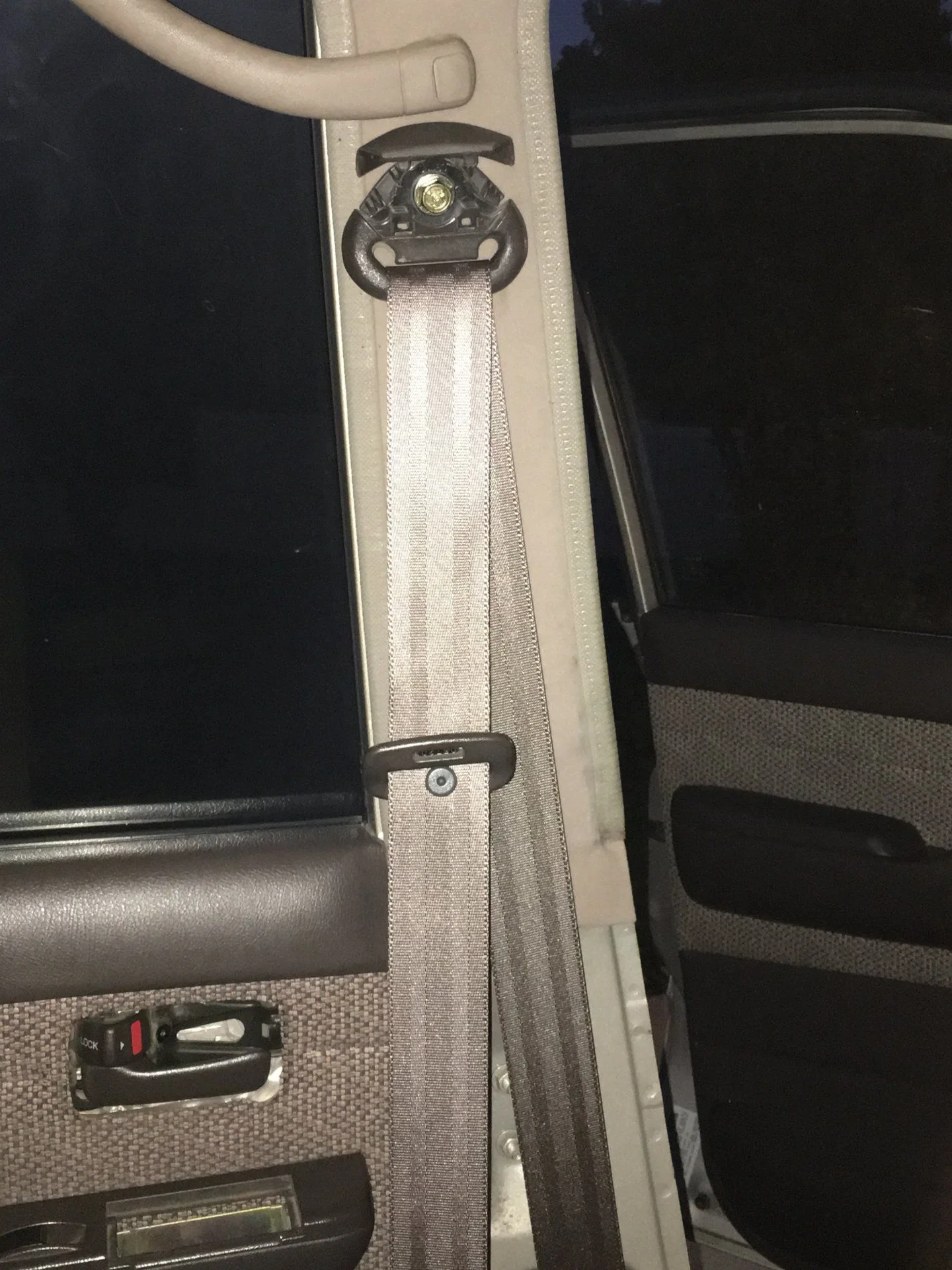

Bumping this up for my experience. I missed out on the move code, so mine were full price. Sent both front seatbelt in since they were getting frayed. If you do this, you'll need to figure in shipping to them into the cost as well, they cover the shipping back to you. It won't come back in the same box you sent it in if that matters to you. Turnaround time was great, got everything sent and back in one week (with a holiday). 100% satisfied with the passenger side, looks amazing. Installed the drivers side, less than pleased. I sent them an email to see what's up with it being backwards. I think once I get it flipped back around I'll be satisfied.
I think you'll be able to just turn the belt portion within the latch by hand. I'd at least try that first.
Yeah, I ended up getting impatient and messing with it this morning. I had to fold the belt and feed it through the buckle to get it to twist. Not the end of the world, but a minor annoyance.

You could just pull the belt, flip it and put it back together. My old thread on swapping the belts may be some help, pretty easy to do.

I don't think its reversed. I thought the same. What matters is the buckled location not the at rest position. I called them with the same complaint.
Buckle is up and see how it looks
Yeah, it was reversed. Flipped the buckle and installed everything this weekend. Even the little bump stop is on correct. Technician must have just been going too fast.
