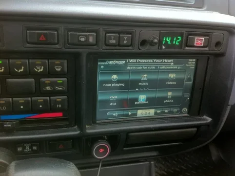

I have to thank WILLEM from the CENTRAFUSE forum for having a land cruiser and caring about the OEM implemtation:cheers: Given I do have more than the average amp draw but only 800ma (double the norm due to constant OBDII usage, usb OBDII reader draws 300ma constantly unless fuse is pulled) but I don't see that being an issue after just a a day or two with a battery having 1150CCA 205 RC (second battery is backup only, nothing else connected but the isolator).
When I charge both batteries overnight (equalizing them) the the in dash meter shows 13.4 before startup(just after removing the charger) but drops to 12.5 while starting. Only drive 2 miles to work and in dash voltmeter shows 14.2 while driving. When i get home and hook up the charger it reads 77% charged again, and takes 4-6 hours to top off 100%.
