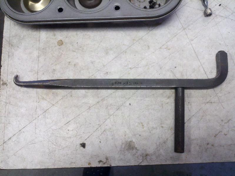

Although, if there's no shaft in the way, I actually really like my MAC S120.
attachment.php
